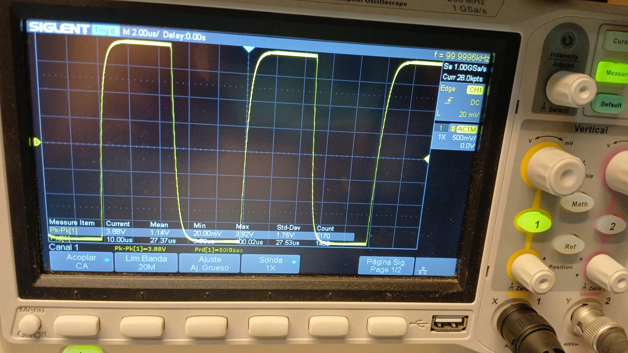

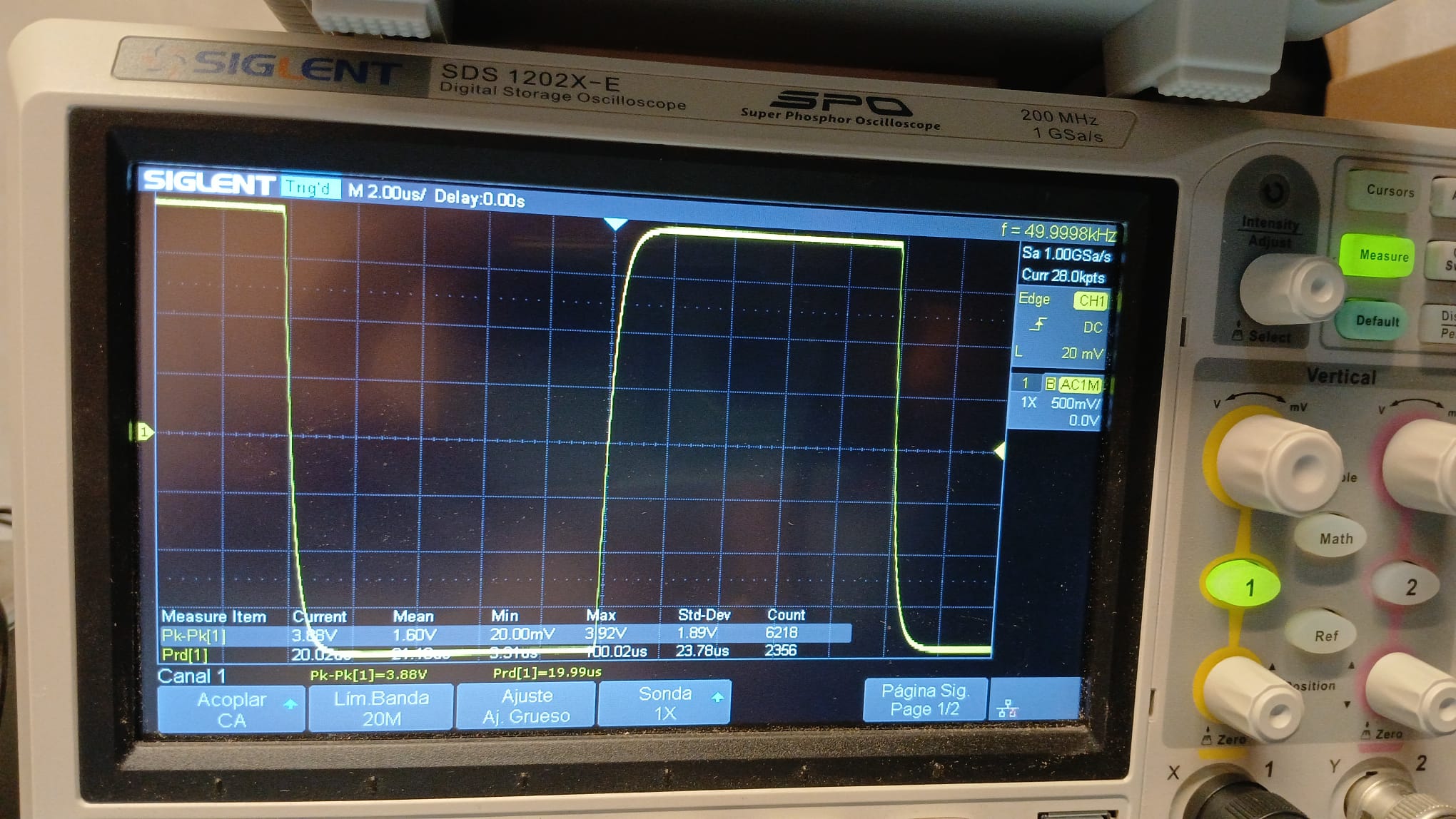

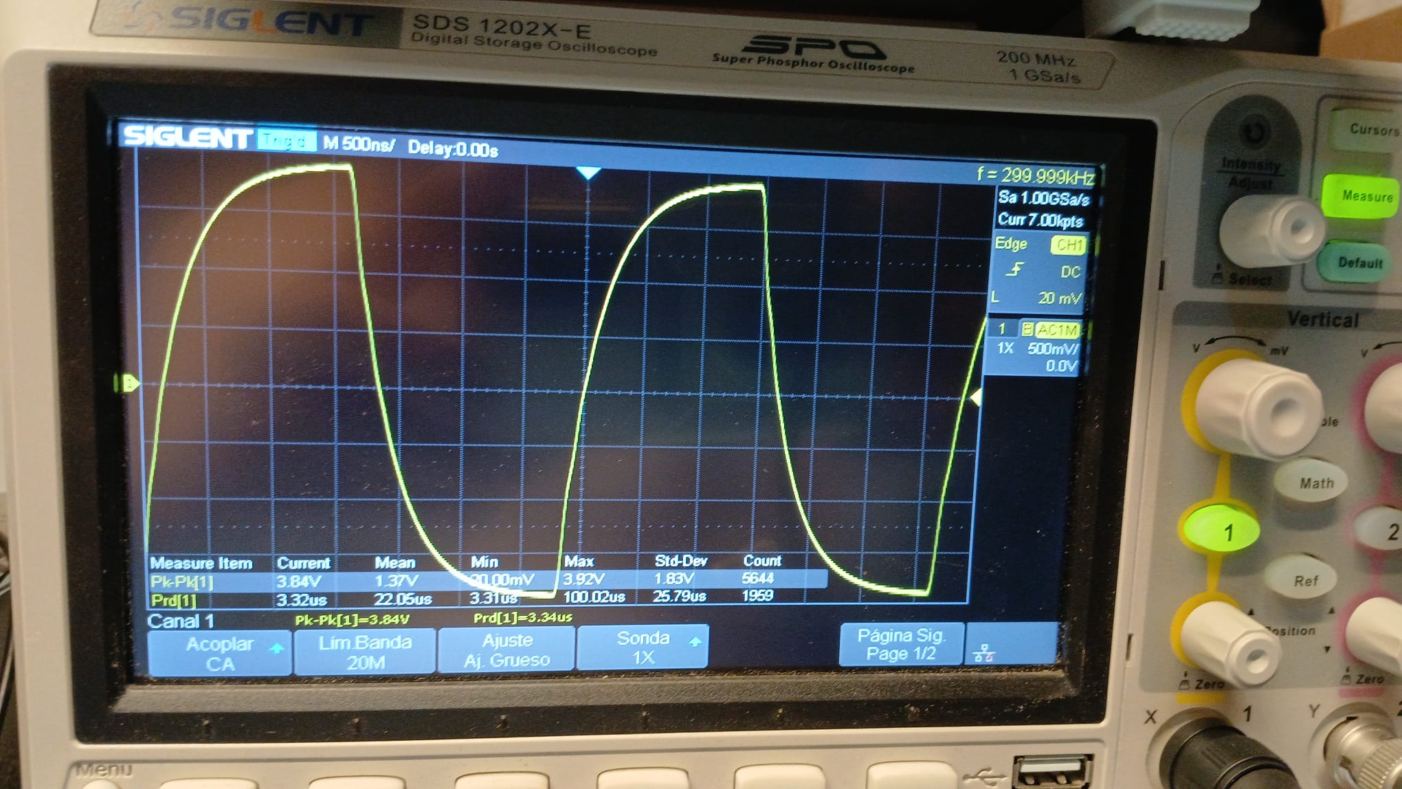

hello again I put another preamp that is pretty good, the price is something more than the C-3850, but it is still cheap, has good measures something offset 40mv, but once it is with signal there is no noise and much more open sound than the C-3850, I like it more I have tried with several OPA and there is little difference, so I put screenshots, greetings.
Muse 03 Yellow Op07 Pink 300khz
NE5534 vs OP07 300khz
NE5534 vs Muse 03 300khz
as you can see at 100khz there is almost no difference.
be careful with the first one, the one with the potentiometer has a lot of distortion, I'm going to give it to a friend.

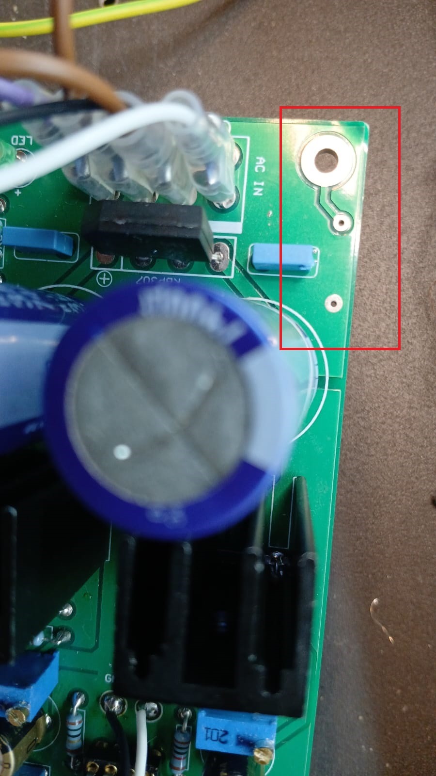

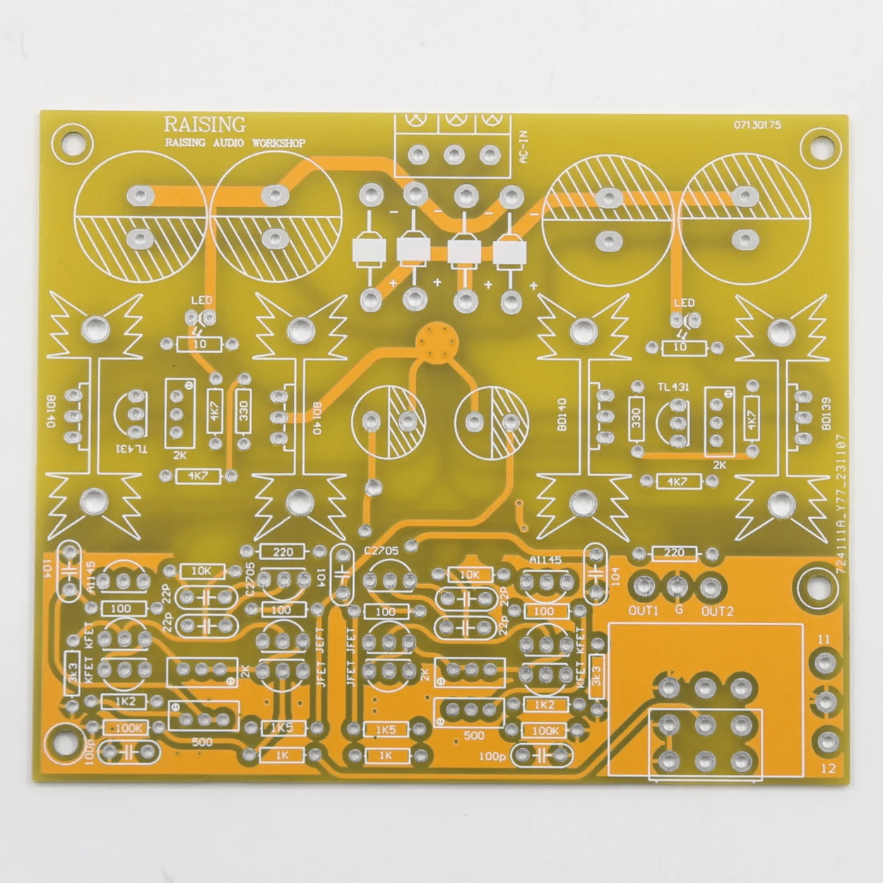

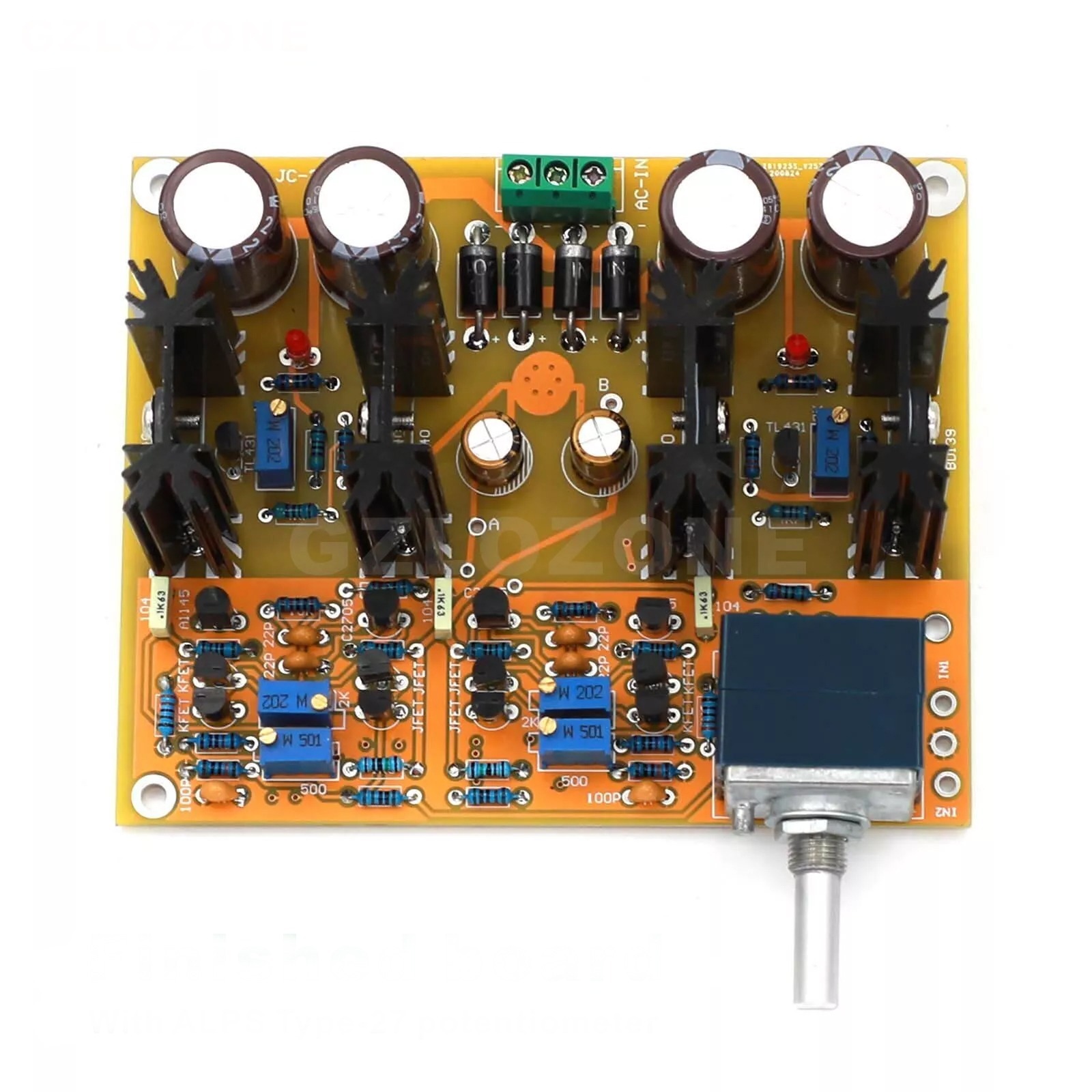

I have the same green preamp board bought at Aliexpress. Have you 2 transformers in use ? I tried with only one transformer and get some hum.
The other black board i own too. Its not only the pot, the components or the design give some white noise to the output.. Not much, but i can hear it with putting my ear near too my AMT. Another yellow board, JC2 Clone sounds good. It has a blue Alps pot on board.
See post 126 https://www.diyaudio.com/community/threads/clon-c-3850.416050/page-7
Greets
Peter
Reactions: huggygood
that is another pcb from an other company. At a first look, all seems similar, but you are right, the diodes seem to be not correct.
I will make a measurement on my board to check it out.
Greets
Peter

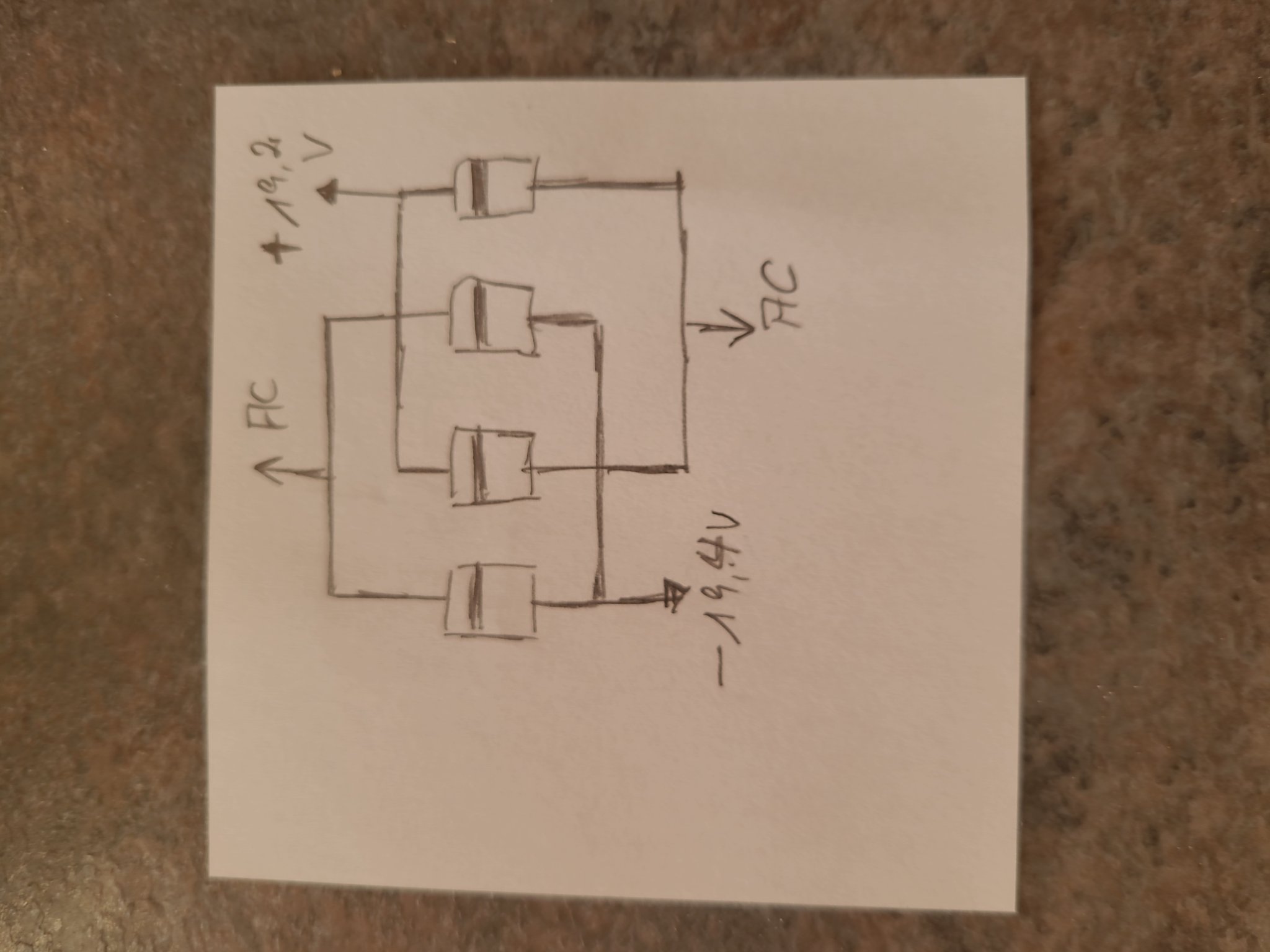

I have made a measurement to control the rail voltage...everything seems to be fine with the diodes...two cathodes connected together, two anodes connected.
With my 15-0-15 Volt transformer i get +19,2 Volts and -19,4 Volts.
Peter
