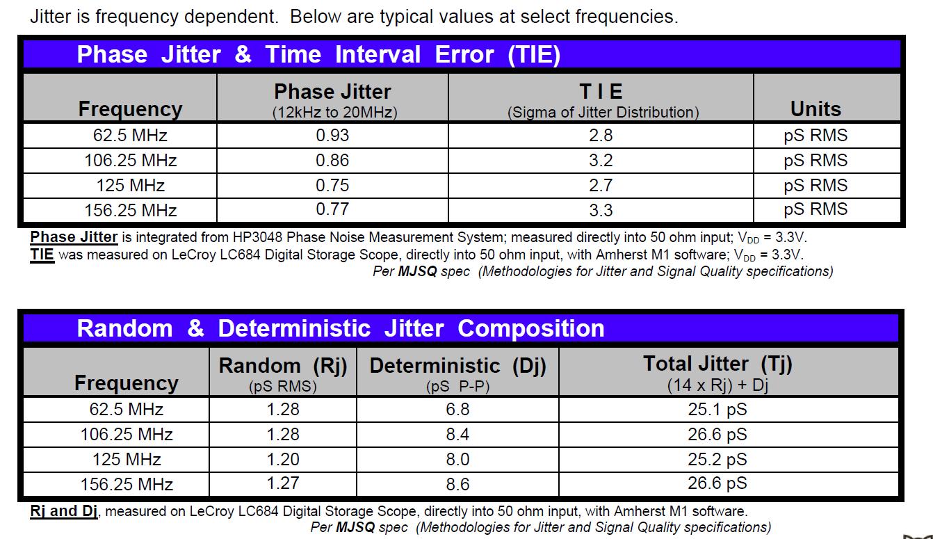

I just got a few Fox FXO-HC736R oscillators, that suposedly have jitter below 25pS, and I am curious to test them. Phase noise is available on their data sheet too.
25ps doesn't seem that special tbh... and datasheets... well... the Euroquartz xo91 claims "Phase Jitter RMS: <1ps typical" and yeah, it sounds good but not that good; note they don't give the bandwidth. It is a cheap smd part but you could say it is excellent value. The Crystek claim fs, not ps, rms jitter and over a wide bandwidth too.
http://www.euroquartz.co.uk/Portals/0/xo91.pdf
Did you see how the "others" calculate the jitter compared with the fox datasheet? Anybody can claim 1ps, but properly calculating and advertising the resulting jitter takes some level or proffesionalism.
Phase jitter of Foxcon is below 1ps RMS if you don't care about other "details".

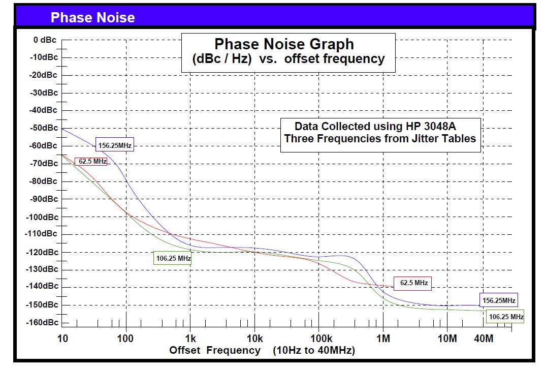

The digital
engineers I trust, who I have corresponded with, all agree that phase noise is the important specification for oscillator performance in audio. Especially phase noise at low frequencies (<=10 Hz). so comparing the phase noise plots should get the best information.
By this spec, the NDKs recommended by Bunpei, and the Crystek CCHD Series both look good.
Do not that phase noise varies somewhat by frequency as well, when comparing the phase noise plots published by Crystek.
And then there's power.... unless there's some major magic going on, dirty power is going to increase jitter.... and no company I have emailed will tell me the specs of their bench test supplies.
