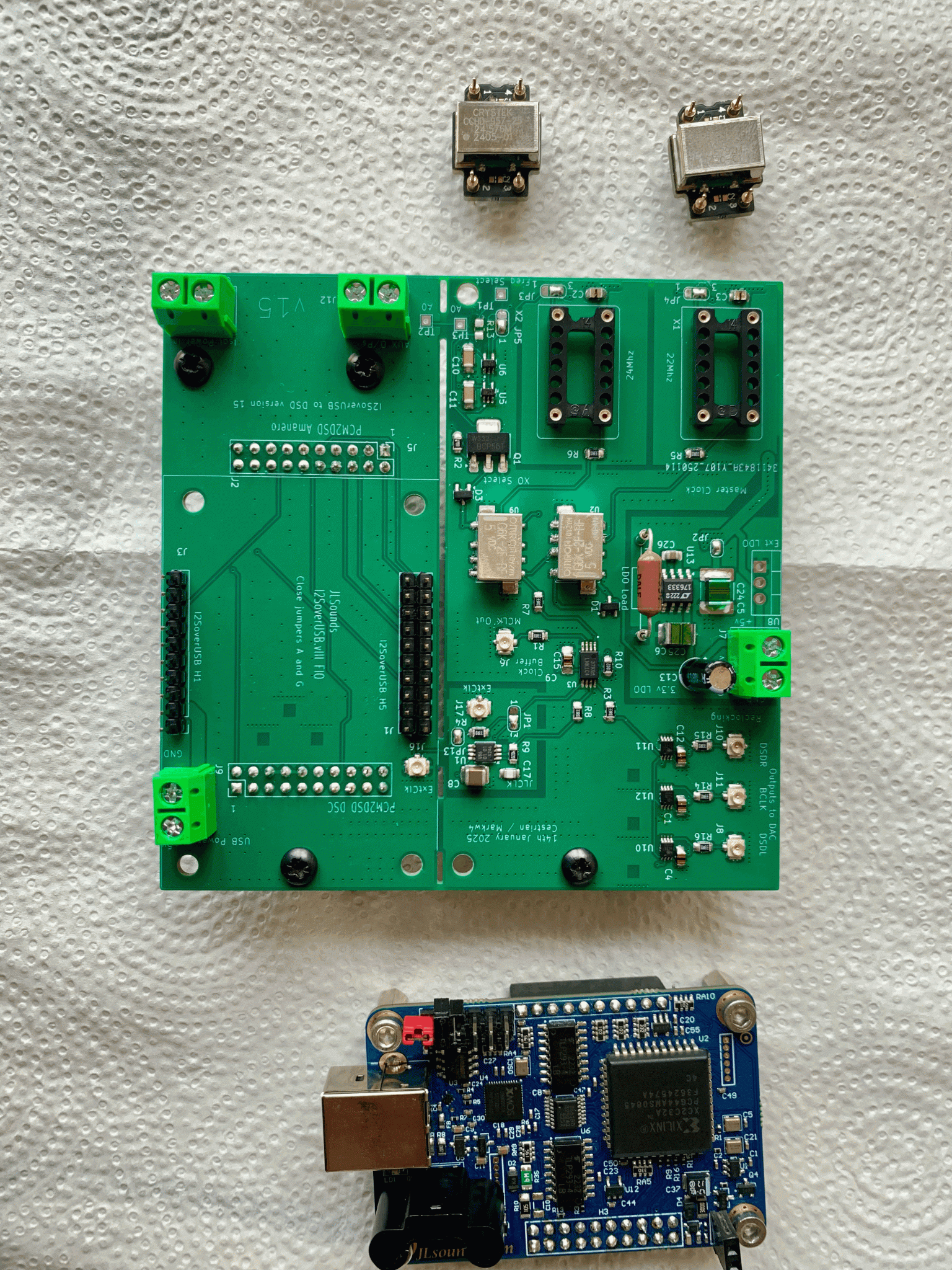

I can now provide the Gerbers and information to build an interface board that supports a compact connection between JLSounds I2SoverUSB vIII FIO and PCM2DSD with support circuitry hosting 2 x XOs, relays to switch in the correct frequency, re-clocking for the DSD signals and a clock doubler to provide ext_clk to the JLSounds if 22/24Mhz XOs are used.
The design relies heavily on that generously provided by Markw4 and was conceived not as an alternative to his design but to complement it where space was limited and requirements weren't as general.
This is the link to Mark's design: https://www.diyaudio.com/community/threads/general-purpose-dac-clock-board.413001/

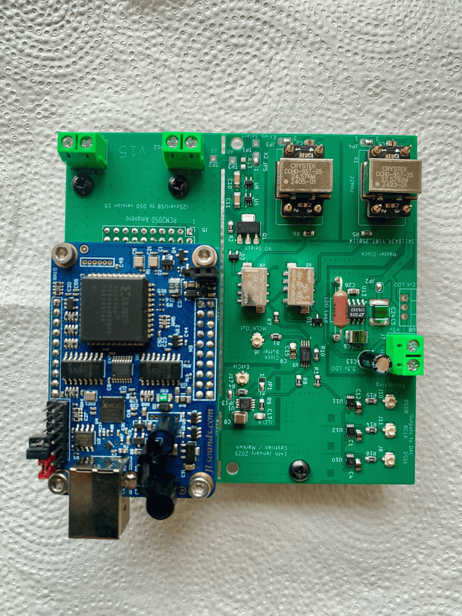

Below is the re-clocker fitted to one of my two RTZ DACs:
The BOM & Schematic is also attached together with a document with some notes and details of the options.
Please let me know if clarification is required on anything. Or if anyone finds errors in the BOM. I've tried to keep it in step but as you can see there have been a number of iterations so mistakes might creep in.
The v15 board has been tested on 3 RTZ DACs and found to be working well on a number of different sample rates and sources. However, I cannot guarantee that there won't be unforeseen cases where timing issues might arise as I can only test with my limited scope of hardware.
BOM calls for Crystek CCHD-957 devices but since the 4 pin Aries XO sockets are used (part number has been added to the BOM) then any pin compatible XO can be used,, such as the Ian Canada scPure. The Crystek XOs also require a conversion pcb, as seen in my photo above. I bought mine from Ian Canada. The scPure XOs already use the correct format for the sockets.
For DIY use only!

A quick update and an apology.
I have found that the RC time-constant for the XOR based clock doubler is incorrect with the value for R9 that I have specified in the BOM. (402R)
The problem did not show itself when using Crystek XOs but when I swapped to the Ian Canada scPure the doubler failed to switch correctly.
I have now recalculated and changed the value of R9 to 100R. This now works perfectly with both Crystek and the scPure and the output waveform looks more symmetrical too.
I will update the BOM.
Sorry for any inconvenience caused.

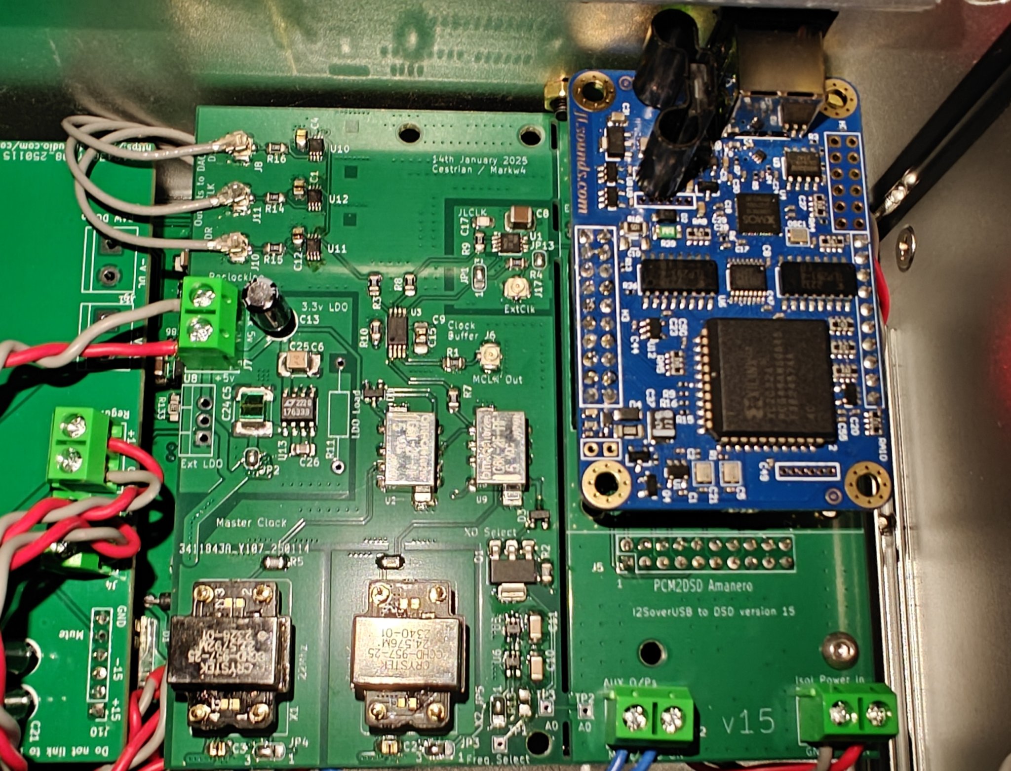

Now I have one up and running too:
Sounds good. I would say its about the same as when I tried the scPure clocks using my clock board from the other thread. Pretty holographic. I would say probably the 2nd most holographic dac we have heard here. (The most holographic was the same RTZ FIRDAC dac except using Acko clocks in combination with my squaring board.)
Anyway, so far as I'm concerned this board is good to go. One might even say its an essential piece of support circuitry for @MarcelvdG RTZ dac, in that it sure beats a simple Amanero and PCM2DSD setup without reclocking, galvanic isolation, external clocks, etc. Quite a big difference there.

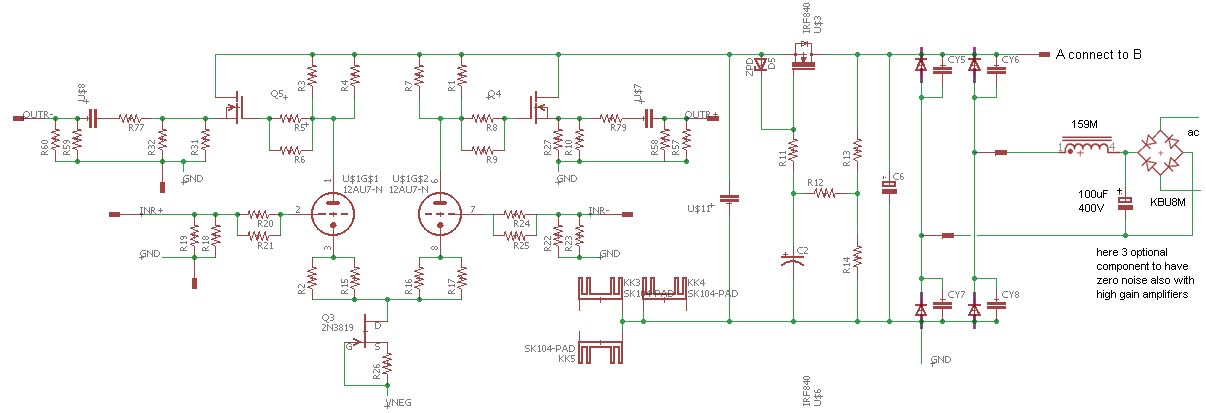

I am thinking about this one from audiodesignguide after 3rd order Butterworth filter,The most important thing for me is to get rid of the opamps, replacing them with tubes
https://www.audiodesignguide.com/DAC_Output/index2.html
