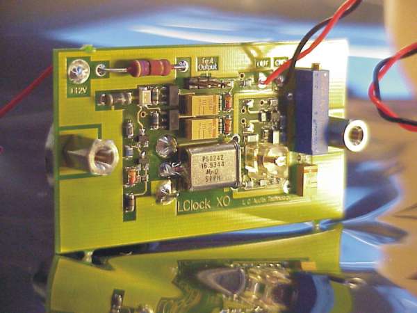

In the mean time for me the royal way is the removing of the MCK devices and retrofit a separate clock devices like that one from the attachement.
But nevertheless - what was the basic idea of the developer, as he designed this oscillator (go to post # 1 attachement) and how he has adjust VR1 - that would of interest for me.

Almost certainly the potentiometer is only used to set the output duty cycle. If the adjustment leaves it too narrow then some downstream circuitry might have a problem using the clock.
Nothing after the collector of Q2 (first drawing) is going to have any important effect on frequency. The waveshape is not important there.
The input threshold voltages for CMOS jumps around a bit from part to lot (see datasheets) but should not move terribly across the usual temprature range. Not enough to ruin a good duty cycle adjustment.. Check at the square wave hot and cold to see.

Two of us have already said that you should adjust VR1 so that the output wave from the 74HC04 has a 50% duty cycle. Why are you still asking the answer to this?
Most discrete crystal oscillators will have some sort of adjustment like this between itself and the wave shaping stage that follows it. There is nothing really unusual about this design. The ones you have linked to (apart from the LC Audio) aren't discrete crystal oscillators. Look harder and you will find more.
