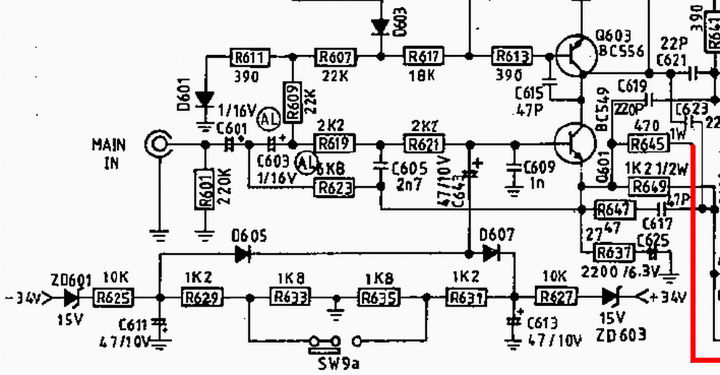

I have tried by several minutes and i could not understand the circuit.... say... the operation....it receives the feedback by the red line you see at down rigth side...and them,we have the series of diodes in conduction to the down left side....how this works?

The reason of this question, more then curiosity, is based into several criticism i use to read and listen about this circuit...people say they kill sonics, but no one was able to explain why?.... how kill sonics?... compressing?... cutting peaks?.... limiting?... acting as an AGC?...well...how it works.
NAD 3220, and some clones, and you can see a small part of the schematic i will post down here, are considered excelent sound reproducing jigs, considering the low price when first sold.... thousands folks use them as reference...the price jumped very high those last years in my place... and cannot find them paying less than 1000 dollares in my country... and... if you manage to find someone really stupid that wants to sell it....as those units are famous, something considered very good around the world.
I could never listen the unit...but will build it entirelly by the NAD schematic to evaluate by myself, not needing anymore to believe into Magazine Reviews...but, in advance, would be happy to understand how this circuit operates, and why everybody use to tell us to keep this "ACC" switch off.
Thank you in advance by the kindness to explain how the circuit operates... step by step please... a description please.
The image may be from a Proton 520...but i am not absolutelly sure, because do not know exactly if we can post commercial schematics here... so... i am informing, in advance, beeing carefull, i have found this schematic part somewhere in the web.

The red line is feedback - it has no direct effect on the input limiter function.
When the switch is off the input voltage is divided by
R621 over R629+R633 (negative input signal) or
R621 over R631+635 (positive input voltage).
That is - when the input signal level is over the diodes treshold voltage. ( It does not say what type but I guess silicium)
When the switch is on the input voltage is divided by
R621 over R629(negative input signal) or
R621 over R631(positive input voltage)
....when the input signal level is over the diodes treshold voltage.
So if the switch is in 'on', input voltage peaks over 0.65 V is divided harder, making it a limiter.
I think NAD puts the diode limiter in the feedback network.

It’s all about controlling the DC voltage potential at the diodes anode or cathode (depending on polarity). After Zeners the voltage from the 34V supply has dropped to about 19V. Then there is a voltage divider formed by the 10K, 1K2 and 1K8 resistors in series. (There's a circuit for both halfwaves of the signal). When switch is open the resistive divider sets a voltage potential of about 4.3V to the node that interconnects 10K and 1K2 resistors. The signal clips when it exceeds this voltage and the forward voltage of the diode. The capacitor acts as a shunt for AC signals. When the switch is closed the opposite DC voltages cancel each other and form a virtual ground at the node where 1K2 and 1K8 resistors interconnect. This affects the voltage divider and the voltage potential at the node that interconnects 10K and 1K2 resistors now becomes only about 2 volts. This means that the signal voltage required for clipping becomes lower.
Excelent description Doctor Temuk.... another master
This have clarified once more the basic operation of this circuit...and confirm last informations including more details.
