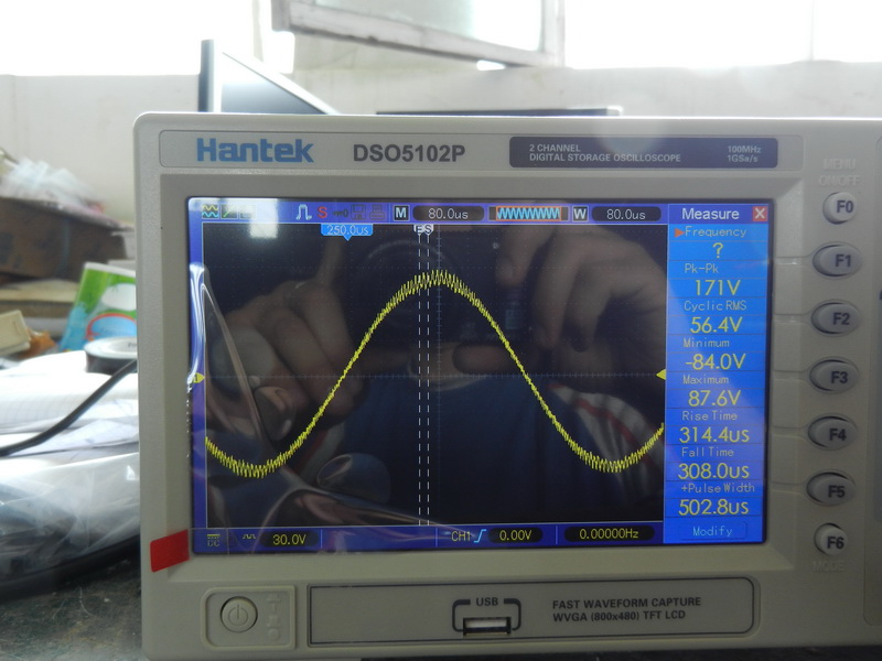

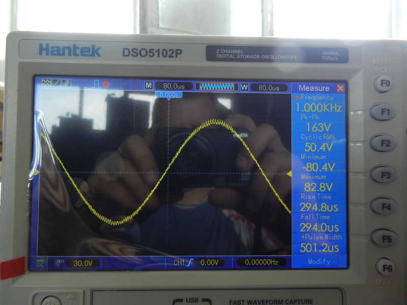

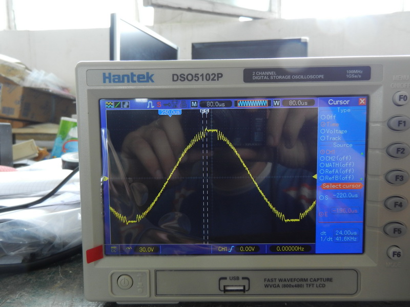

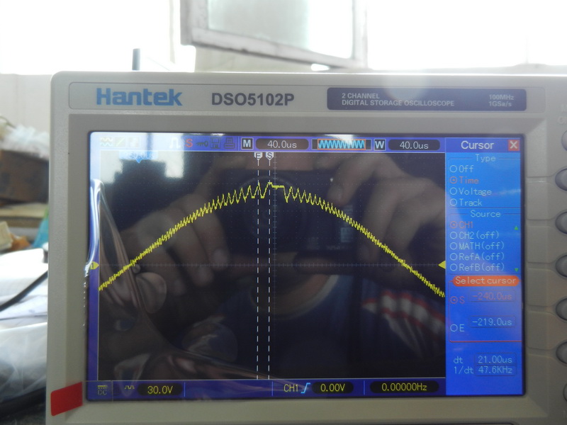

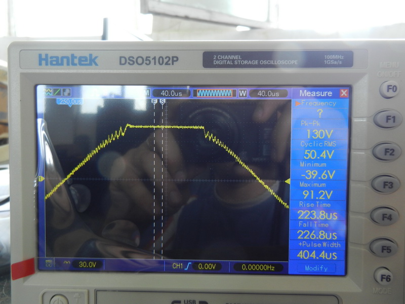

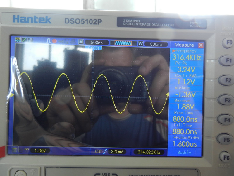

Posted in as few oscillograms which show the behavior of a prototype ucd style near clipping:

A few things about the tested amplifier: lm319+74hc02 (deadtime)+ir2110+irfb4332, 4r dummy load, 1khz input, 314khz at idle, ucd style feedback with 2 passive poles.
Waiting for your comments and suggestions.

Your scope waveforms are looking rather typical to me, not poorly wrong.
Worth to listen to the clipping and judge by your ears if it is Ok for you.
Besides the tizz, which I agree is linked to the switching frequency traversing the audible range, some desings suffer from short interuptions in operation (duration can range from few hundrets of micro seconds to mulitple ms) which sounds - say.. tackering.
The nice second picture in your posting is not from UcD,
but a phase shift controlled oscilator with pre filter feedback.
