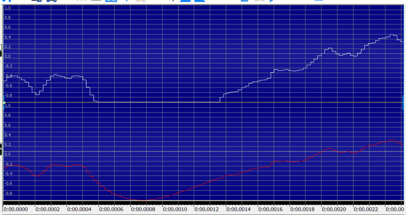

Yes but when you clip it, you don't get 1/2 the voltage, you get 100% of the voltage for the duration of the clip.
If I measure the current flowing thru an amp it's easy to tell when the amp is clipping without even hearing it. Current flow (and thus power) will jump up drastically at the onset of clipping.
Here is part of the reason why. This is not the output of a power amp, but the digital recording of the 1812 Overture with the DSO. The extreme closeup is one of the cannon shots that is clipped. On the left channel (white) you see the original recording as ripped from CD. On the right (red) you see the same signal de-clipped. See how much longer the clipped signal spends at 100%? It's significant and will mean much more power going thru the circuit.
As to whether or not a few cannon blast peaks will kill a speaker or not, I can't say. I doubt that a few quick booms would burn up a voice coil. If the cannon peaks damage speakers, it's more likely an over excursion problem. Of course the amps might well be clipping even if the source isn't, but it shouldn't be clipping long enough to hurt on this recording.

... and if you look at the rest of the waveform, you'll note that the rest of the signals have been reduced by a factor of two, or 6dB.
ie, if we maintained the original average signal level, the unclipped waveform would peak +6dB over the clipped section.
... Which means more power delivered.
