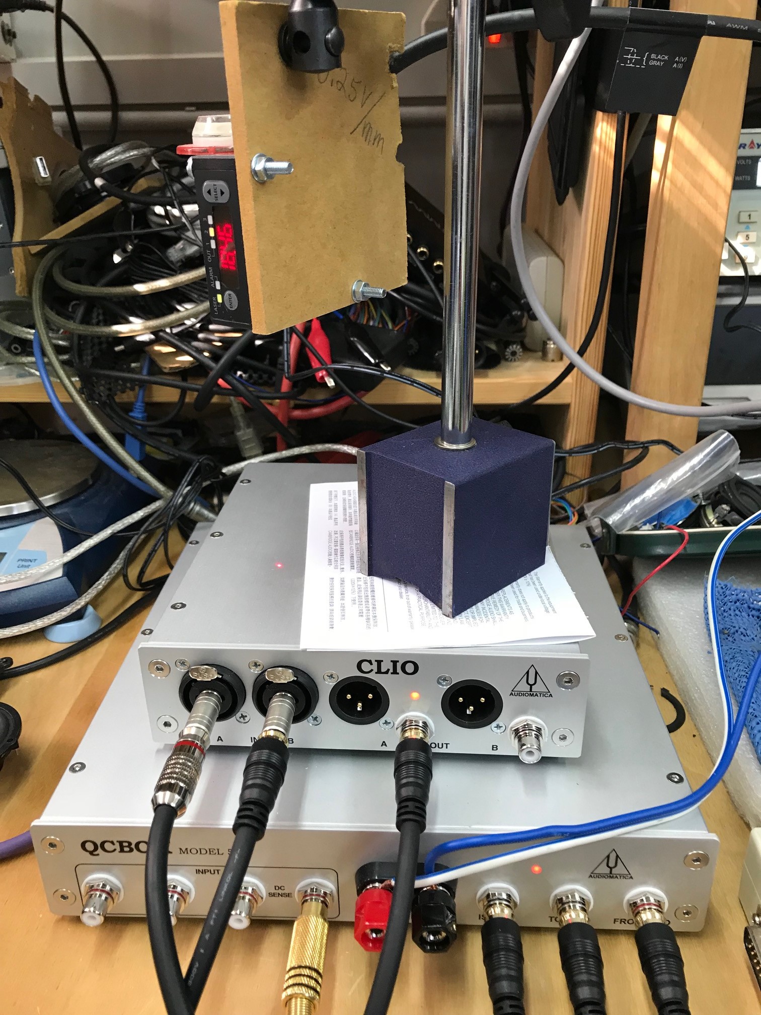

My CLIO 12 QC + SwitchBox V
My tools have arrived. :)
Nice laser too! Absolutely the best way to derive T/S parameters is with a laser - eliminates the issues that can bias the result with added mass or volume techniques.
Nice to see someone has an even messier bench than I do! :)
Yes, the laser is absolutely worth. It helps me a lot in TS as well as determining maximum-safe displacement for Rub&Buzz test.
That is the least messy area of the bench. :D
