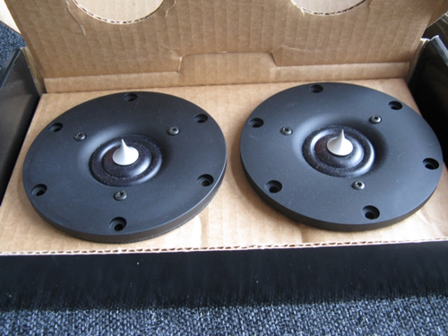

The components were purchased from Madisound with the crossover upgrade option.

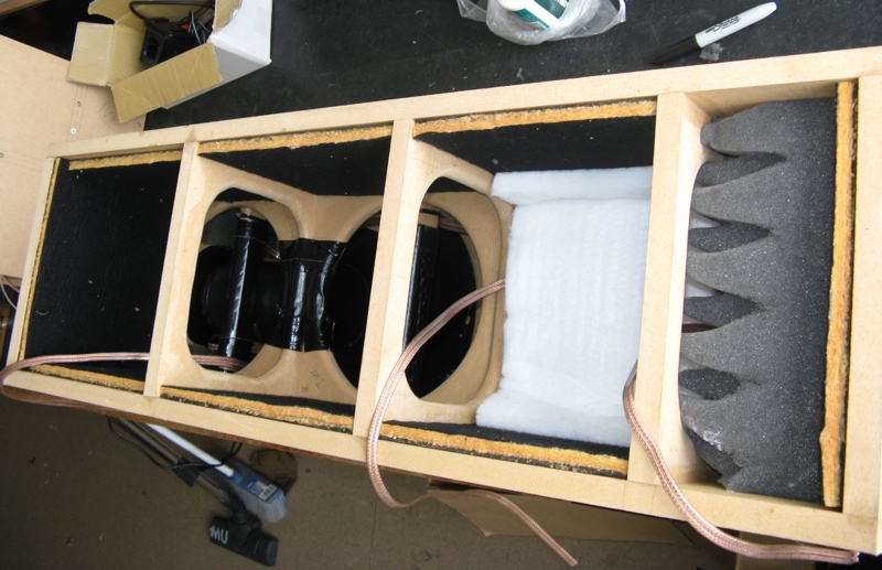

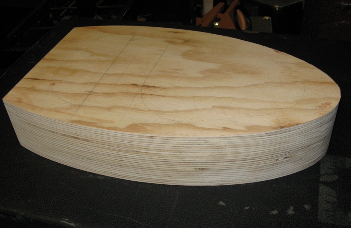

I cut out the top, bottom and two middle curved partitions with a jig saw and joined them on top of each other with a couple of long screws. I then sanded them while they were joined together to obtain a consistent curved profile.
The frame of the cabinets were assembled with wooden dowels, screws and PVA. A fair amount of thought went into the order of the assembly, screwing the frame together to drill the dowel holes, then taking apart to screw and glue some of the parts and finally gluing the dowels in place and the frame as 3 parts. I was really concerned that the frame would not be square and true after assembly, which was important to allow the layers to join without being racked and the smallest chance of a gap developing between the layers.
There are 6 layers of 3mm MDF (pre-bent with a little water and a few very light kerfs cut with a knife). Each layer was then strapped and glued one, then two at a time to the frame with HEAPS of PVA. The first layer is also doweled to the frame.
Each of the layers were made oversize then routed to their final dimensions.
Inside each speaker has Intertechnik acoustic foam and a little Acousta Stuf fiber.

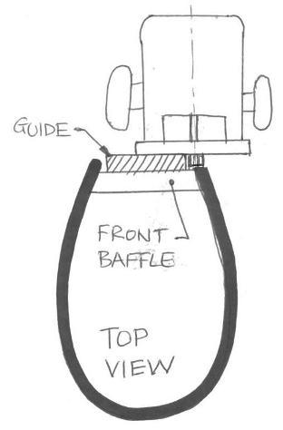

I flush trimmed the sides with a timber guide about the same size as the baffle which you can see on the photo with the straps (though I cut the mitres off the one you see in the photo). Then I ran the router along the length of the timber guide and bit by bit plunged the router untill it was flush. The same process was used on the top (see photo).
That is a cool idea, I will have to save that one!

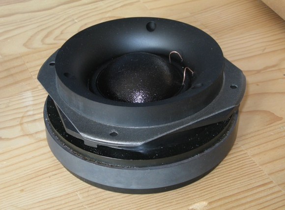

ATC, Scan Speak, Eton
Hi Frankie, thanks for the kind comment.

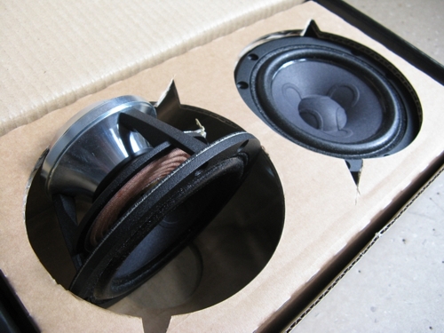

I have started a pair of floorstanders, but not using that design (as yet). I have collected a few drivers over the past 2 years, which is becoming a bit of a hobby in itself! (a bit like my wife's shoe collection), and I am not sure what direction to take in the cabinet design or which drivers to use.
I thought a good place to start was to just build a test box and have a listen to some drivers before I put a lot of effort into building another curved cabinet, which I like the look of a lot .

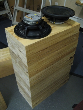

I’ve started with the ATC dome, 2 x SS 22w/8851 woofers and the ScanSpeak Revelator R2904/7000-05 tweeter per cabinet. To make it easier (I hope) I’m using a DEQX for the crossover.

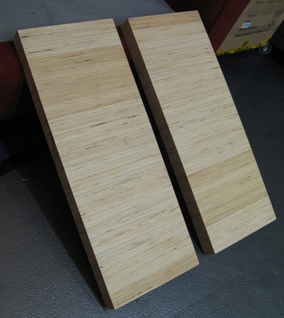

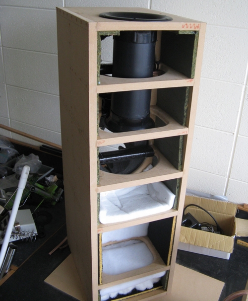

I have some ply I could use to build a laminate curved cabinet, but I like the idea of bending thin ply or MDF like the RBR build. Unfortunately this would cover the end grains of the laminated ply, which I like the look of.
Quote from Frankie
“And then a technical question if I may, if some can answer it. How do the smooth back lines of the cabinet perform with respect to reducing standing waves and does anyone have any links to papers, discussions on that? “
When you bend the MDF panel to create the curve (opposed to a laminate machined curve or deep kerfs) it becomes a lot stiffer and the panel resonance increases quite a lot. A bit like bending a hand saw and playing it with a violin bow (if one is so inclined).
I think that this would be a benefit for the cabinet design.
Does anyone have a comment on this?
