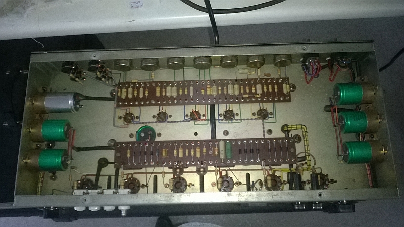

Hiwatt 400 Underside for your "edification"
Ian
Ian

That HiWatt 400 in the picture has 6 off KT88 along the back with B+ of just over 700V.
Ian

Thanks Ian! Having a look under the skirt of a Hiwatt amplifier always is a pleasure to my eyes! That's the way how any tube amplifier should be built. But I'd rather twist the heater supply wires...
