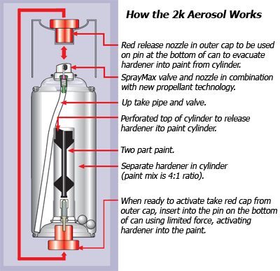

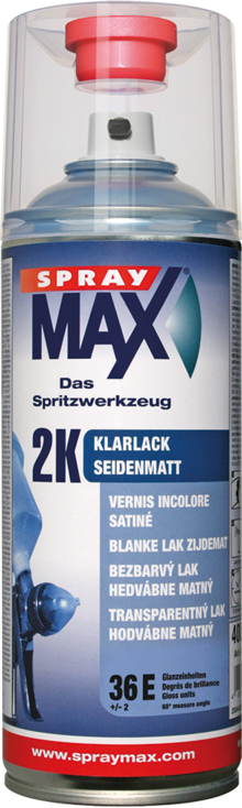

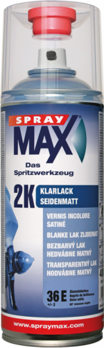

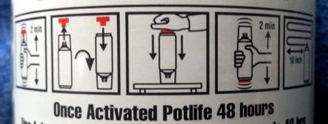

For the clear coat there's a special 2-component available in special spray bottles which comes outfitted with an extra internal chamber containing the hardener which is manually activated through a valve at the bottom of the bottle (see attached picture), when activated the two components starts to mix and cure so the pot life is max 48 hours in ambient temp(!!), the 2-component provides for a much tougher and durable surface.

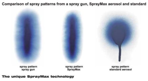

Another advantage buying better quality spray bottle is, they usually come with a special shaped spray nozzle which provides for a much better spray pattern (similar to a real spray gun) and handling (see attached picture).
A good advice is to warm up the spray bottle gently up to ca 35-40 degrees Celsius, the solvents will atomize much better providing for a much better spray fume and result, if the bottle is too cold the tiny droplets are much larger and can even sputter with worse result.
2K Clear coat - SprayMax
Amazon.com: USC Spray Max 2k High Gloss Clearcoat Aerosol: Automotive

Be very, very careful with 2k products as they are extremely harmful if inhaled. I recommend an air fed mask when using these. Look up hazards of isocyanate paints.
