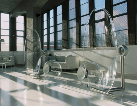

Gasho said:Clear speakers?
Explain to me a simple way of making those and I will be a happy man indeed.
Its called a form mold The product is heated to a given temperature and either vacumme molded or press fit in which it tales a male mold and a female mold. Another method is a heat draw in which a center form is made the product is heated to a given temperature and the center is drawn into the shape thats required.

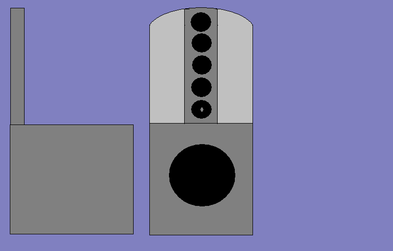

There was once a loudspeaker from I believe Acoustic Research that looked a little like a b@stard child of a Dahlquist DQ-10 and the main panel of the Infinity Beta (..without the sloped/tilted profile of either speaker). In fact it looked considerably better then either (taken alone).
Note my poor "drawing" below. The front is covered with "grill" cloth like the Quad electrostats:
http://www.quad-hifi.co.uk/
However, with the exception of the vertical column of drivers and the surrounding frame, the extension panels from the vertical column can be seen through - because they should be from acrylic. This is not dissimilar from the "void" space at the top of the Infinity Beta main panel as viewed here:
http://www.arduman.com/aa/Sayfalar/rob/speak.htm
The bass bin should contain a 12 inch driver.
The basics are:
4 of the Foster "woofers" (not the fullrange drivers) open baffle with a 4th order LR around 3 kHz.
1 HiVi K1 with a first order filter around 3 kHz.. (this will limit spl somewhat and increase distortion). Driver rotated to an inverted position for aiming the polar "tilt" up. This driver should be about 2 feet from the floor. Measured by member Zaph here:
http://www.zaphaudio.com/tweetermishmash/
1 12 inch Powered woofer/subwoofer "box/bin". DVC connected in parallel to an MCM sub plate amp. (prob. bass reflex - need to do some sim's though)
http://www.partsexpress.com/pe/showdetl.cfm?&DID=7&Partnumber=295-490
http://www.mcminone.com/product.asp?catalog_name=MCMProducts&product_id=50-6272
In effect the top OB column is two way phase coherent design with a dipole midrange section. With the tweeter below the midbass line (and considerably lower than the listener) but with an upward veritical radiation angle of 15 degrees - gives a good stand-up/sit down even high freq. sp-level (..in other words when you stand-up from the listening position the treble won't dramatically reduced in level). The bottom section is a powered sub.
The top portion will need to be modeled for the crossover and baffle effects. The bottom "sub" will need box modeling to give the desired character.
Cost-wise the loudspeaker can be fairly in-expensive for such a *fullrange* design (particularly because its also powered in the bass).

Gasho said (and illustrated):
Gasho, those are extraordinarily lovely - can you tell us more about them?
Aengus
Clear speakers?
Aengus
Thank you, Scottmoose. I found them, and the thread on them.
ronc: Have you done such moulding of similarly large parts? I can see that one could make a form from, say, plaster of paris, but I doubt my ability to vacuum-mould something that size in the garage. Tempting idea, though.
Aengus
Aengus

Umm, the "drawing" looks pretty retched IMO - but it COULD look Awesome. (..and in fact those Acoustic Research speakers DID look awesome - and sorry, I couldn't find a pic of them anywhere.)
For the crossover & box - thats something for you to model. I'd suggest getting familiar with some of the free programs here:
http://www.pvconsultants.com/audio/frdgroup.htm
and this program to show open baffle and diffraction effects:
http://www.tolvan.com/edge/
All are freeware.
Then when you have a better idea of modeling and a better grasp of the "Edge's" interface you can play with Basta for 90 days free (and pay for it if you want to keep it):
http://www.tolvan.com/basta/
The 90 days free for Basta should give you plenty of time to get the model that you want provided that the drivers are similar to what was measured.
If you don't want to "putz" with freeware and just want to spend the cash to get the right software at a good price then I'd suggest SoundEasy (which has both measurement and advanced modeling capability - and with both features integrated it makes it a LOT more convienient and ultimatly more accurate).
http://www.partsexpress.com/webpage.cfm?webpage_id=3&CATID=48&ObjectGroup_ID=360
Note you'll still need the correct hardware to take measurements.. and Zaph goes into that on his site.
Its obviously a better solution - but then it actually costs money..
btw.. you'll have difficulty finding a less expensive subwoofer OR sub amplifer. Now IF you go "active" for everything (modeled in Basta or SoundEasy) then you don't need a sub plate amp and you can just use something like multiple gain clones or digital amps (1 channel of amplification for each speakers midrange section, tweeter section, and woofer/subwoofer section). Additionally, you can use a LR 4th order for the tweeter as well and not only lower distortion but also lower the crossover point for the tweeter to about 2 kHz.
Anyway - up to you, and good luck!

SPL: 107 db/1w, give or take a bit.
Efficiency for sub: 94db/w
Impeadance: 8 ohms
Power, assuming identical gain: 16w
SPL: 96db.
This all seems to work very nicely. I have no idea how on earth those modelling programs work, though.
It's probbably cheaper than a standard crossver, anyway.

I have two 300+ VA toroids, so I think I'm set. Cost me all of 30$!
Can you explain the differences between crossovers work? This is more or less my first attempt (I'm currently tinkering with a simple fullrange and ABS design), and I was hoping for something simpler.
That said, by the time I finish modelling them, I should have no trouble building them. (Copper and acrylic FTW!)
Sounds good for the power supply! (..may have a little less power on-tap, but in reality it shouldn't be a problem.)
With a LR 4th order for the highpass on the tweeter around 2 kHz you'll be able to play the thing louder with less distortion. It however will not have any polar tilt (where the vertical dispersion effectivly acts as if the driver were aimed down or up by 15 degrees, but instead is on flat baffle). Now because their isn't any polar tilt you'll likely want the driver higher on the baffle. Additionally, with a LR 4th order for the midranges at 2 kHz you can seperate the "Line" with the tweeter in the middle with out substantial "combing". (i.e. a MMTMM design for the "Line")
Now a 1st order highpass tweeter will give you better off-axis dispersion (horizonatally and vertically for the stand-up/sit-down thing I talked about previously), a bit better imaging (because it goes lower in freq.), a little bit better tonal balance (..again because it goes lower in freq.), considerably more distortion (..it goes lower in freq.), and considerably lower MAX spl's (..it goes lower in freq.).
Of course there is nothing (beyond some modest additional expense) that says you can't try both.
