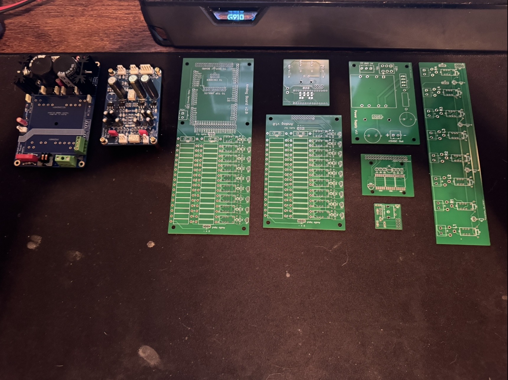

The Preamp controls I have decided to go with John's Preamp Control boards. I have the boards and parts in hand to assemble and test. I like the layout and the functions of the front panel display and controls. Including the feature of being able to use a remote control.
The preamp section I think I am going to go with the Omicron. Due to its size, affordability, performance, and the ability to act as an HPA and a preamp. I think this fits the bill nicely. I have these almost fully assembled, I am missing a transformer and some random bits that I missed on my Mouser order.
The DAC portion of this project I have decided to go with a project from @abraxalito. After much Success and enjoyment from my competition of his Abbado II project, I'd like to implement more of his work into this build. I also will more than likely be getting another I2S input board/selector that I used in my Abbado II build.
I have begun to start on a front and rear panel design in FPD. Its nothing to special as I'm still relatively new to this program. I have decided to go with the Modushop 2U Pesante 02P400B. The internal dimensions of 400mm x 430mm x 80mm should be plenty to fit everything I need inside.
The Omicron uses SE inputs on the board, which works if I'm using SE inputs but what if I am using balanced?
I thought of using the Universal Buffer from Neurochrome, but I have to set up a switch to change from either SE to balanced on top of needing a buffer before and after the omicron. I don't think this is that great of a option, but I am open to ideas.
Attached below is a capture of my front and rear panel ideas and the preamp control boards plus omicron and its PSU. The front panels and rear panels are done for all the options I have decided on (This will change if I go a different route with anything)
Rear panel has the first input removed since the DAC will be internally wired to it, Then the three other inputs the Outputs, the I2S input selection for the DAC, IEC connector.
Front Panel has the preamp controls, volume, input, selection, display, and LED for showing which input is selected. There is then a mirrored side with the input selection for I2S. Crossfeed switch for the Omicron, Power switch, and the headphone jack.
Issues that I thought of while writing this thread:
