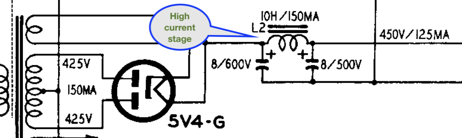

The way they work best is; Rectifier into a tank capacitor feeding a choke and into a final capacitor.

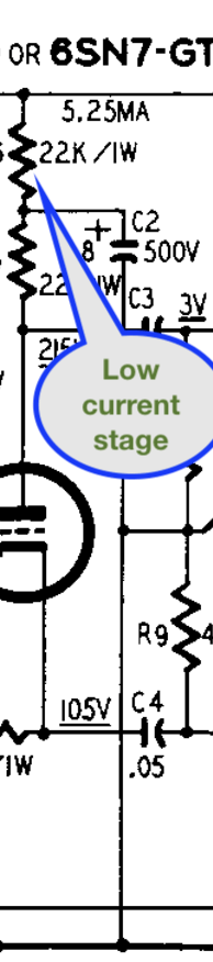

Any ripple caused by current drain from the supplied circuit is inverted within the choke inductance and pumped back into the second capacitor. If there is very little current drawn, (like in a pre amp stage), a choke is not needed as a resistor is sufficient. Power stages bennefit from a choke but then again, only the one.

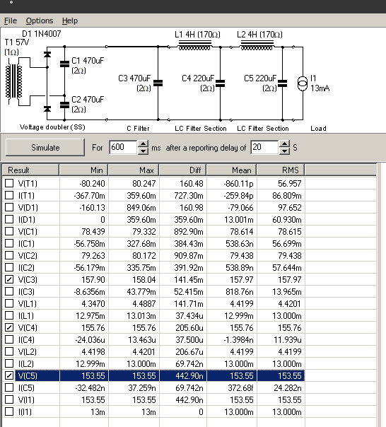

Actually, multiple chokes will probably be a liability. Each CLC filter section has a resonance. Put a few in series and the resonances interact with each other in crazy ways. Perhaps a CLCRCRC would be OK. But I think ruffrecords is correct. A string of CRC filters can suppress ripple into oblivion country, with predictable behavior (resistors don't have interwinding capacitance or other faults inherent in inductors).

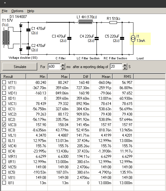

PSUD2 does not show impedance bumps and possible resonances in the power supply. There is more to a power supply than simple ripple rejection.
For instance, if the ripple rejection is -95dB at 120Hz, we'd say that PSU is really really quiet.
But what if the power supply noise suppression way down at 1Hz is only -5dB, or even worse? Yes, that is a possibility with a passive supply, especially if you don't decouple the high gain input stage of a phono preamp effectively enough, This becomes critical if you're using a pentode or cascode input stage.
Some combinations of L and C and series R will create a low frequency resonance that can cause problems. It is sometimes necessary to add series resistance to the LC network to damp that resonance. Of course that defeats the purpose of using a choke there (lower DCR compared to a series resistor to achieve the same time constant). In some cases an RC with a resistor the same value as the DCR of the choke can prove to be superior.

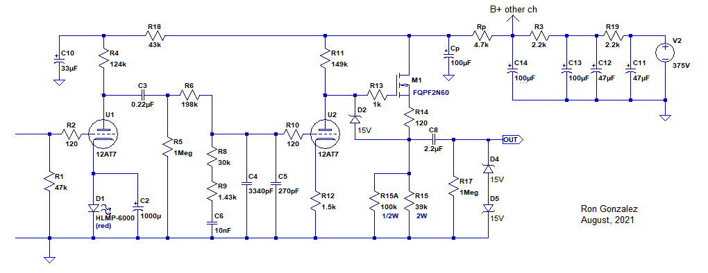

In this case I was forced to put the longest time constant to the audio input stage, so at the end of the CRCRCRCRC chain.
I've attached a schematic of the RIAA phono preamp and its PSU. It's a very simple circuit, really elementary. I built it on one of Merlnb's Compact Phono PCBs. The raw B+ DC supply is on a GlassWare PCB, and the heater DC regulator is on a Pete Millett board.
R18 and C10 form the decooupling network for the power supply to the first (input) stage.
Originally R18 was a smaller value (I think it was 10k to start with), which brought on the motorboating issue. Increasing R18 to 43k fixed that problem.

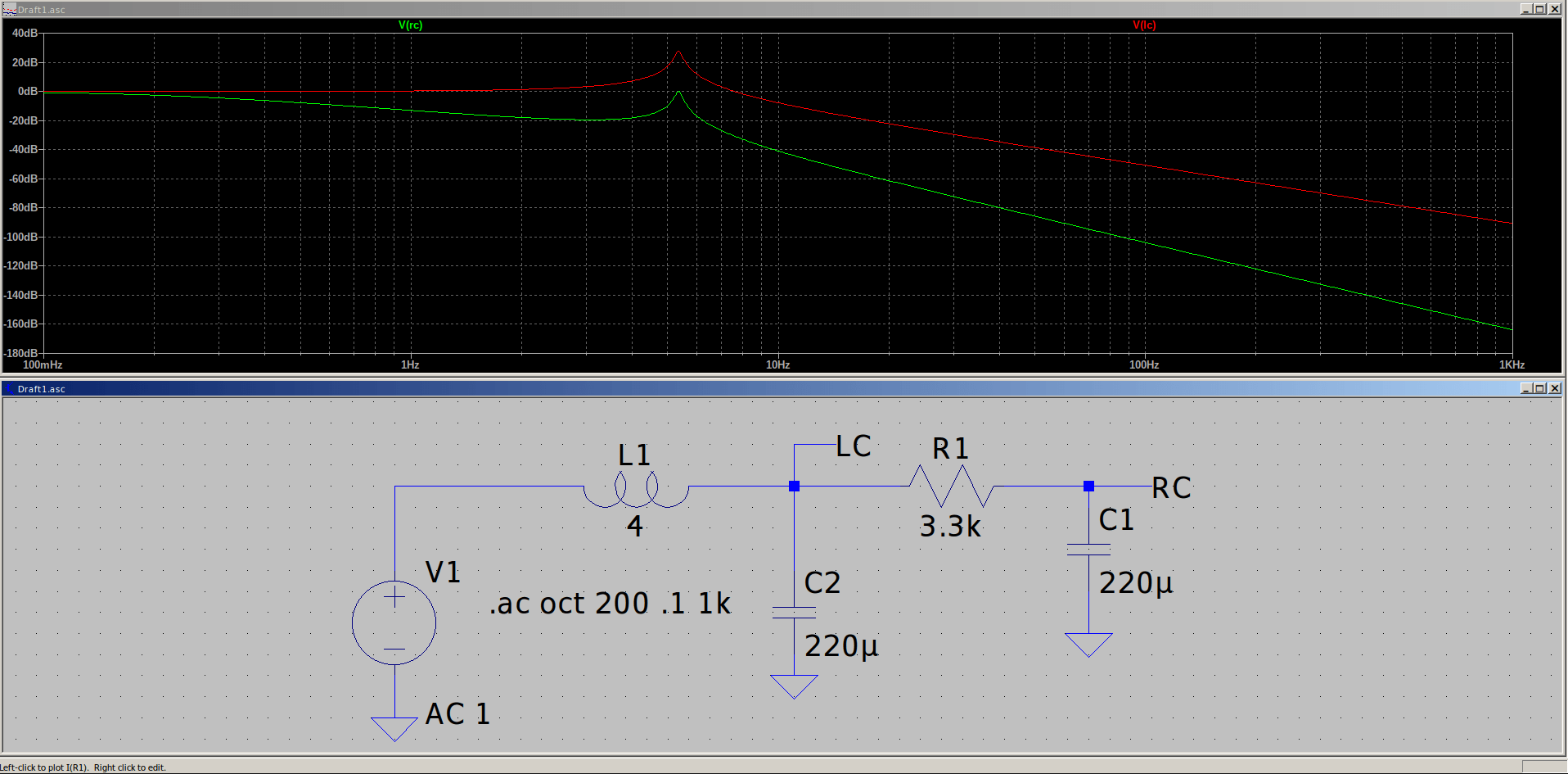

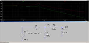

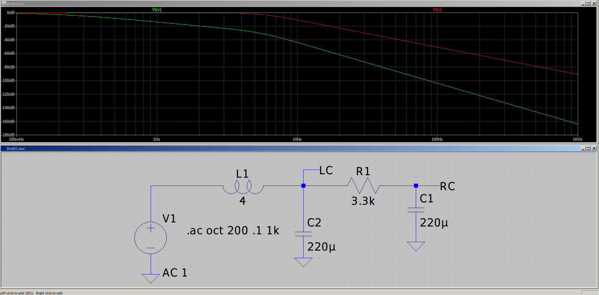

Just wondering about using LTspice to visualize filter design options. The issue of resonances makes sense so was thinking about how to deal with them So I ran this inductor
https://edcorusa.com/collections/power-chokes/products/cxse5-5k-4h-50ma-choke
Through setting its series resistance to zero and then the actual 170 ohm value with the former showing a resonant peak which the series resistance damps out. I set a following RC stage with a lower turnover frequency to reduce any resonance. Would a similar approach be the way to compensate for resonances due to other stray parameters in the amplifier circuit or would you need to know the exact kind of resonances? If doing LCLCRC would you want the turnover frequencies of the two LC filters to be different so as not to multiply any resonances?
