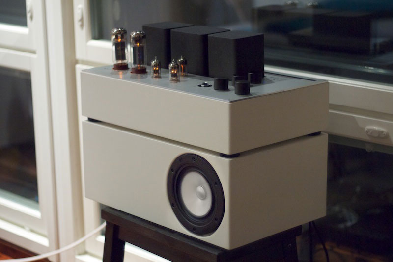

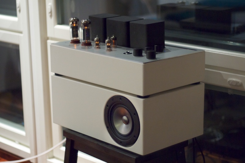

have now built the system mostly - feet and the amp box missing. The amp box will get an aluminum top plate with engravings, the feet will be aluminum, too.
I chose to go with a 3-box setup; the tube amp and some other electronics (Bluetooth, iPhone dock and some other integrated gadgets) in a separate box. This box will be have spring feet (plus an air pillow inside for the tube amp) and may sit on the other speaker.

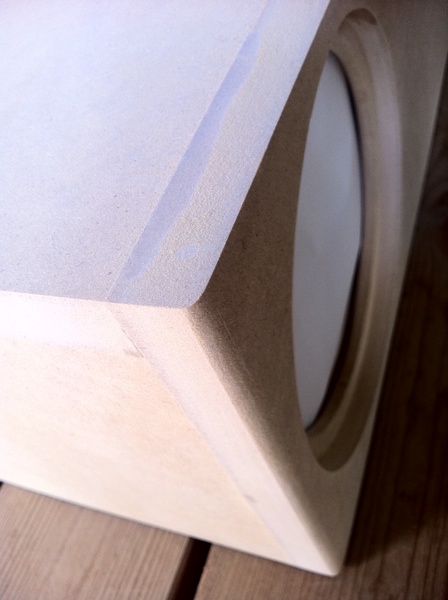

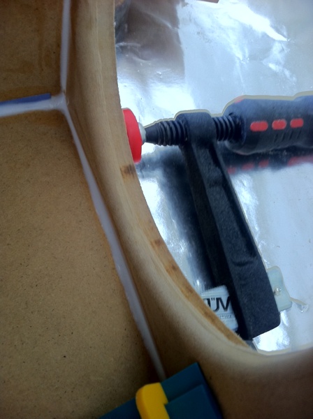

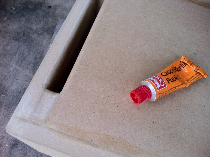

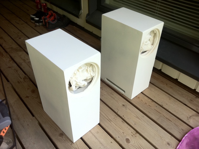

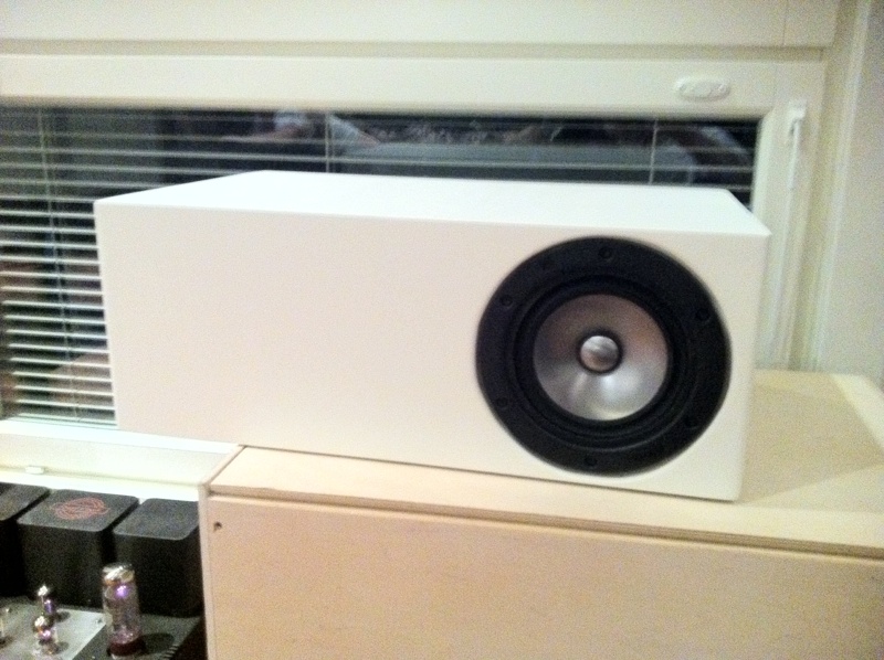

For speakers, I chose to make an original version other than the CGR or SSP to suit this project.
Differences:
_The dimensions are different.
_MDF is 19 mm.
_The driver is on the narrow face.
_There is only a single vent. The dimensions are adapted. The exit and input ends are rounded from all 4 sides.
_The bracing is different and there is some additional bracing.
_Lining: Sonofil
These boxes could be run vertically, too - narrow form factor has more WAF than a wide :) This is after primer and 1st paint coat:
attachment.php

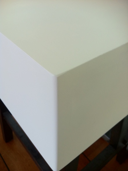

The finish is an off-white spray-paint (fully matte, warm white) to keep the looks very minimalistic. Had never used a spray-gun, so this was a learning experience, too:
attachment.php

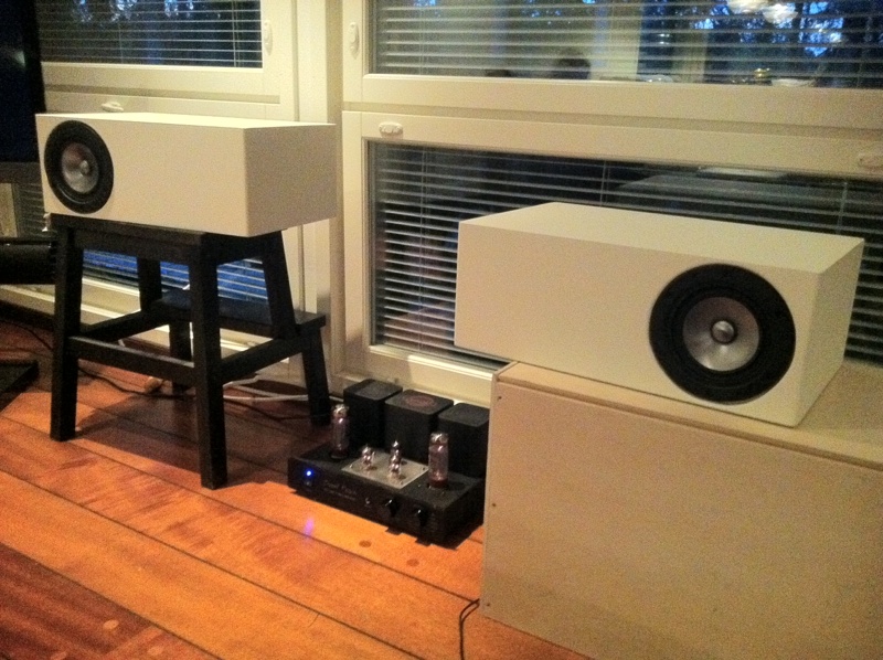

Now breaking in the drivers with a tube amp and some easy music:
attachment.php
Low volume, first impressions are promising.
At first, there was a clear hiss on lower frequencies, and I got worried - but traced it down to one missing screw on a driver (!) - the pre-bored hole was leaking through.
Seems like an excellent driver even in these first time DIY builder's boxes. I am going to adjust the Sonofil after break-in by ear and my measuring microphone. Need to do something about the room at the same time, too - there are clear nulls at some frequencies. Oddly the situation is the worst at the very place of listening to music.

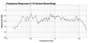

By ear, tightness remains for some material, area around 1 kHz is too loud. But based on first measurings, that seems to be more of a room problem - remains to be measured thoroughly. (I've not used this room for music before, so there are no curtains etc.).

Room problems

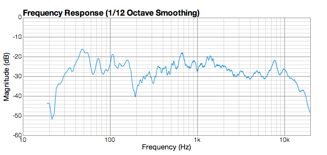

By far, the worst is the room I'm using. It is a complex, open modern room with wall-sized windows without curtains - including kitchen, hall, high staircase and the living room all in one space. There is very little damping and I get standing waves with any speakers erasing bass with serious narrow nulls at approx 60 Hz and 80 Hz. Plus boomy peaks at approx 45-50 Hz, then again above 70 Hz and a very pronounced peak at just above 100 Hz.
Then there's a serious large scale drop at 200 Hz (continuing upto 600 Hz). As stated, the area around 1 kHz is then boosted and there's a lot of comb filtering there - just to give you a quick taste of the magnitude of the problems of this room...
Probably moving soon, so sadly no treating makes sense at this point in time.

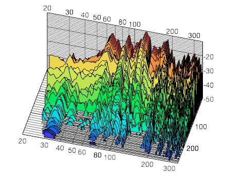

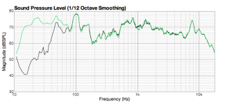

Below are some very first rough measuring results. Was not able to run them very loud, it is late already.

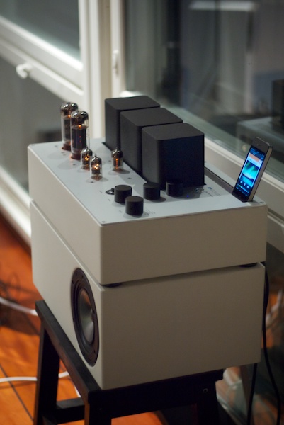

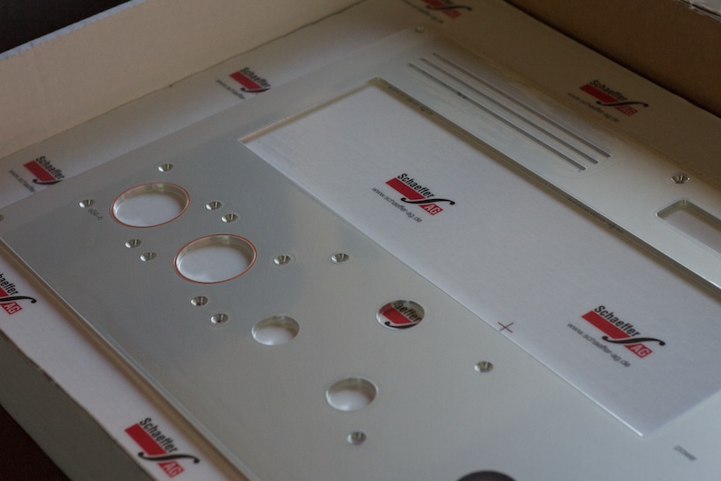

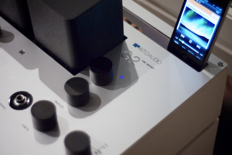

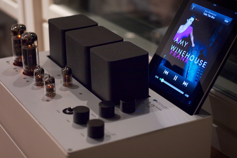

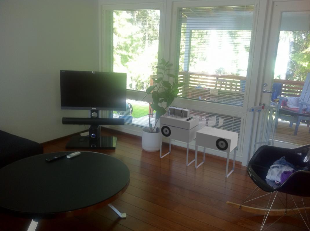

Thought I'd share some progress through pics: Amp ready now as well. The top plate is 3 mm aluminum.
The amp is based on a Chinese amp with EL34-B tubes. Disassembled it and used most of it for this. Added BT and a charging iPhone/iPad dock. It had USB already. Further actual tuning of the amp remains for winter.
Just after assembly noticed that the right channel was bad (almost muted). After a frustrating disassembly and bug tracing found a bad connection for one of the resistors and now everything works. :)
The Alpair speakers sound better now than with the basic Yamaha HT receiver.
Next project is to build a matching sub for this setup. Ordered servo components from Rythmikaudio.

cute little rig indeed.
Im not sure if placing a tube amp directly on a speaker is the best way you can go... given that tubes are microphonic, sensitive to vibration, maybe you should try placing the amp on its own stand and finding out if it has an effect. I have a set of CGR7 slim cabinets, ported to the rear, much like yours. They vibrate enough to make me think it could have an influence on tubes.
The CGR enclosure makes pretty substantial bass given its size, but I find it a bit flabby for my taste. I have them sitting on a pair of H frame eminence 15a OBs at the moment, taking care of that problem. The sub you planned might also alleviate this.
Next I plan to try the dMar-Ken7, to see how they stack up...

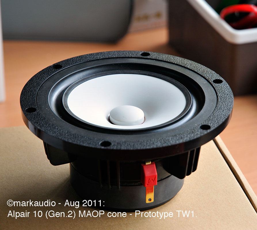

Hi Mikko,
Thought it might be interesting to imagine your project with MAOP coned Alp10 drivers. Your off-white boxes have a similar colour tone to the new MAOP cones. I've done a little Photoshop work to simulate the look (see pics). Since most Alp 10's are supplied with loose front covers, they could be painted - colour matched with you cabinets. Apologies, my PhotoShop skills aren't the best, at least it gives an idea of what can be done to keep adding a "pro" look to a Diy project. Your project is looks ver pro "high end".
Hope this is OK with you - thanks.
http://www.diyaudio.com/forums/markaudio/194359-alpair-10-gen-maop-prototype-tw-1-a.html
Cheers
Mark.

chrisb: thanks! I love the sound, seems to be getting still better (a bit over 200 h done now)...
andb: thanks - I was worried about microphonic issues with tubes, too. The casing is on soft rubber feet on top of the speaker. But you are right, I should test the difference and lift the amp off the speaker - then listen to the difference.
Regarding bass: I am quite happy with Alpair 10.2 in a CGR box - I've modified the vents: 1 instead of two - so more friction as it is very high ratio (approx. 1:10) - maybe even closer to a sealed box as a result -> thus bass might have less extension but more tightness. I also do not like a floppy (bass reflex) bass at all...
Drivers: Probably Alpair 10.2 also has a different bass than the 7?
I get 40(ish) Hz in room as shown on the measurement above. I ordered servo sub parts for a sealed sub to add (tight) extension - takes some time as they come from the U.S.
Mind you, the bass is not light or inadequate now, either. Nicely present in a musical way, no "commercial" boom at all, very natural. But for some music, I'd like to have that 15-40 Hz covered as well. Let's see as I build the sub... Already retired 2 bass reflex subs after testing as their sound was too soft and did not fit.
Mark, thanks - looks excellent! I like the MAOP cone colour a lot. Wish that was available when I got the silver ones. The white cone + black bezel is especially very nice - some contrast remains as the bezel ties the driver visually to the black aluminum knobs and black transformers on top.
Shall read more about the MAOP thread - seems like an interesting development.

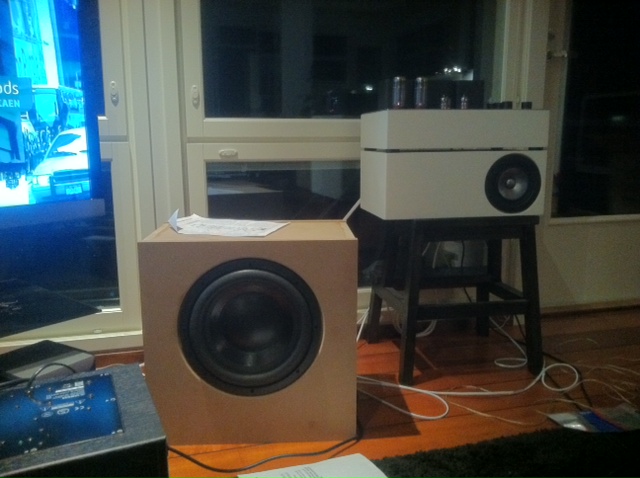

Update, added that servo subwoofer to the setup today.
Put the sealed enclosure (42 l) together today after work and tested quickly to see if everything is OK so I can sand and paint the box during the weekend.
So far seems very good. Extension down to near 10 Hz, with a very precise and rapid bass, complements the Markaudio drivers well.
