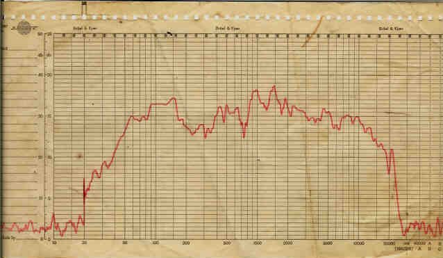

The MTM is nicely done, but in the rock era, the 'West Coast Sound' response typical of Altec, JBL or similar proved the most popular:

No 'perhaps' judging by what was used in clubs, fraternities and those that could afford them, though of course the somewhat 'boomy' big bookshelf cone/dome offerings from both USA and foreign manufacturers were also popular due to being generally cheaper, smaller, but they too tended to have similar response profiles even though they didn't sound the same due to not being horn loaded, or at least not down nearly as low as the most popular Altec/JBL products.
