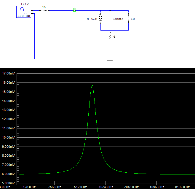

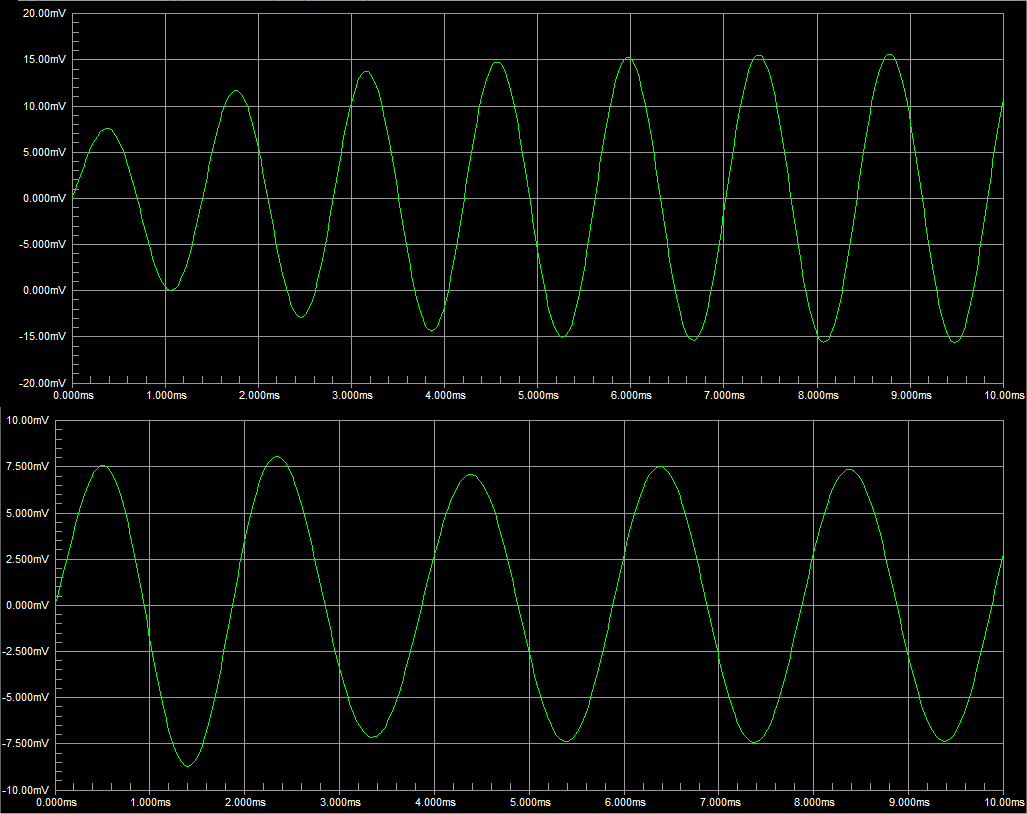

This circuit is the equivalent of a tweeter (just the resonance). The voltage plot shown below it is indicative of the impedance peak.
The transient response in the next image is the result of a sine wave stimulus at resonance (above), and just off resonance (below). They should be straight sinewaves of constant level, but the non-constant levels indicate energy storage. Their variance up and down indicates ringing.

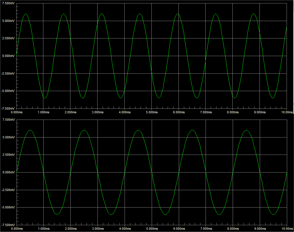

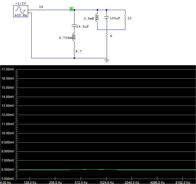

This circuit has an RLC added. The impedance is virtually flat as a result.
The RLC is accepting energy in a conjugate manner (equal and opposite). Looking at the transient plots (same frequencies as before), the voltage which is driving the tweeter remains steady, as it should.
Furthermore. I've been driving this circuit with a 1k resistor to indicate the impedance. This resistor also isolates the circuit showing that it is behaving itself without assistance from amplifier damping.

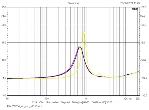

@speakerdoctor: That little blip at 1800Hz you notice on the Morel tweeter is, IMO, probably an artifact of the voicecoil gap needing more venting or damping as in the yellow trace for an Audax TWO34 unmodified tweeter. There are limits to how much you can do, but Troels Gravesen discusses this stuff here:
TW034

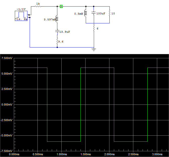

That's FANTASTIC, AllenB! Love it. Question though...because I'm wondering if you've made an all-pass filter there, what does it do to square waves around the Fs resonance? Any delay or ringing? For people who don't know about all-pass, it is that their sinusoidal frequency response is flat, but phase and group delay is still affected...
TW034
When the impedance is offset correctly, square waves will be plenty square.
