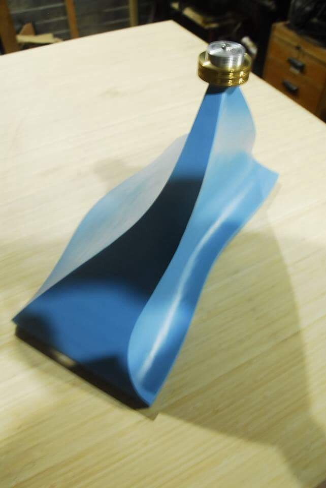

But what would be the advantage (if any) of that first curved section near the throat?
M.
From my memory: Western Electric used a bent throat to optimize the wave front depending on the horn flare / total horn length, in accordance with the desired dispersion for the size and shape of the mouth.
But we'd better ask Dr. Horn aka Bjørn Kolbrek for a comprehensive and educated reply.

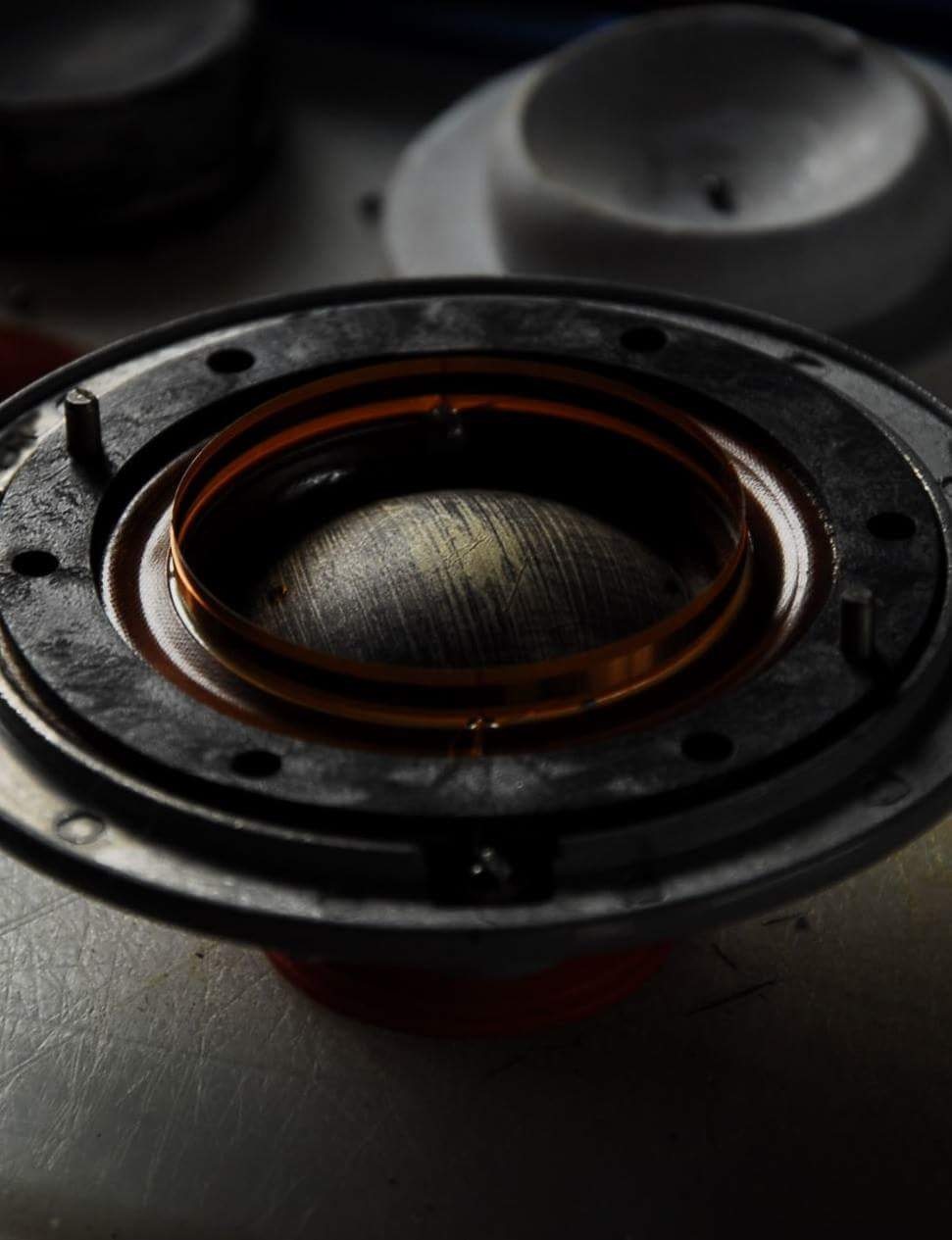

This guy, however walks the extra mile.
Why buy of the shelf items, if you could develop and build your own?
Look at this driver and diaphragm material for example:
