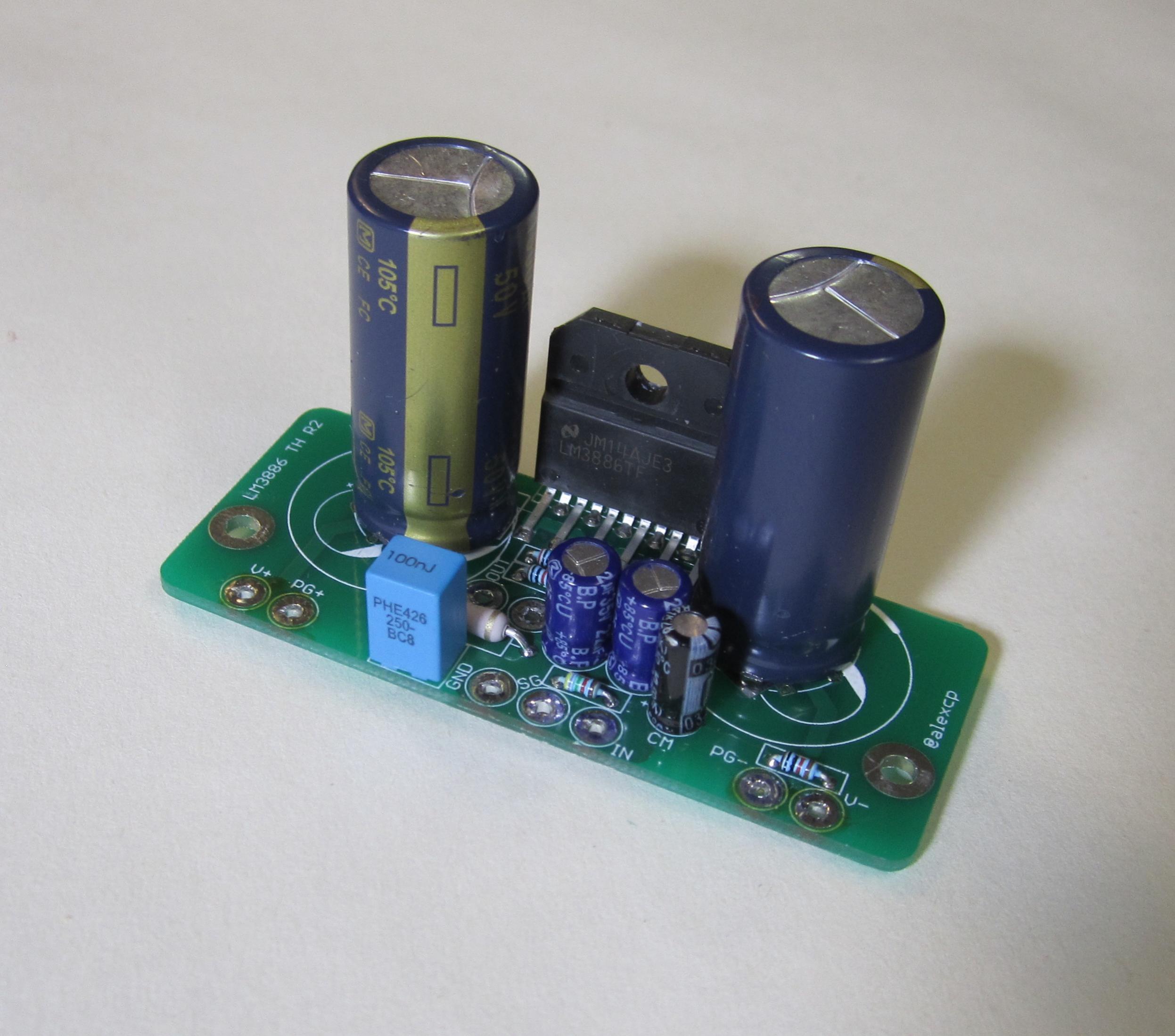

Joined 2009

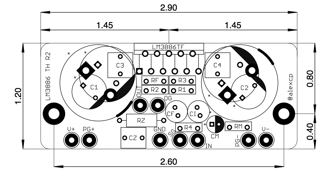

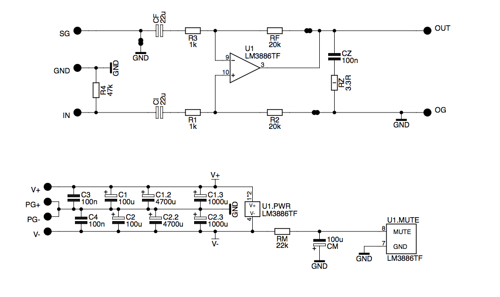

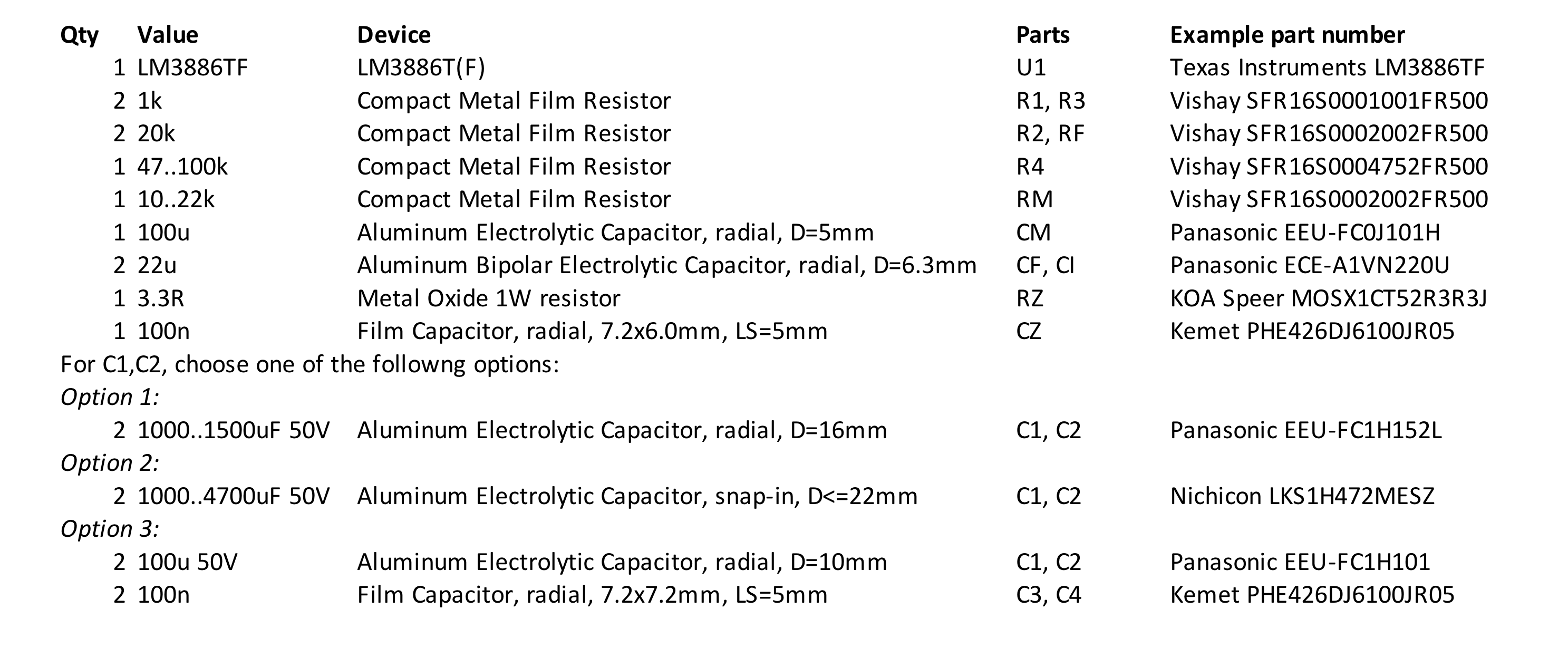

Classic LM3886 Amplifier PCBs
Attached are the schematic, mechanical details and component placement, a sample BOM for one channel, the spectrum of 1kHz sine wave driven by the board at 45W into a 8Ω load with an unregulated power supply, and a photo of the sample build as tested. The BOM is also shared via the Project Manager at Mouser.
Some notes:
  1. The board needs two 25..35v power supply rails. They do not need to be regulated. Higher voltages increase output power but also increase dissipation, esp. for 4Ω loads; refer to the LM3886 datasheet for details. The absolute maximum power supply voltage that an LM3886 can withstand with the input signal applied is 2x42V.
  2. The board shows its best distortion performance if powered by two isolated power supply rails connected to (V+, PG+) and (V-, PG-). A bipolar power supply with one common connection shared by the two rails (e.g. V+, COM, V-) will work, but the distortion will be higher.
  3. In a stereo setup, separate power supplies for each channel are recommended. The reason is that, as in most LM3886 based designs, the input signal is referenced to the board's local ground. In a stereo amplifier powered from a single power supply, the local grounds for each channel will inevitably be slightly different. The difference will add to the input signal, resulting in additional noise and distortion. With the distortion as low as this board can produce, it doesn't take much difference to ruin it; 0.002% of 1V(rms) input signal if just 20uV(rms). Separate power supplies for each channel solve this problem. A possible workaround (not a solution) with one power supply shared by two channels is to connect the local grounds of the channels with a short, thick wire with low impedance and hence low voltage drop.

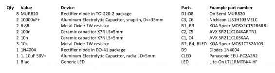

Joined 2009

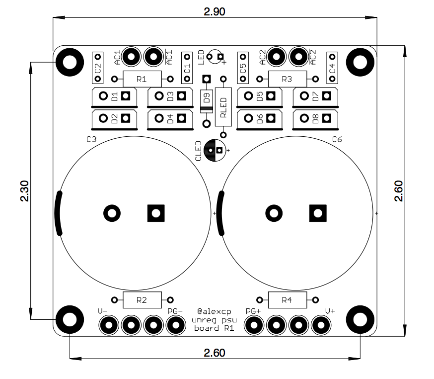

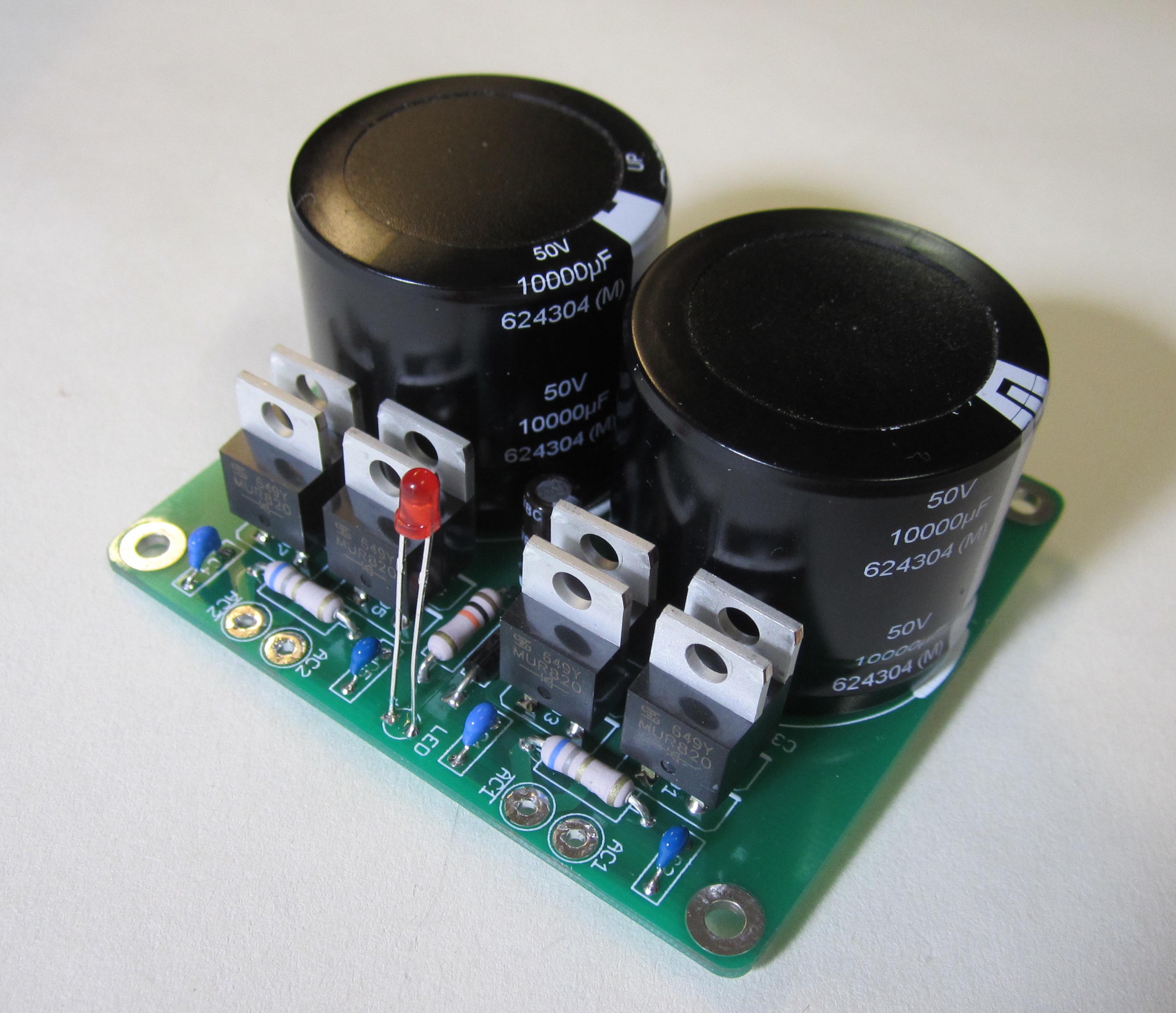

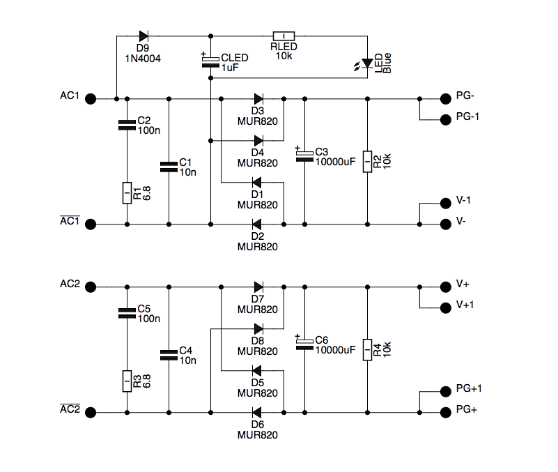

Classic Power Supply PCB
Attached are the schematic, mechanical details and component placement, a sample BOM for one channel, and a photo of the sample build as tested. The BOM is also shared via the Project Manager at Mouser.
As noted above, the board required a power transformer with isolated secondary winding. A single winding with a center tap won't work.

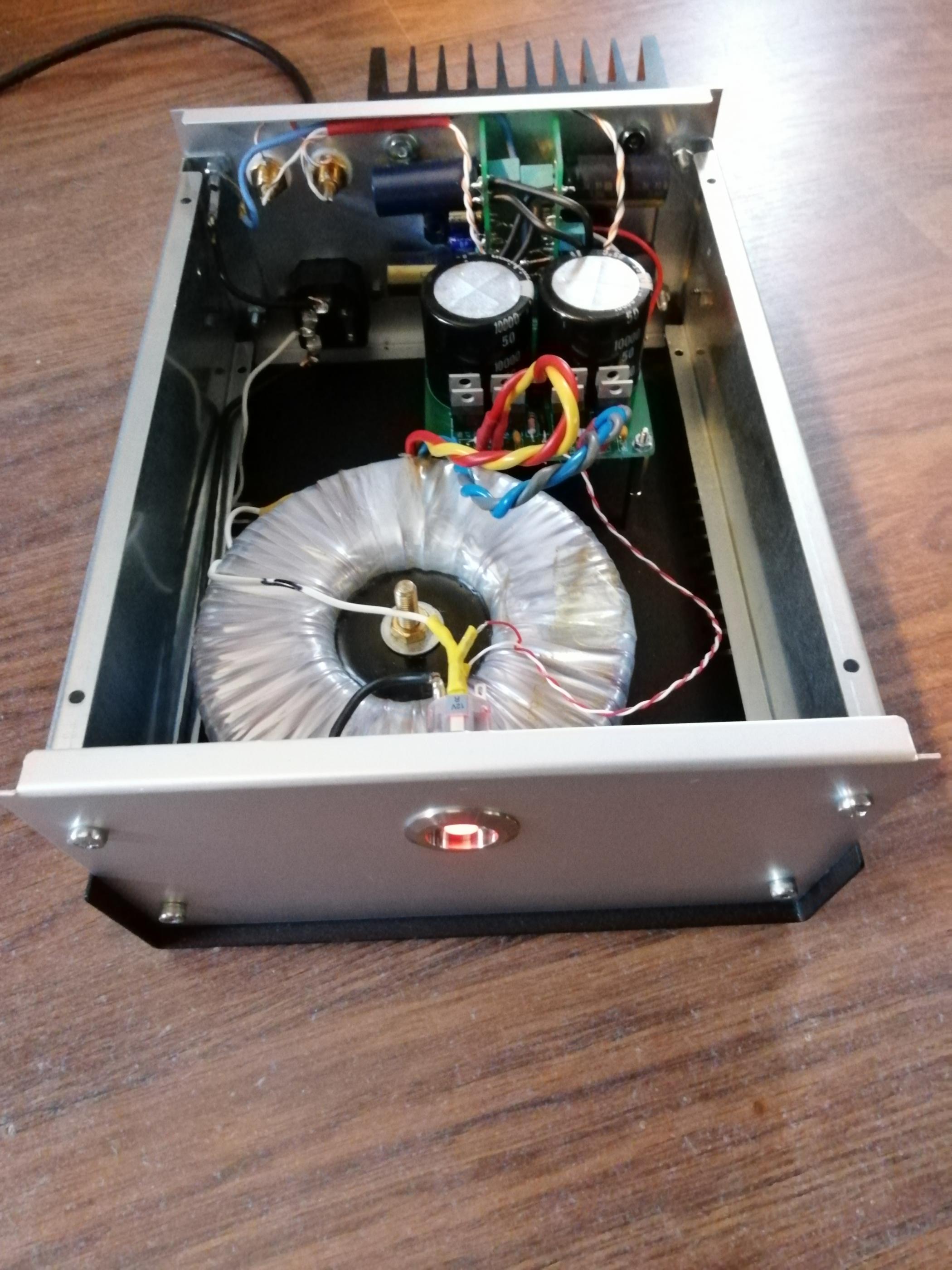

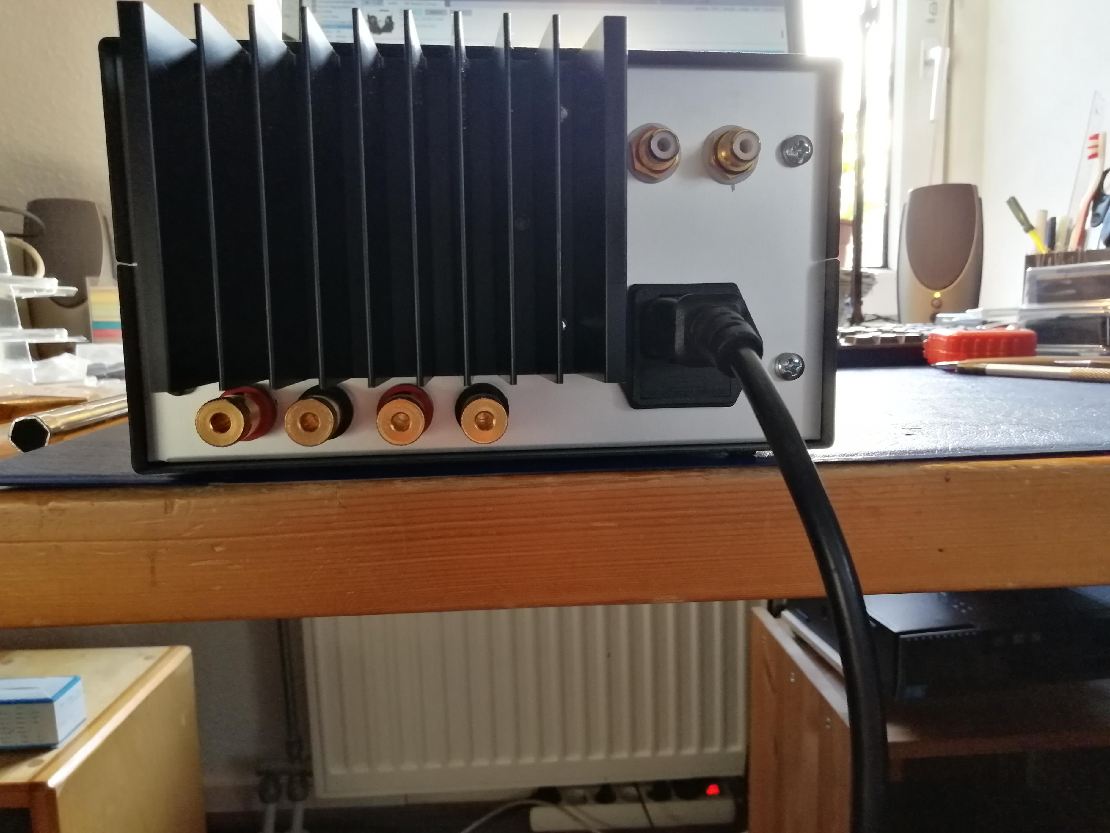

Hi Alex,
Today I have finished the amp. There is no audible hum and the offset with capicitors omitted is 30 respectively 39mV. In the Netherland we don't have wall outlet with ground in the living room, so groundloops are not a great problem. The sensitivity is 4dB lower than Brian's amps, but that is not a problem in an active system. I am very content with the Amp. Thank you.
Best regards, Cornelis
