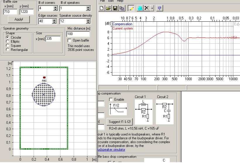

200 l tuned at 35 hz gives pretty good response with the given driver.
The group delay is ~ 22 ms, but you'll live with it, the slopes of the GD curve are not very steep, so it would not be very audible. Maybe some definition will be lost under 40 hz.

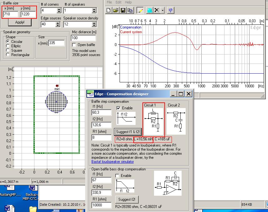

If you reduce the frequencies above 70 hz with 3db, your - 6 db point (F3) will become around 28 hz which is pretty good.
But before that you would have to deal with the baffle step, which is considerable wit a baffle sized 71x122 cm.
Without BSC you have a 8 db peak at 300 hz.
If you add the suggested by the Edge BSC, you will be left with a little over 2 db peak at 300 hz.
So a second order LP crossover at 300-350 hz and HP at 400-450 hz becomes an obvious solution. The final response should be flat with those measures taken.
Then the - 3-4 db correction can be added if you wish. A bigger version of this would do it : http://www.diyaudio.com/forums/full-range/180491-l-here-l-there-l-everywhere-2.html it can be applied to the bass and midrange section together and it can be adjustable.

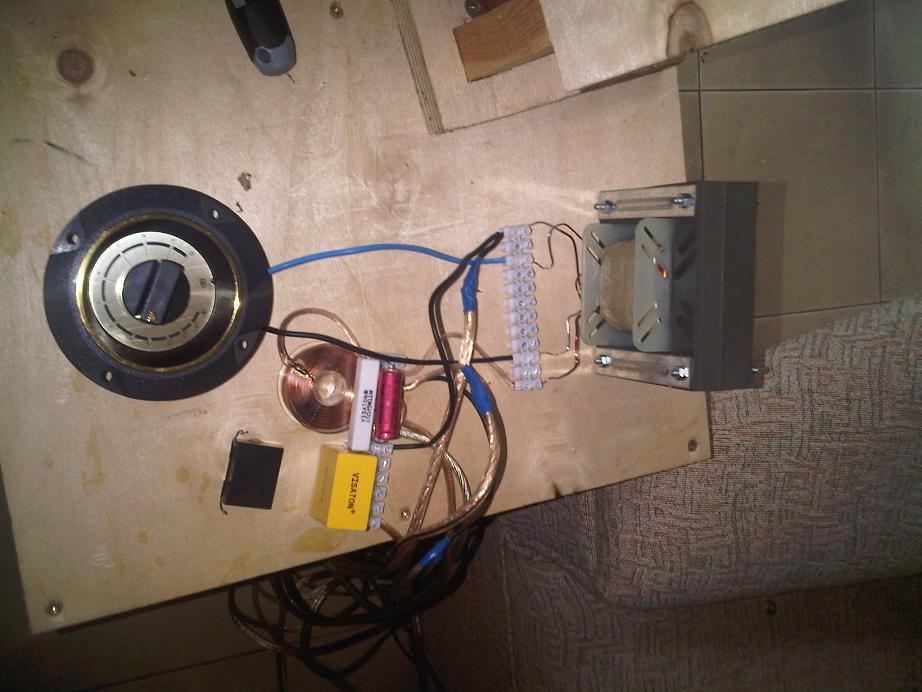

You can do it without a transformer, with just an adjustable rheostat in the place of the bypass resistor, but then the demand for power rating is about double and the price of the rheostat is about triple if you even find one that powerful.
If you go with the adjustable correction circuit (which is an over sized BSC and thus it's relative), you could have an adjustable L-pad for the compression driver. Then you'll have adjustable midrange and adjustable treble.
All this will come to you at the price of two big inductances per speaker cabinet and two rheostats.
The third photo is the transformer with a powerful rheostat added to it, the same if wired with all 3 leads is a powerful continuously adjustable L-pad and comes at a price of about 30$ here.

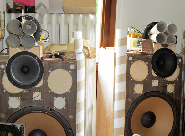

Well hello!
It has been quite a while since my last post here, and though progress has been slow, it has not been altogether lacking.
I have started construction on the cabinet and done some test finishes. I will add pictures of this later.
One might well wonder why I have been quiet on this for so long. I noticed this myself 🙂p) and I know that when I find myself procrasting on something like this, it is because something is not quite right. I have had to re-evaluate some of my starting decisions on the project.
The primary issue, much discussed earlier in the thread, is the lack of LF extension, especially for such a big speaker. The truth is that the 35 Hz I was looking at just was not making me happy. It is true that it is 'enough' to reproduce most music, but I also know that it shouldn't be too hard to do better. Having come to the realization, I made the decision to search out a better woofer.
My original choice, the JBL 2226H, is a venerable and well respected driver. The problem, I realized, is that it just didn't fit my application very well. I really wanted to get below 30 Hz. Now, some will doubtless argue that 35 to 30 Hz isn't much of a difference, but I felt it really shouldn't be that hard, and if I am putting this much effort and resources into something, I should do what I could.
So a couple of weeks ago I set out, WinISD in hand, slowly slogging through the various venders catalogs plugging in likely candidates to see how they would work in the cabinet I had already envisioned.
The results were rather surprising to me. For one thing, a lot of 15" speakers exhibited the same f3 as the 2226H. Of course that wasn't the only thing I was looking at: Distortion, xmax, bandwidth, fb, SPL, and power handling were all considerations, but the sheer general uniformity of bass cutoff was somewhat surprising.
It seems many woofers are made with close to the same general lower limit. That is not always apparent looking at the specifications, but when modeled that is what shows. Exactly why this is so is probably somewhat complex. Is it a general compromise between frequency coverage and mechanical capability? Or is it a convention that has more to do with the prevalence of the separation of monitor boxes and subwoofers? Dunno, but I did notice that the speakers that went really low tended to be far less efficient and far narrower of bandwidth.
Others reading this may well be saying 'Duh!', but this newb found it all very interesting, so I thought I'd write it up here as part of my 'voyage of discovery' that this project is turning out to be. 😀
The driver I eventually settled on did not look too promising to start. Fs @ 42Hz, f3 listed as 35Hz. Speaker was unrated at partsexpress. Still, it didn't look too bad, and by then I was getting desperate, so I plugged it into the simulator, and I found an astounding thing: It worked.
Vas was stated as 115.5L, but when put into a 200L vented cabinet the lower end just kept extending. Tuned to 29Hz the curve gently dropped off to a 29Hz f3, and the Xmax curve was within limits to 300 watts. In fact, box volume could be extended all the way up to 300L, and properly tuned the f3 was good down to 25Hz! 10 cu ft is just too big, even for me, but I thought WOW, why haven't I ever heard of this driver?

Why do you ask that? It's only 65 cm wide, 132 cm tall, and 40 cm deep. 🙄is that a anti WAF cabinet ?
As you can imagine, this has been a bit of an issue, but she'll come around eventually - I have faith! 😀
