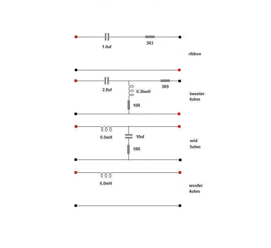

I'm pretty much dreading trying to figure out the crossover.
btw, I just recently finished this low budget 4way
different approach
but I rarely play loud
and if I do, its really not very loud

tinitus, are you sure that midrange could not use cap to band pass it?
yeah, I know
mid moves too much when loud
but those big caps are bloddy expencive
but if I wanted to play loud, yes it should have a series cap, and a paralel inductor
and it will probably screw up the present filter
but yeah, I have some bipolars I have to try
and a zobel on woofer
but I'm sure it will cause a lot of trouble
I will try it when I have some free time
but right now I just enjoy the music
but to be honest, I'm done with audiophile listening
instead the music is pounding many many hours every day

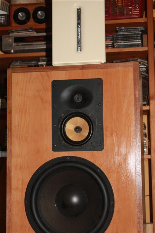

Lowpoke asked for a picture, so...🙂
The one 2226H is still in the stand I threw together to 'burn it in'. I'll have to tell about that in another post.

for the most part I hope all this over-building will result in taxing the system as little as possible at 'normal' listening levels.
This effect (not sounding taxed) will be helped greatly by your choice of woofer and compression tweeter regardless of your amp power. The open backed cabinet might work against though. FWIW even though you hinted you don't need to go there, I doubt you'd get 120 with a single driver on an open baffle when fully EQed.
