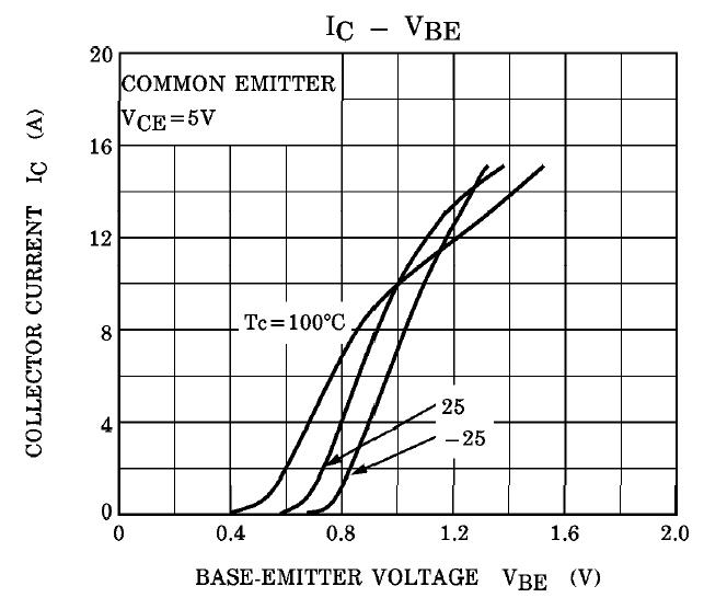

Mr Evil said:.."Proper" biasing for class B means that each transistor is conducting for exactly half the cycle...
The picture below shows the transfer characteristic IC-VBE of a frequently-used transistor 2SC5200. What is, in your opinion, the "proper" VBE value for class B biasing? What is the expected IC current in this case?

Certainly there is some leeway in the definitions, but it is helpful to distinguish between the normal class AB where there is a significant region where both transistors conduct, and the optimum class B where the two transistors are as close to 180 degree conduction each as possible.maylar said:That's a sticky point with some engineers. In most classic definitions, Class C is defined as "Significantly less than 180 degrees" and only applies to tuned RF circuits...
I know of no way to calculate what the optimum bias is. The only way is to make distortion measurements as the bias is adjusted. As bias is increased from zero distortion will fall, then at some point it will begin to increase again. The optimum is where distortion is at a minimum of course. In my experience this can be anywhere from as little as 0.5mA up to a more AB 20mA, depending on the devices used.moamps said:

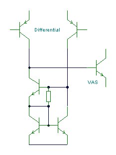

Mike, your comment about current mirrors is very true. A current mirror by its very design forces imbalance into a long tailed pair. This is because of the bias current needed by the VAS, which is driven from one arm, not the other. The Cdom is also a big sonic influence, as you point out, but if the cap type is right and its value exactly correct, the sonics are little damaged.

Hi Hugh,
Class-A to class-D is a greater jump than I can envisage due to the always necessary output filtering placing reactive components between an output stage and a high frequency driver. I could see class-D becoming acceptable for high power full range driver applications, but ongoing difficulties remaining for realistic reproduction at frequencies where DVD-A, SACD and Blue Ray are taking us; frequencies where amplifiers like your own are already competent anyway!!!
There is nothing to worry about when mirroring a differential stage - if - the three transistor arrangement is used. A perfect dc balance can be set up where the VAS bias current is matched by the third transistor (base plus base-emitter resistor) current. The resistor is likely to be between 4k7 and 10k in value, and the arrangement minimises distortion, offset error also output impedance. As attached;-
However, if a VAS connected C.dom is used with any differential plus mirrored stage then C.dom charging sets up a cyclic dynamic output shift wrt input, which does not show up in THD measurements, but which many people do hear. Where the C.dom acts against a resistor, and is not so high in value as to reduce open loop gain at audio frequencies, then it can control the NFB driven potential for correction overdrive and ensure overall stability. Does simulation or test gear reveal a superior specification when the reproduced sound is at its best? No, because the two do not naturally go together; minimising measured THD degrades loudspeaker reproduction !!!
