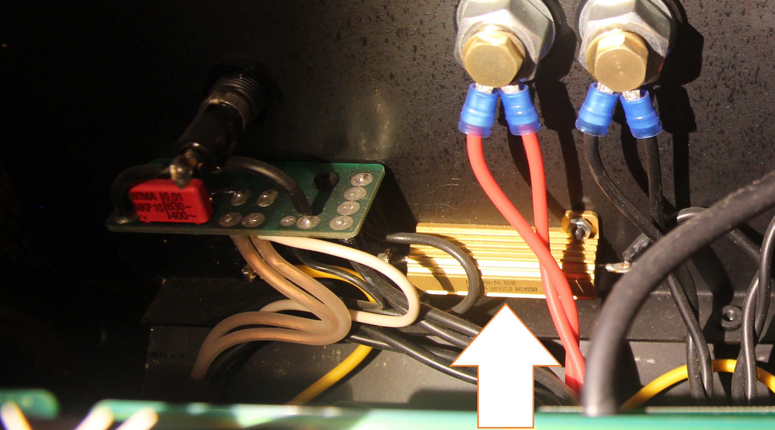

Thanks. I removed one side of the transformer and one side of the cap bank from each of the rectifiers to facilitate testing, and they seem to be OK. I'm going to order the replacement soft-start resistor from Digikey today, and get ready to reassemble it all again.
Well the amp is back together now.
After the unpleasantness I experienced last time, I was a little scared to press the power button. Much to my surprise, instead of smoke and explosions, this time the power light came on indicating regular operating mode. Previously the amp would pop into protection mode when first powered up, so this is definitely progress!

First off, congrats on the soft start resistor having saved your behind as hoped. 😉

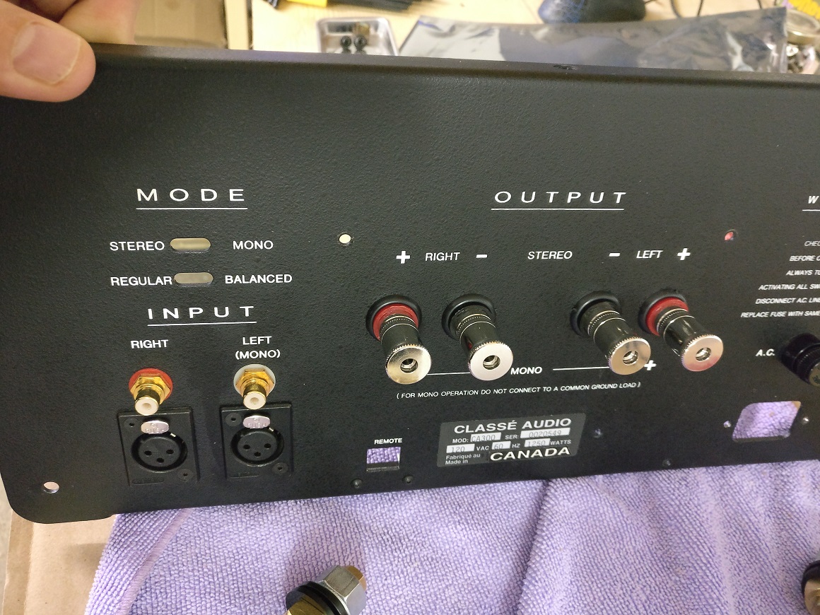

What I would definitely look at is how the XLR jack is wired up and where (or whether) signal ground connects to chassis - they might be joining at the back plate, not sure. (Chassis in turn connects to PE.) If they are joined as I suspect (that's a big toroidal mains xfmr which does not appear to feature a shield winding, kinda hard to go floating with this), check routing of XLR pin 1. It should go to chassis as directly as possible and not wander off somewhere else along the signal path first. Older designs often get that wrong and have compromised input common-mode rejection as a result, potentially allowing shield currents to get into the audio.

I don't see any place where the ground is connected the chassis, at least not anywhere around the input board or connectors.
Well, what does the multimeter have to say on this?

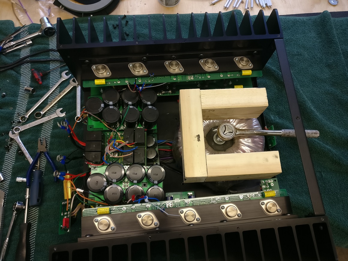

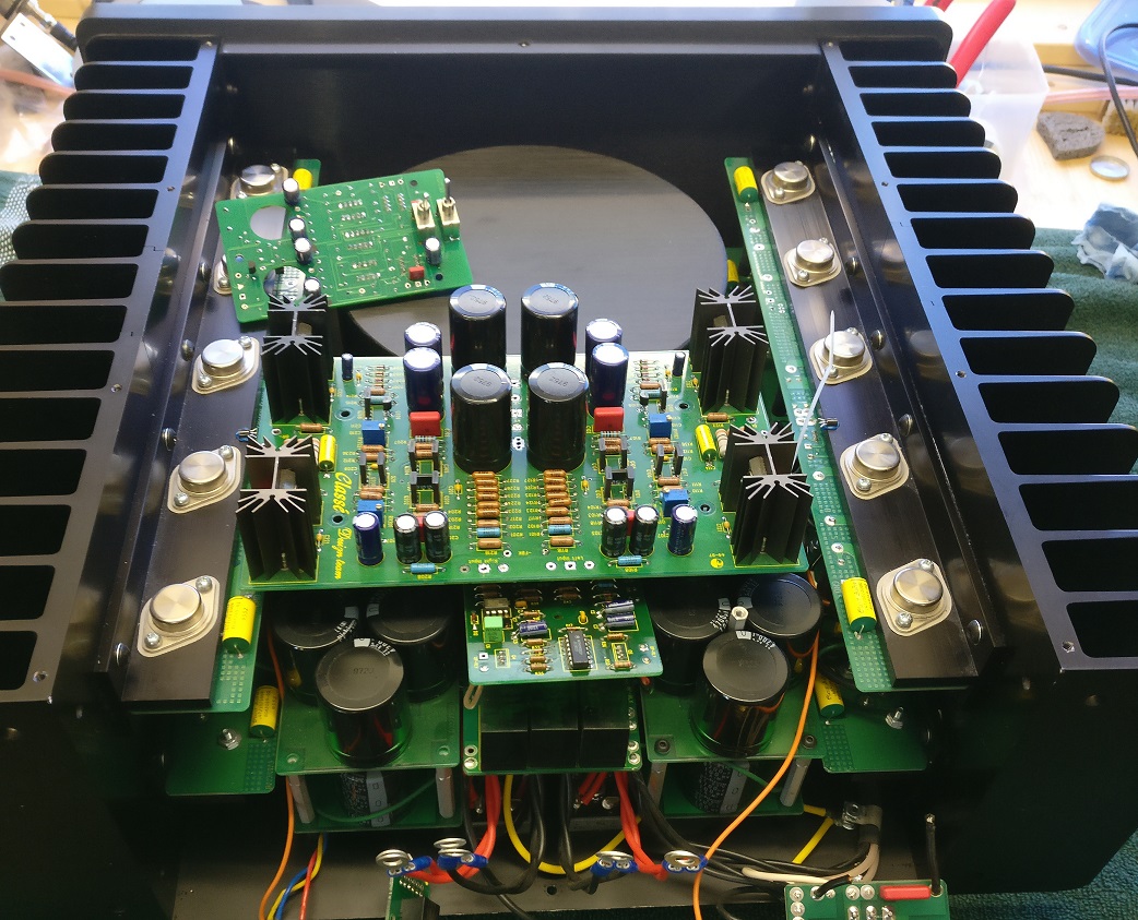

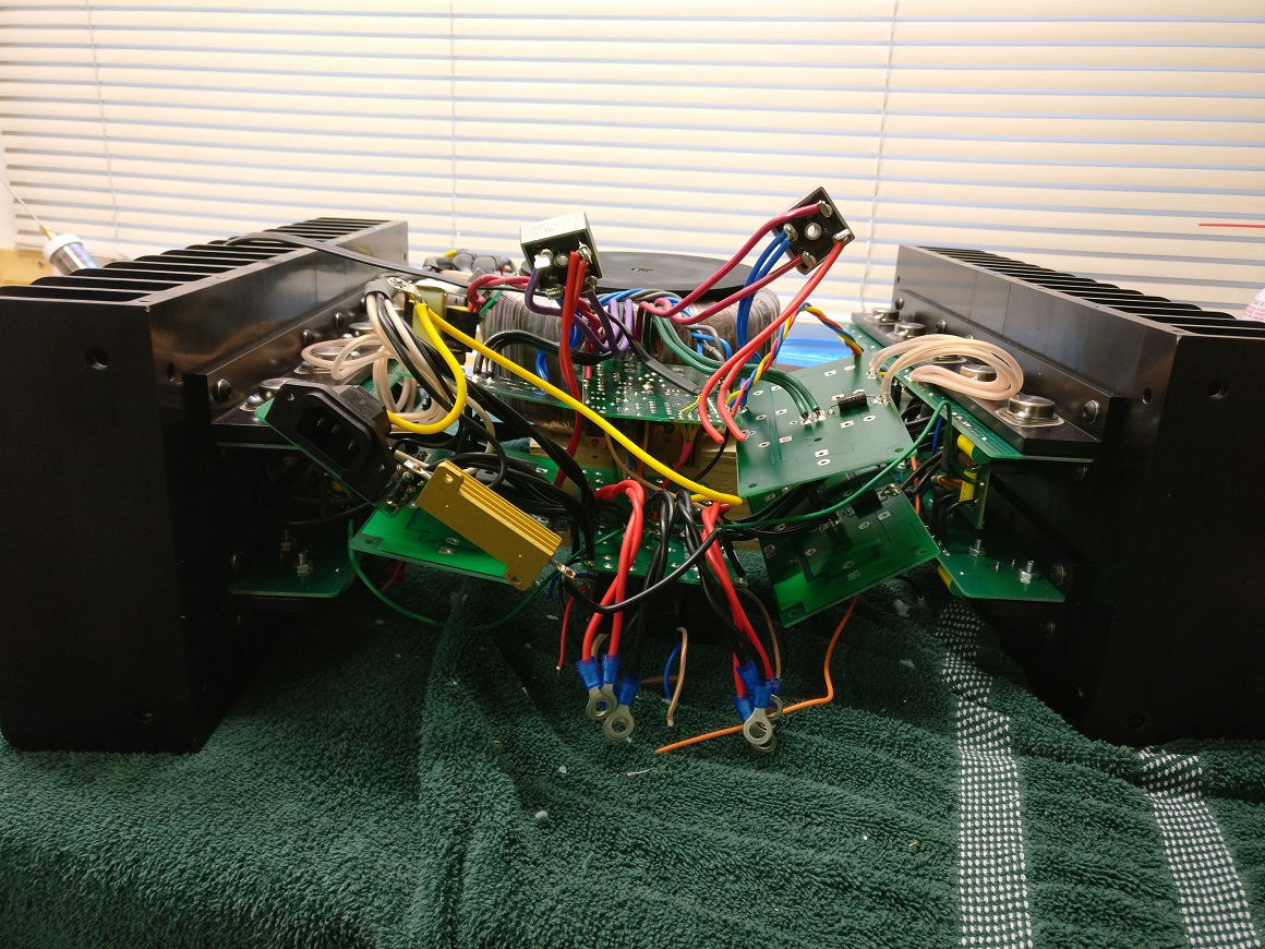

The circuit board traces on this amp are very fragile and easily lifted. The boards LOOK good but they're actually cheap, made with the lightest grade of copper traces. Despite being very careful I'm going to have do do some trace repairs on the preamp board. No big deal.
It was obviously assembled upside down. Looks neat, but major servicing is clearly a pain. And I'm not the type to complain about those things. Not usually, anyway.

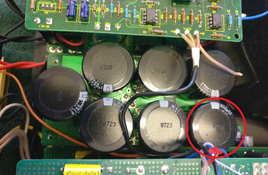

Any hum or extra noises being made by an amp like this is a warning sign of trouble brewing. The caps have begun to fail. Things have not yet reached the point at which damage will cascade. But if left unattended to, it WILL get there.

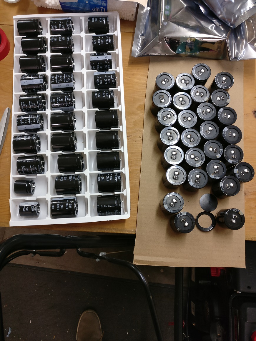

The last parts for me to rebuild this CA-400 have arrived.

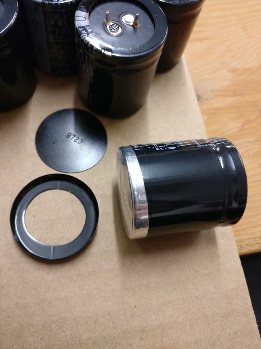

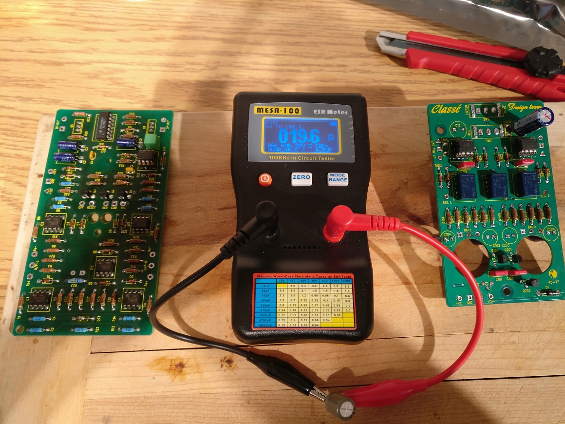

A full 30 percent of the caps in the amp have leaked to some extent. Nearly all of them show degraded electrical performance. (Leakage/loss, ESR, capacitance)
I'm replacing every cap in the amp with not less than 5000 hour 105c rated caps except in those cases where a high spec cap like that is not available. I still do the best I can.

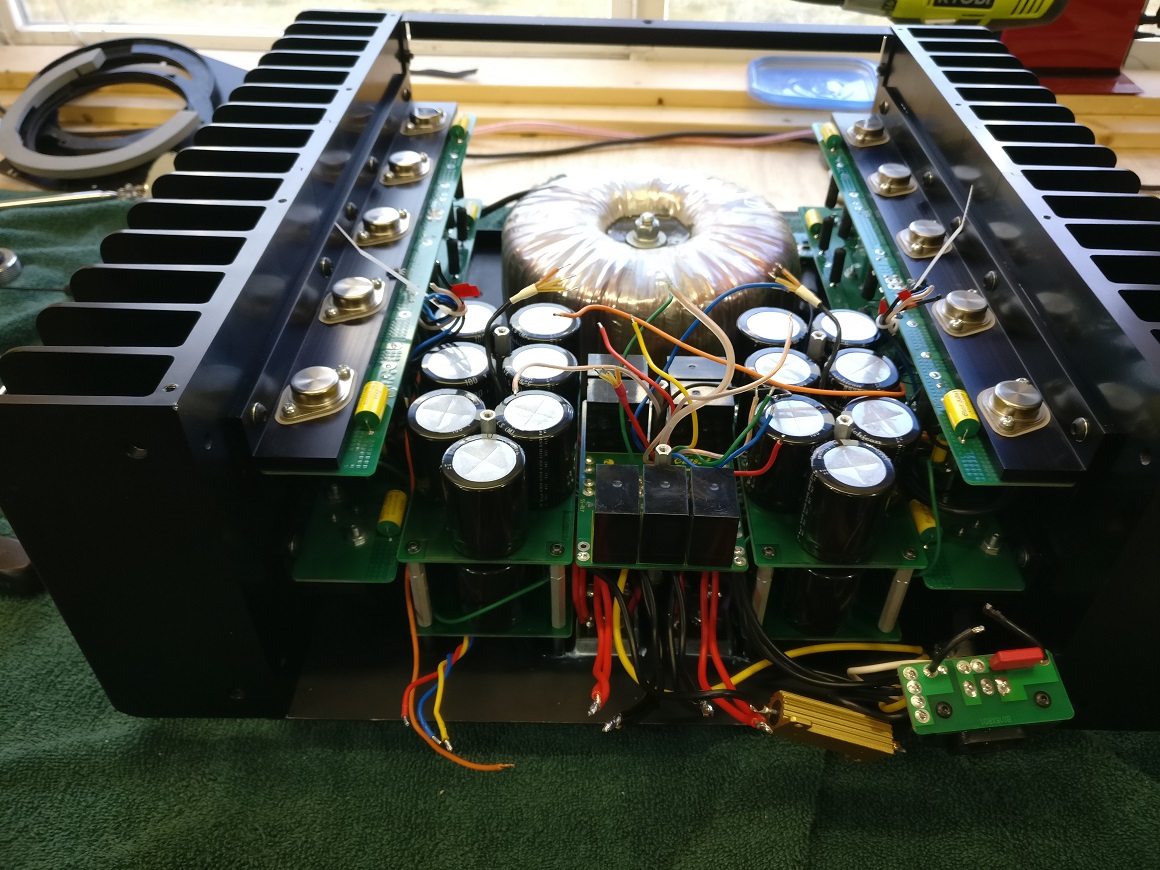

HOPEFULLY I'll complete this rebuild over the weekend.
I'm seriously considering powering it up with most of the output devices removed for safety. That way if there should be a serious assembly error it won't take out 24 output devices at once.
Yes, I was super careful about the cap orientation on all four cap boards. In fact I kept the cap boards wired into the circuitry all along. That made cap replacement a bit of a mechanical challenge but it's best not to disturb wiring harnesses any more than necessary. Moving things around a little isn't half as bad as taking the whole rat's nest apart one wire at a time.
