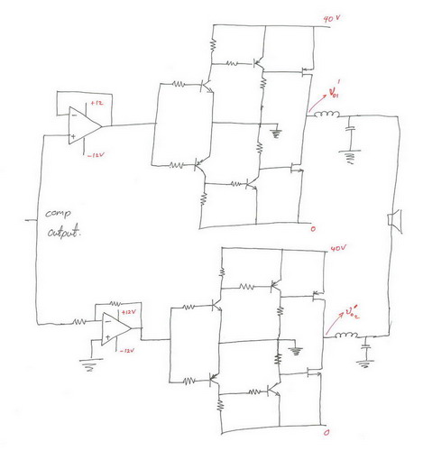

Hello Friends,
I have a problem.
I used http://users.ece.gatech.edu/~mleach/ece4435/f01/ClassD2.pdf
to design subwoofer bridge amplifier.
I used TL084 & IRF9540,540.
Used BC557&547 between OPamp & MOSFET.( eliminate for bipolar power supply ).
+/- 12 V & 45V used for power supply.
switching Frequency 30kHZ.
feed back freq abt 7.5KHz.
Used 2X150microH & 2X4.7microF for out put filter.
4.7microF in parallel with spk (10").
But amplifier cannot work well.
Input audiosiginal below 1V.
Traingle 3~4V.
Already check in Oscilloscope.
But spk output have +/- 1.5V P-P switching frequency exist.
for very small low frequency audio OK.
But increase volume it may occur blast sound.
So, what can I repair?
Components or Output Filter?
Sorry for my poor english.
Pls, advice me.
In myanmar component is very hard to find.
I wnat to know,
Speaker output must 0V or something switching voltage.
Is there anybody design with classd2.pdf?
My design of FET control circuit is right or wrong?
Which Op-amp must use for that design?
Pls, help me.

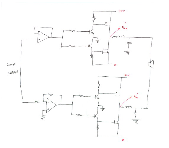

Your mosfet driver is WRONG. you have one fet with the gate voltage switching between 0v and ground!! The other FET will have a limited current switching it on due to the resistor.
Each fet needs a push pull supply to allow fast switching. But with the design there i am shocked that you even have a output at all!
Hello Friend,
It is my new design.
But i tested already in old design.
Old design has a problem.
That is, two fet will be on when, no input switching signal.
So, I changed that design to new.
I will test the new design within 2weeks.
Pls, help me for new design.

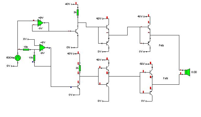

sorry mate but your next circuit isnt going to work either!
Heres the basic principal and i mean realy basic. It does not take into account dead time and has no filter. This will only work if the output of the osscilator is dual rail centered around 0v.
And a switching frequency that low will cause serious problems when trying to filter it out!
Good luck!

Hi friend,
Input 500Hz means audio frequency or switching frequency?
Can you explain for your design?
What i need to learn?
Help me.
Because I am a starter.
I attached pdf.
In that pdf include FET control logic.
Can you design FET control logic for me?
Thanks.
  • classd2page4.pdf
Well im not designing the circuit for you but i will help you. My circuit is as simple as it can be. It has two identical power followers. One fed by a inverted input, the other by a non invering input. That then goes into a voltage follower which will increase the voltage fed into the input, this should be run off a power supply of about +-15V. As that is above the voltage that is needed to turn a mosfet fully on (i made a mistake putting +40v and 0v. That goes into a push pull follower that increases the current that can be fed into the gate of the FET. As gate capacitance cause fets to have a relitily low impenace at HF. That should also run off +_ 15v. That is then fed into the fets, one n type, one P type. So that One is on and the other is off at all times.
A filter is needed on the output of fets to prevent full power being used at all times. this is made using 1 or 2 inductors and capacitors. That feeds into a speaker.
