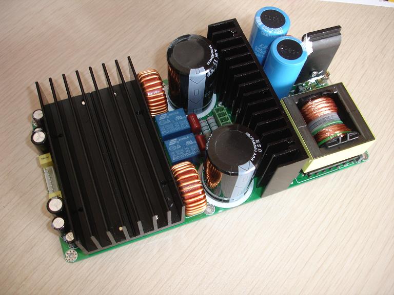

Ta3020v4
Long awaited TA3020 version 4 prototype ready, and soon will be available the first batch.
This version has the power supply and speaker protection on board.

V4 looks interesting.
