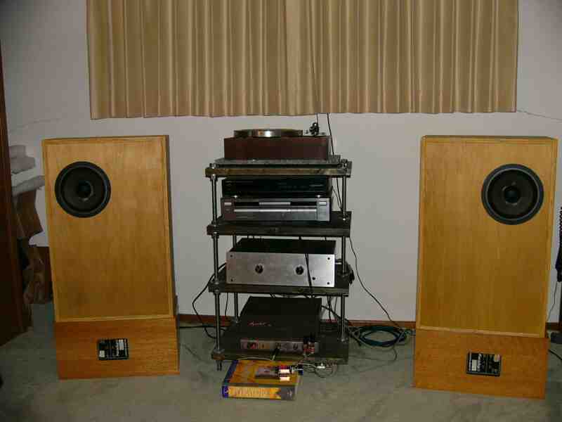

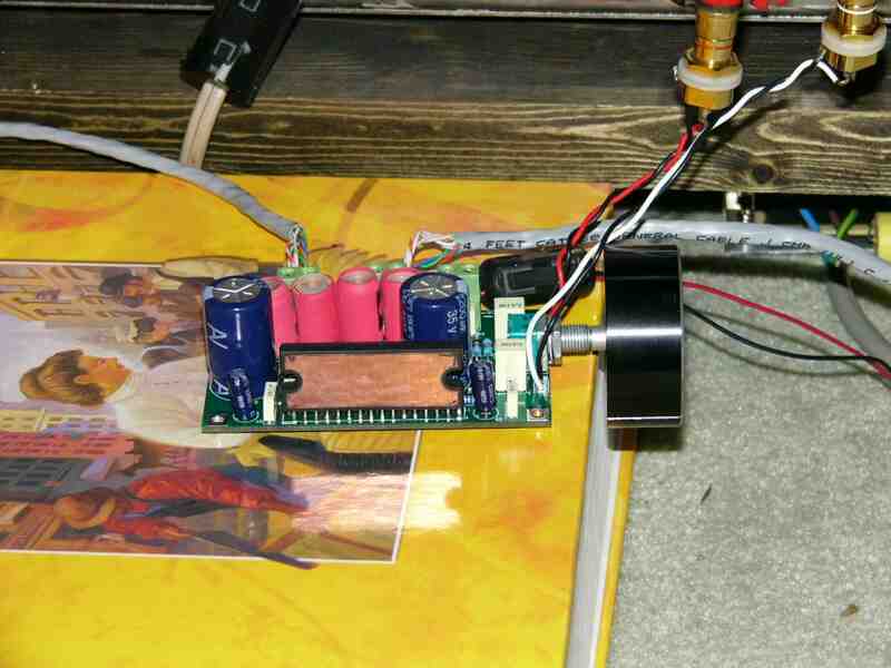

This thread got resurrected a bit off topic. So to bring it back on track, I received my TA2020 kit from Audioconstruire yesterday and had it built and running before bedtime. It's built as supplied (for now), with the .22 uf caps (8 ohm speaks) and including the 'optional' diode string and output Zobel network. Here it is in its naked glory:
The speaker wire is Cat 5 cable. I'm running the output from the CD player (JVC 1050TN, practically an antique now) straight into the 2020. Speakers are Hemp Acoustics FR8's in vented boxes.
So how's it sound? Pretty good overall! Bass is tight and well controlled, highs are smooth, not grainy. I don't quite hear the level of detail that I get from my tube amp (Dyna ST70, with Joe Curcio's input board and regulated PS), hall ambience is not as readliy apparent. But, the 2020 has only a few hours on it, and is sure to improve with time (and some judicious parts upgrades). For the cost, I'm satisfied.
Here's a pic of the whole system. The amp pretty much disappears at this scale! You can see the reflection from the back of the Tripath chip on the book in front of the Flexi rack. The knob on the vloume pot is nearly as big as the whole amp.
