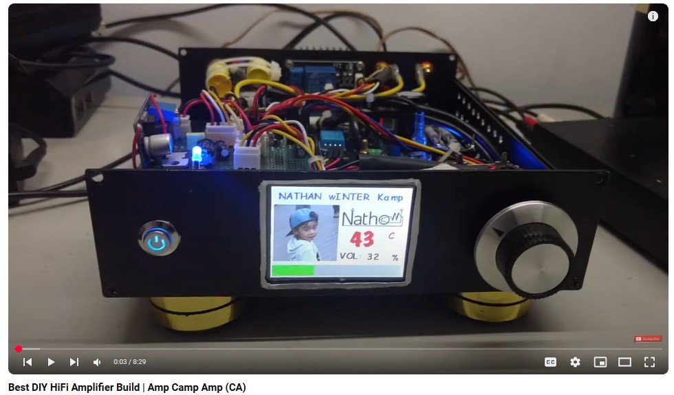

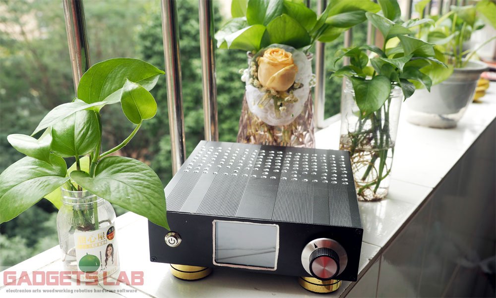

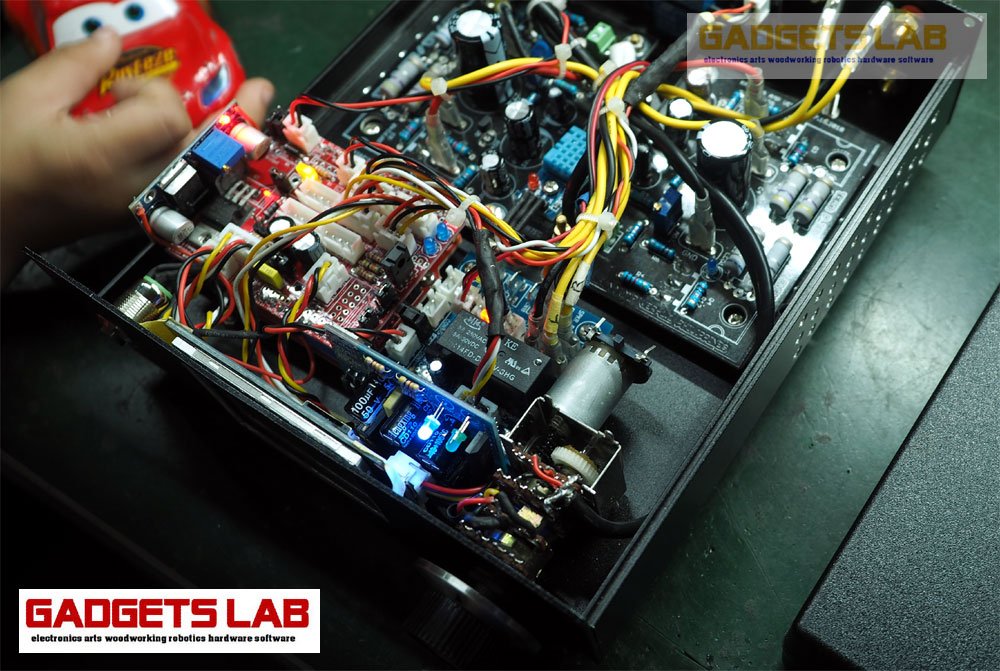

ACA, rename to Nathan Winter KAmp, achieved less heatsink using a digital brain (AMPduino-A3CS) to control the analog heart (ACA) on 18x30x5 cm aluminum casing. I have been demo'ing this in the Manila Mini Maker Faire and also in the Arduino day. I have a video of it,,
1. design philosopy
2. mechanical design revolution
3. the use of digital intelligent controller
4. lots of testing, here and there
5. HMI - Human Machine Interface
6. -- served as inspiration to my fellow DIYer's (in the Philippines)
let me just ask if its OK to share the link.

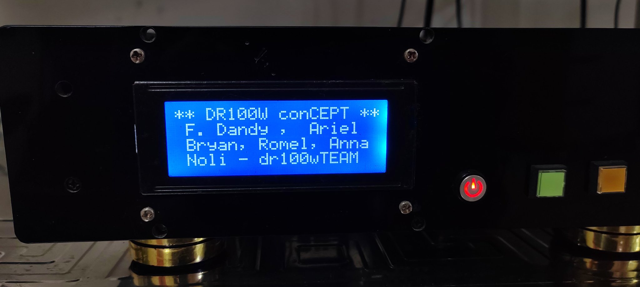

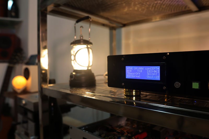

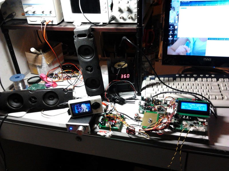

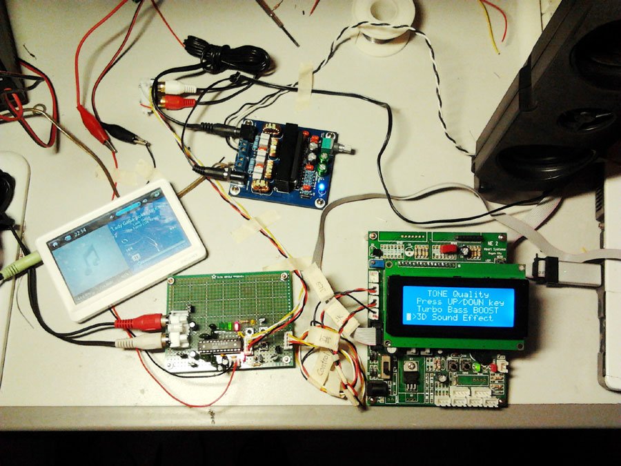

Class-D -- I called it DR100W concept project, comes with different boards
1. dr100w-PA, TDA8920BTH / TDA8950TH class d amplifier
2. dr100w-EQ TDA7449 for the tone control, PT2389 preset EQ
3. dr100w-CM controller 8051 uC STC90C516 RD+ program using BASCOM 8051
4. dr100w-PSU SMPS (ready made , +/- 32 Vdd)
5. black fiber glass casing
was mean for learning class d. I dedicated a bunch of videos on YT to teach how this amplifier done specially on the software side -- shareware and courseware!

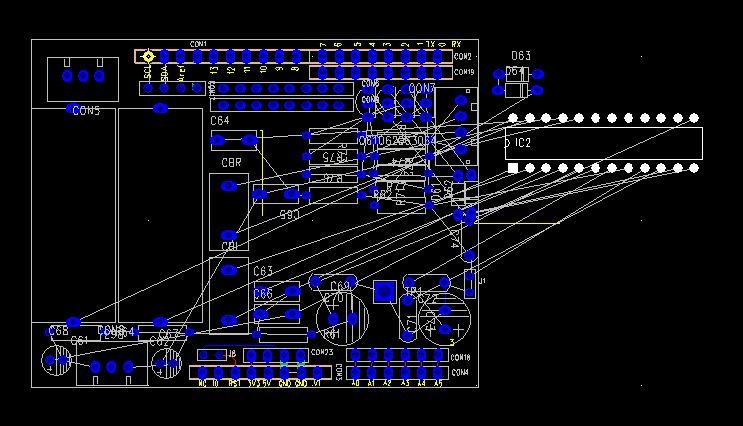

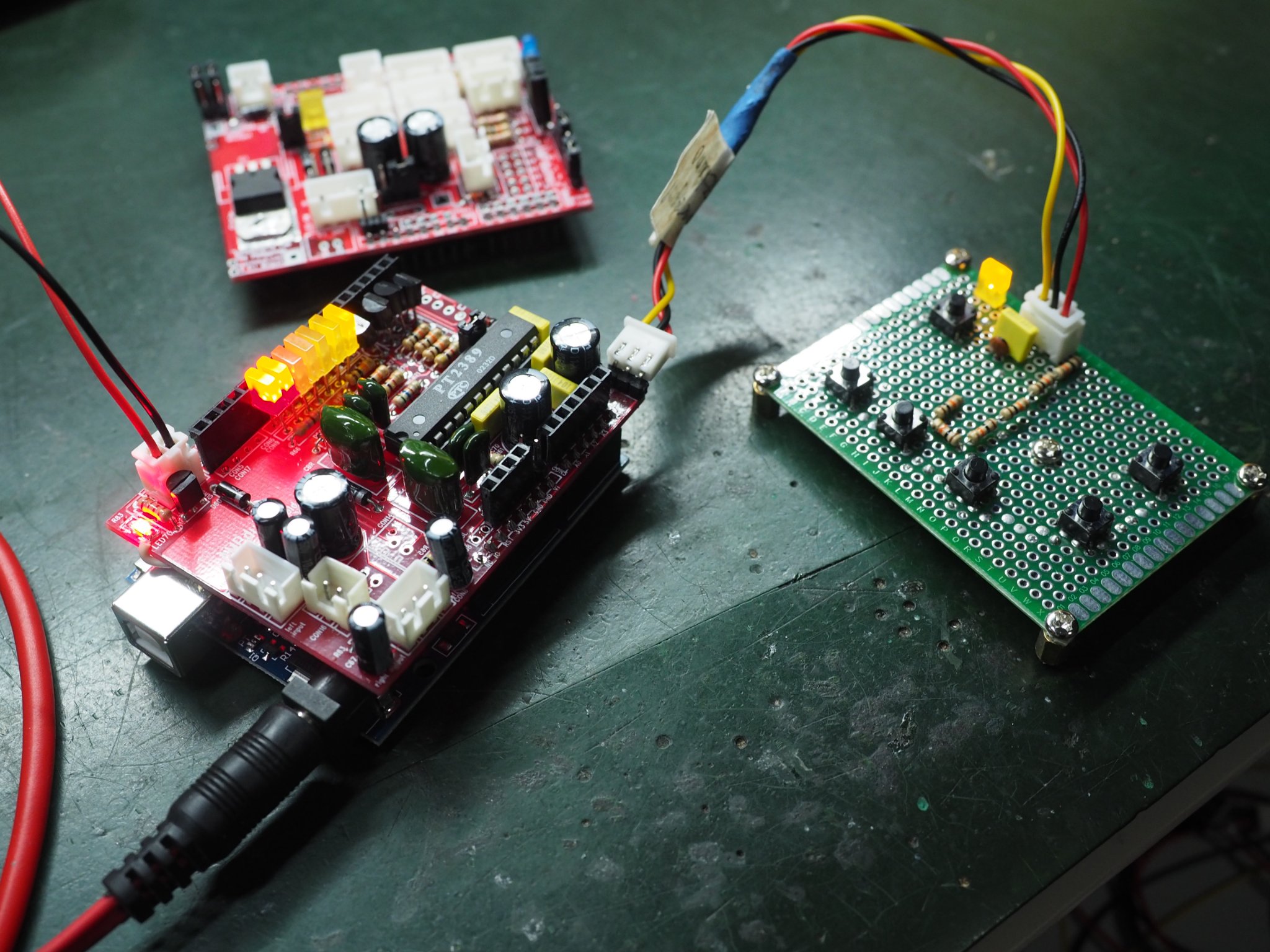

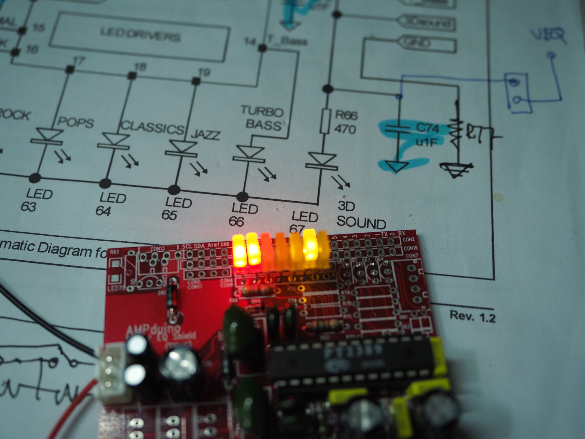

Hello, I have this project also name - AMPduino, but its broad application (to me), its in the form factor of Arduino Uno. what I have here is the AMPduino-PeQS, it means Preset EQ based on the PT2389. Other shield were developed and put into action. My overall aim is to create a stackable shield and end up in building a personal musicmate, hence there is also the AMPduino-myMUSICmate.
