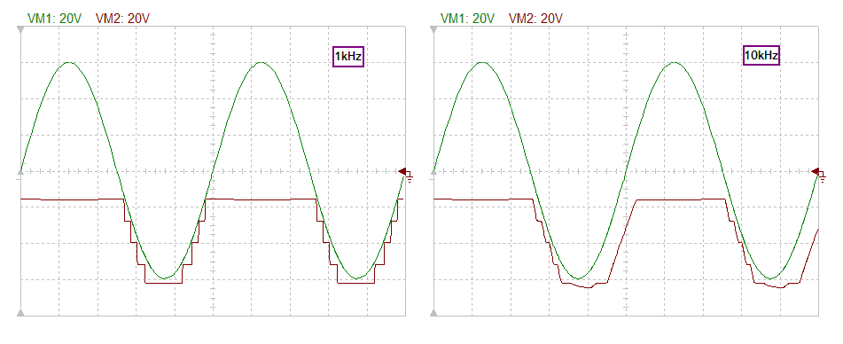

There are some differences when the mosfet turned on. The simplest one the mosfet just switched on when comparator say "go", and amplifier supply voltage increasing to the higher rail as fast as possible. The other one, there is a slew limiter so the voltage increases with limited speed/slew. Some other with early switch on and off with slew limiter.

Supply voltage only switched at output stage, and VAS always connected to highest rail, and opposite mosfet stay off when a rail switched.
This is a multi step classH with slew limiter and early on/off for high speed operation (around 10kHz). Also higher voltage margin for higher step, because OPS has more drop voltage when draw more current.
