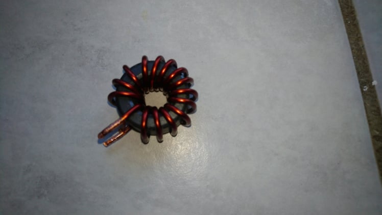

I tried to make my own output coil.
Hmm..... 14 windings = 112 uH 😕
That means that 22 uH are 3 windings
with 3 turns yielding 22uH it is evident your toroid is ungapped ferrite - the wrongest possible choice I can imagine for this application.
I see.There exist gapped ferrite toroids as well. For lowest distortion gapped ferrite outperforms any metal powder imho. As a DIY solution I would prefer some gapped ferrite pot core.
For lowest THD with TPA3251 amps I use the biggest ferrite cores with saturation beyond 20amps. This makes - at least measurable - a difference.

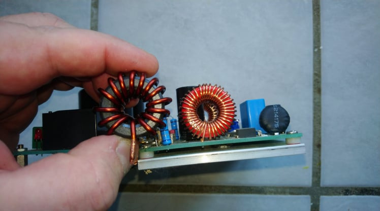

I have now tried with a thinner copper wire, about half the thickness, but the value is still far too high.
I think it is the core itself that is too big / powerful.

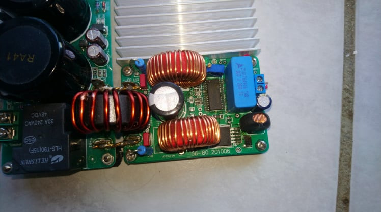

Will it make any sense to wind a coil like the ones in the picture, but on plastic, wood or something non-magnetic?
That kind of air coil?

I do not see any relationship between wire thickness and inductance. It is true aircoils do not saturate, but that is only one aspect. Without a core, you get a maximum of turns required. Maybe something in the ballpark of 100 turns. Thus a coreless toroid requires a lot of copper, otherwise DC resistance would be inacceptable. And without a core magnetic leaking flux would be considerably bigger.
There is a reason that air coil output inductors are rare birds in reality, sometimes appearing in boutique amps.
Sorry but no, inductance is proportional to the square of turns count.I tried to make my own output coil.
That means that 22 uH are 3 windings![]()
So for 22uH : 6.2 turns=6 turns, not 3
And wire thickness is not an inductance parameter, only wire turns, check my suggestion.
Yes ok, but if it's 3 or 6 it's not enough at all. I think the core is too powerful, too big or something else
Didn´t you need 22uH?
That takes 6 turns, like it or not.
It´s your money, of course, still not sure why not unwind 8 turns from an inductor you already have and spend $38 instead.
Again, to each his own.
I have been told that 8 windings are too few and there will be large radiating from the coil because the windings are not close all the way around
No, you have been told that you have used the wrong core. You are immune to advice, I am out here.
