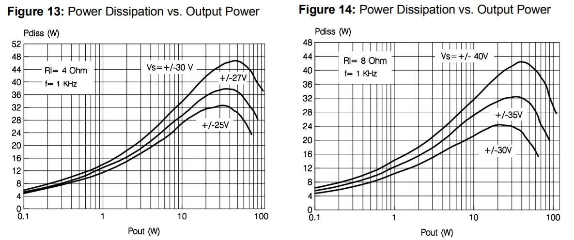

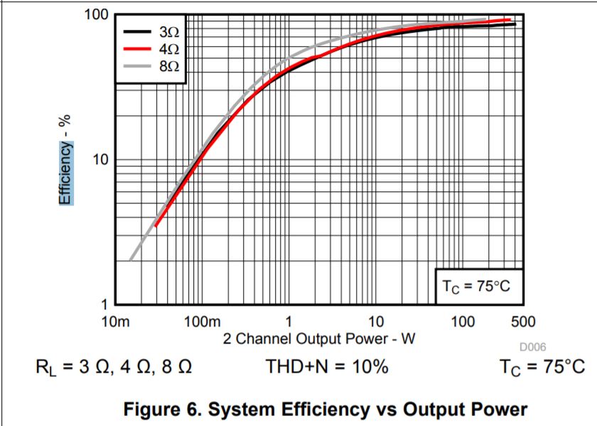

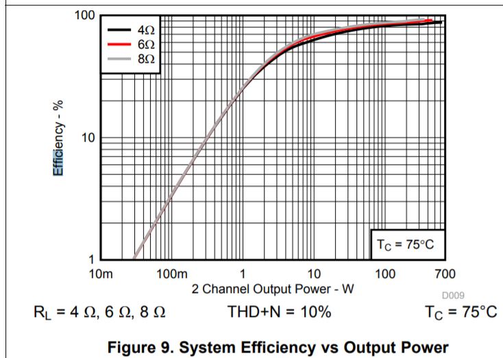

efficiencY of AB amps vs Class D amps
Hi
according tot that sheets both are not very sufficient for less power😉
TDA7294 e.g. 4R 12Watt dissapation but 1 Watt ouput power at 27V rail --> e = Pout/ Pin = 1/12 = 0,08
TPA3251
TPA3255

How do you else heat your living-room in the cold winter evenings (no Stroh rum)?😛
Chris, if you calculate the efficiency of a TPA3255 at 1W out when you include idle losses, the calculation is not that pretty either. Let's hope nobody finds out that the big climate crooks are the DIYs.😱
