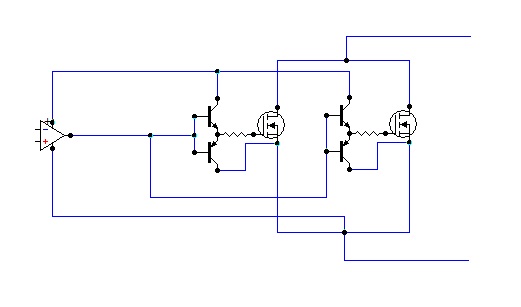

It is the source inductance IN THE GATE DRIVE LOOP that really matters because it provides necessary feedback during current slope. Keep source power path and gate drive path separate. SHould do.
Better to use separate buffer EF drivers for each mosfet with kelvin source contacts and the gate driver return must be routed to common route access to all source terminals such as -Ve rail or switching node while keeping the source traces symmetric and get rid of unwanted voltage drops due to parasitic inductance. This scheme works well for me.
Hi Kanvar,
your arrangement is making sense to me and your comment of keeping the source traces symmetric is exactly the point I was waiting for, when asking for a specific layout.
But I do not think that you generally get rid of parasitic inductive voltage drops.
Your arrangement is forming a well defined di/dt limiter.
di/dt is defined by the geometry of your symmetric source traces, lead inductance of the MosFet package (again source), treshold voltage and Rds vs Ugs charakteristic of the MosFet and the driver supply voltage.
Hi Choco,
Voltage drops are always there due to unavoidable parasitics but one can balance out the effect if the traces are similar enough to minimize the imbalance in voltage drops. The unwanted imbalance in voltage drop leads to drastic change in conduction of current between paralleled devices.
...fully agree. The remaining downside in paralleling like proposed by darkfenritz or like you , is that there is one parameter more to be handled when doing the layout, but of course possible.
My personal taste is to stay without paralleling as long as I get a strong enough device in the TO220 package.
TO247 is much less convenient for fast switching and for snubbering (played around with IRFP4668). Consequently paralleling devices appears attractive to me in designs where a single TO220 will not be sufficient anymore.
Another way to mitigate the inductance problem is to intentionally add some one-way-inductive snubber and get very low and well controlled di/dt.
The inductor must be coupled to another inductor, which releases the energy back to rail in a flyback converter style.
