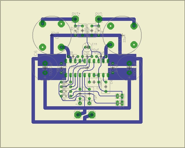

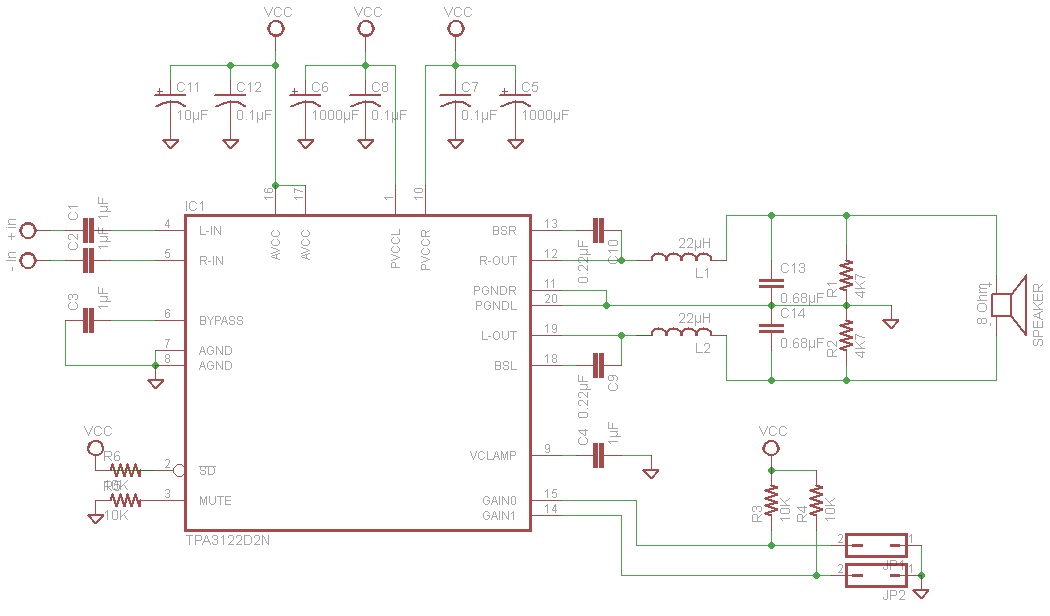

I thought I would try out a class D amplifier, but like many on here, I'm not too fond of the idea of surface mount components. I may get into them at some point, but I thought I would at least try a prototype Class D based on the TPA3122D2 20pin DIP. I want to try to keep this simple, so single sided PCB and no surface mount components. I have the chip configured for BTL into 8 Ohm speaker, I will supply differential inputs. The schematic is directly out of the datasheet, except I used 1000uF capacitors instead of 470uF, just because I have a box of them, and the datasheet says they should be 220uF or larger.
I went ahead and put pull up and pull down resistors on Shutdown and Mute, just so I can play around with them, but I will probably just hardwire mute... I may use shutdown.. it would be nice if I had a circuit that would detect the presence of a differential signal and turn on the amplifier, and keep it on for say 3 minutes after the signal is no longer detected. very easy to do with a single ended input with a transistor, I haven't quite figured out how to do it with differential inputs without using an opamp... although I guess an opamp for this purpose would not be all that bad... but then of course the opamp will need to be powered to be able to detect the signal. I'm just trying to keep it simple and small. Anyone have any ideas on how to have automatic power up and shutdown based on the presence of a differential signal? I don't want to UN-balance the differential feed with it, and would like it to be very high impedance.
Here's the schematic and preliminary circuit board. I ordered my parts and will probably breadboard it first. Any advice on this would be appreciated.

Start again.
Tracks are way to thin, component plaqcement requires optimising. The high switching currents require proper planes.
In fact follow the layout in this app note:
http://www.ti.com/lit/ug/slou214a/slou214a.pdf
component plaqcement requires optimising.http://www.ti.com/lit/ug/slou214a/slou214a.pdf
Can you please tell me what you mean by optimizing?
I was going off the datasheet which states that all the power supply and bypass capacitors should be as close to the device as possible, so I put them all right up against it, then made everything else fit.
Thanks for the link to the application note

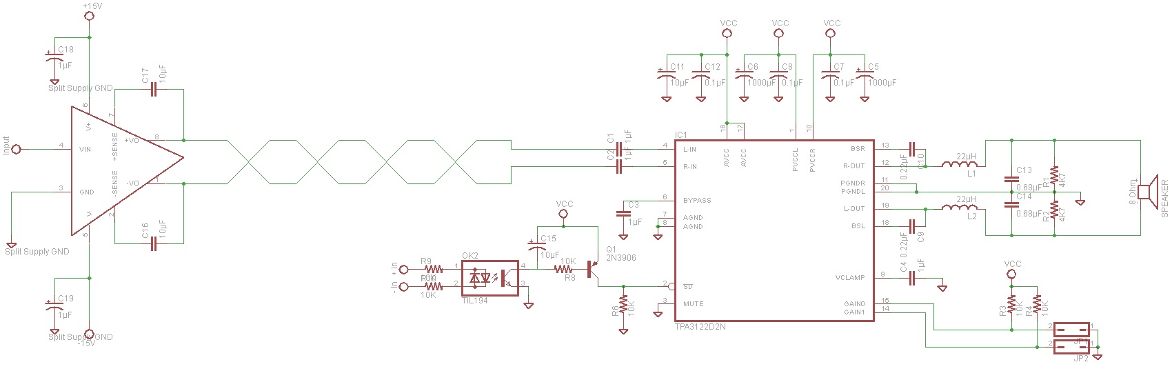

here is my schematic so far.. it has a second set of inputs which will use a remote power on signal to power up the amplifier using a photocoupler. I think I'm still going to need something on the input signal to make it work the way I want it to, but I have to start somewhere. I have 3 ideas for circuit boards, I am not sure what would be best. All these planes and current loops and such have me all confused, so I figured I would just post my ideas and hopefully someone with more experience than I have will be kind enough to offer me some advice. I will post them each in a separate message to make it more clear which description goes with which images. The board I am working on is just the TPA3122D2, the DRV134 will be another board at the opposite end of the cable.

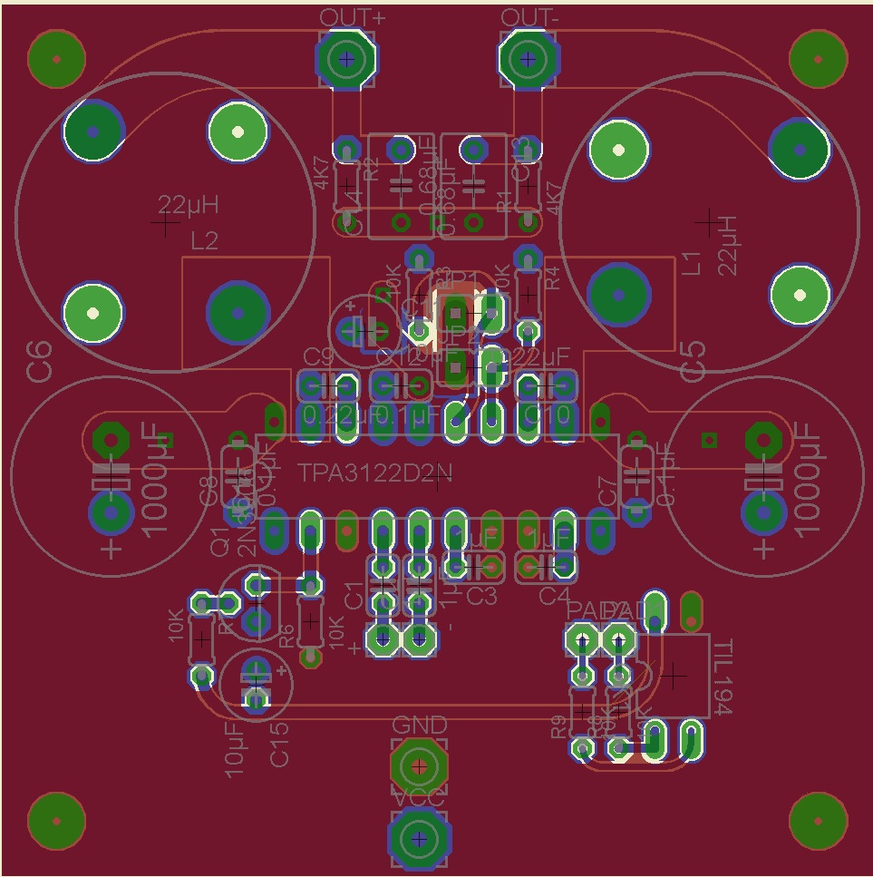

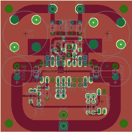

PCB #1
Here is my first possibility... Single sided, I moved everything around and got rid of the wires sneaking between the pins on the IC and also made all the traces a bit larger, kept everything as short as possible. I found some capacitors with 0.1" lead spacing so I could put them right up against the IC pins with no trouble. I also incorporated large ground and VCC planes. I will need a jumper wire to connect the interior gound plane

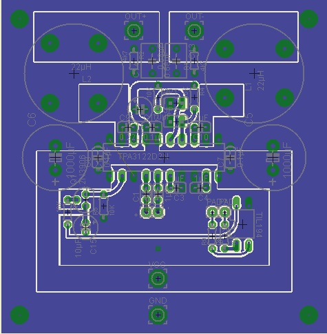

PCB #2
This one uses the solid ground plane on the top side of the board, bottom has no planes, just traces. I have some feed through holes to make it possible to solder the electrolytic caps to traces on the bottom of the board, yet still connect to the solid ground plane one top.

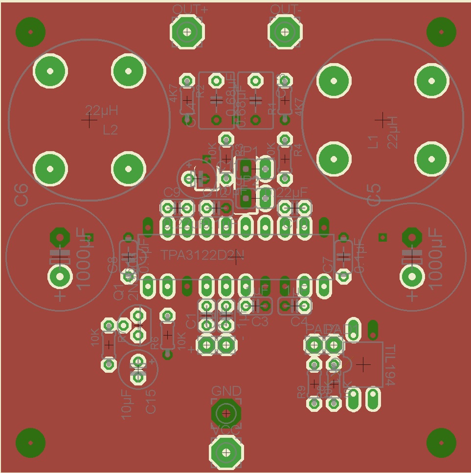

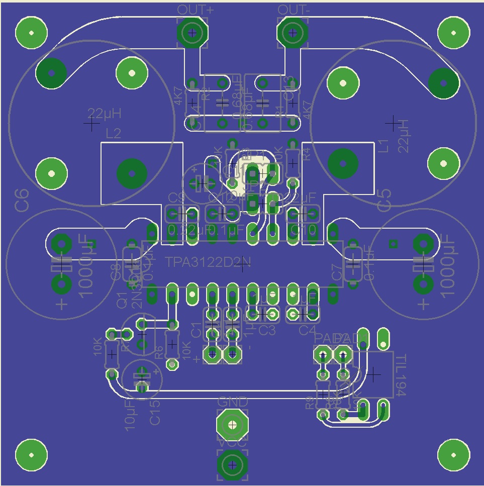

PCB #3
This one uses a solid ground plane on top, and a huge VCC plane on the bottom. it's hard to see whats going on so I am posting the top, bottom, and combined layouts
Its looking nice. When you compare them to your first design you can know see the difference, with the wider tracks and ground plane etc.
Looking good🙂
Looking good🙂
Thank you. Reading through those links on your switcher EMC thread helped a lot, although there sure is a LOT to learn! I am still not sure what would be best... Instinctively, it seems like PCB #3 would be best but I do not know if I am perhaps causing a problem with a ground plane on top and a VCC plane on the bottom.. I just had a 4th idea... perhaps use the design of PCB #1 with a solid ground plane on top.. the difference being there would also be quite a large amount of ground plane on the bottom as well, not just VCC on the bottom. any input on which of these latests designs would be better?

Im at work at the moment, I'll have a closer look at the boards late. But from a quick look, probably all will work. Following the EMC stuff is the best way of learning how to lay out switching designs (as they are , or can be if not laid out correctly, one of the main causes of EMC noise, which will affect your circuit as well as that is the nearest to the noise, so you learn best practice by looking at the problems and desiging them out.
