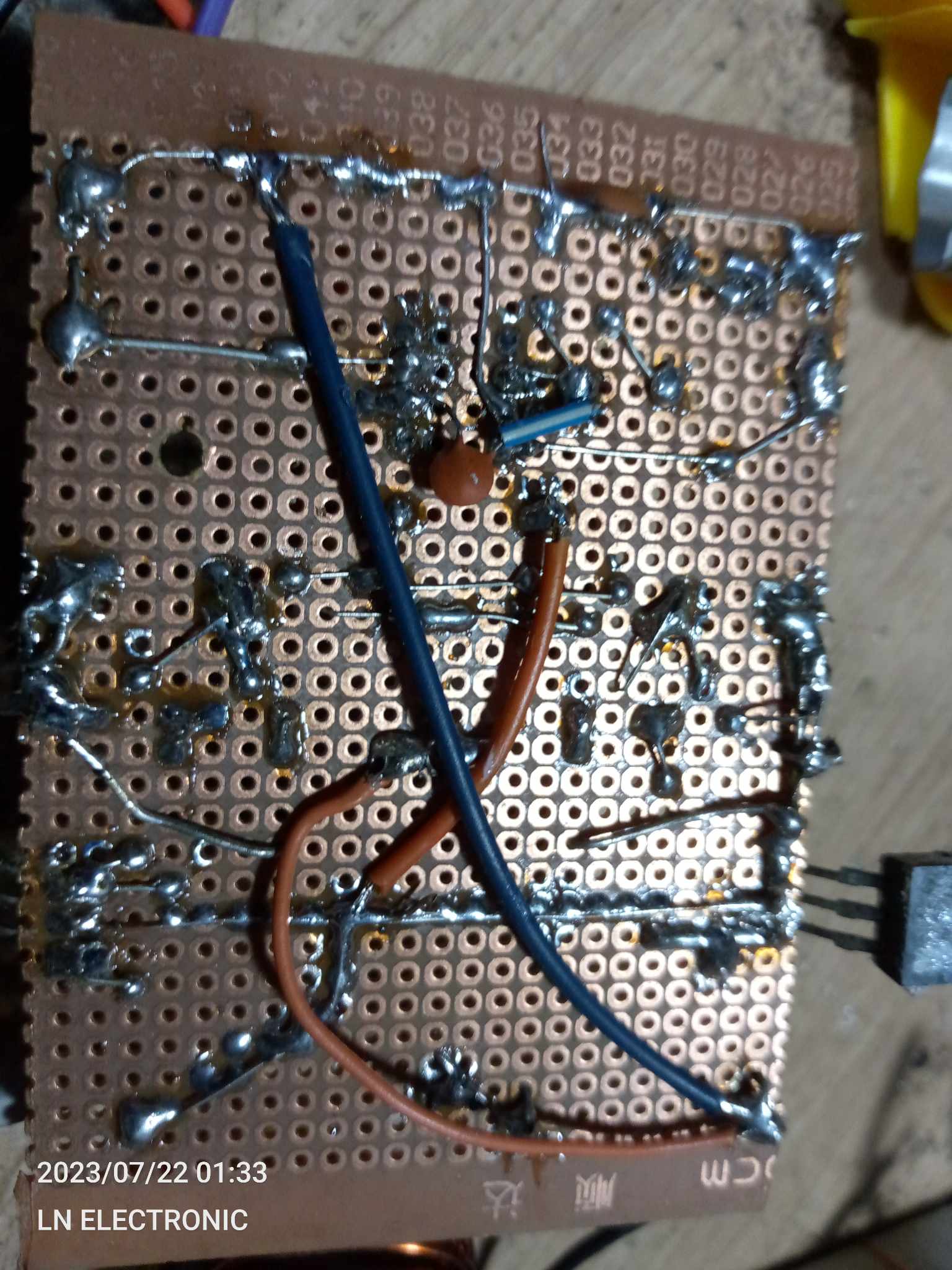

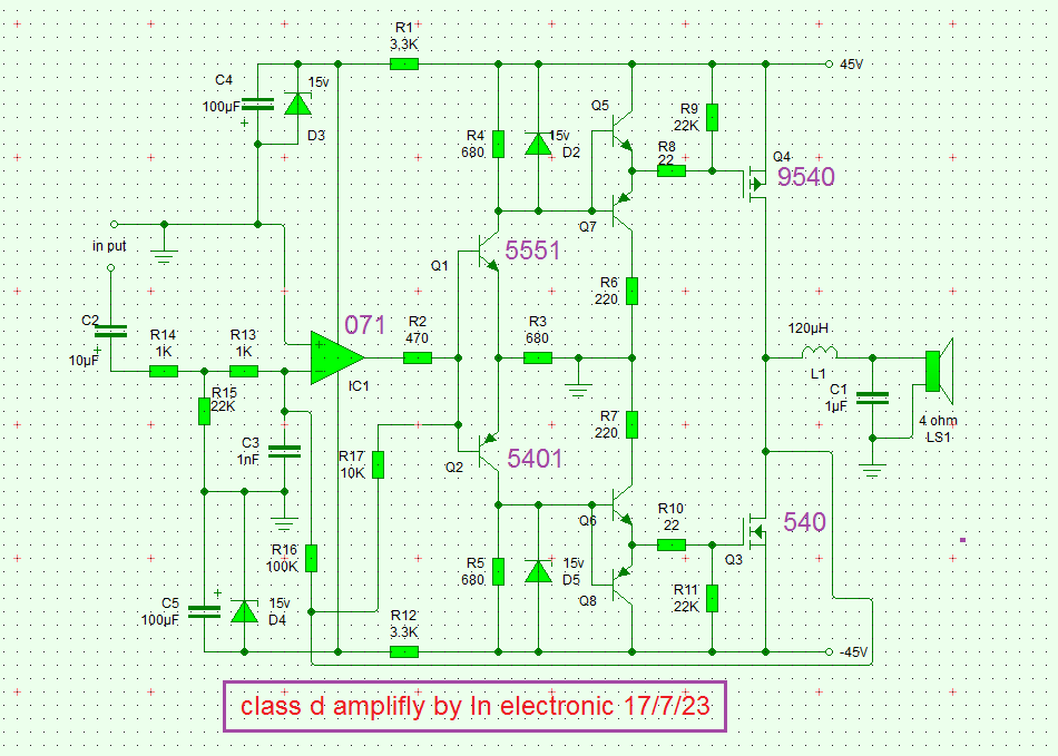

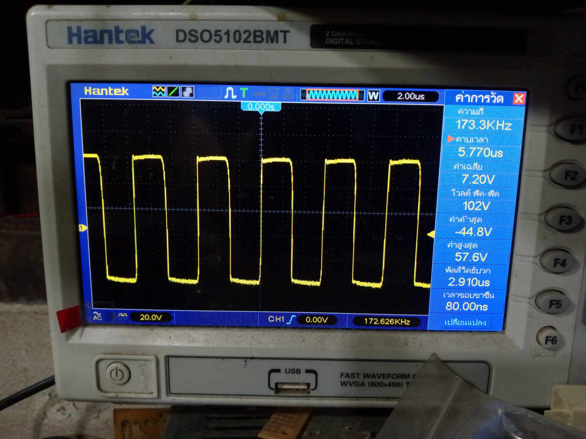

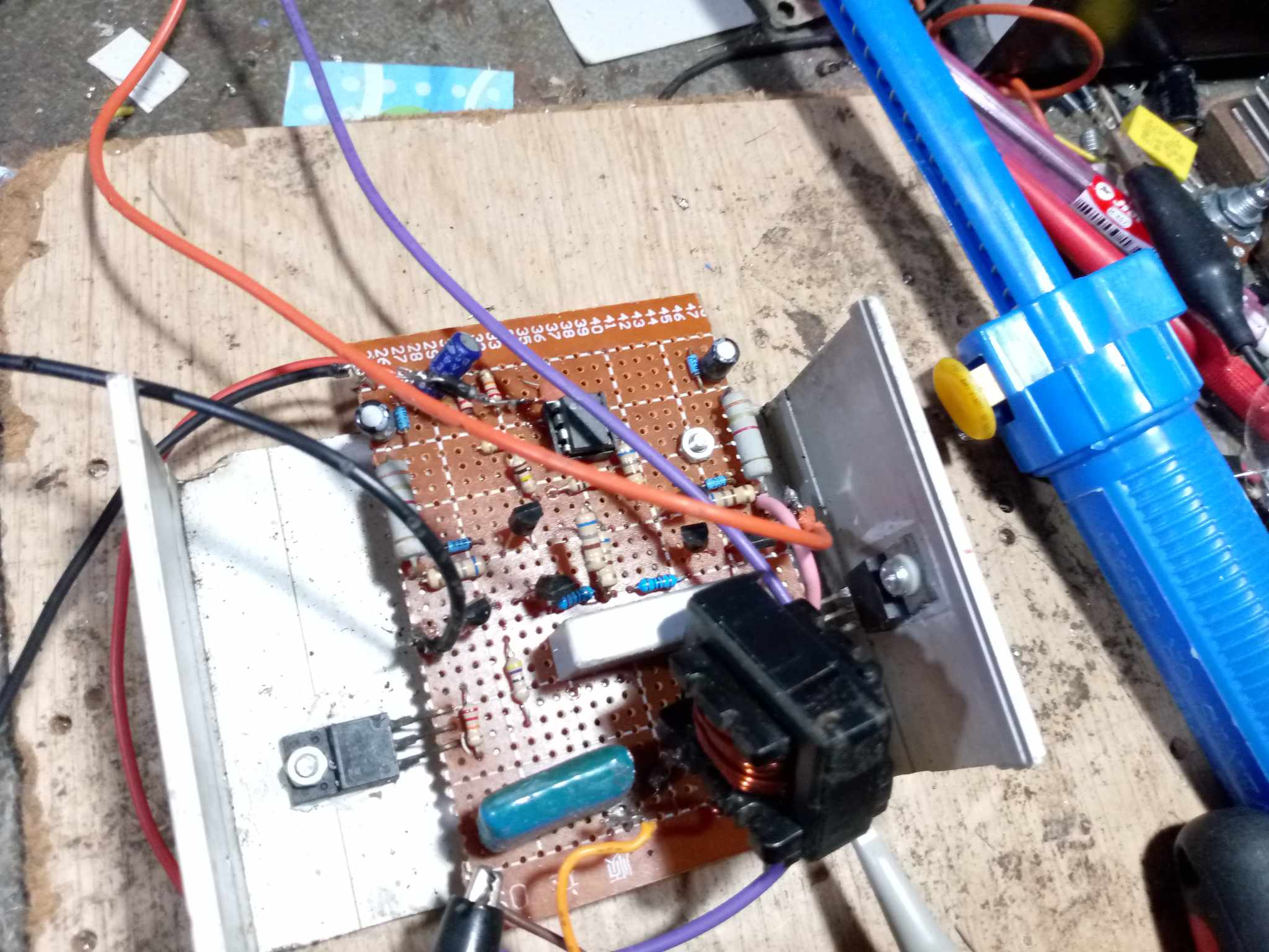

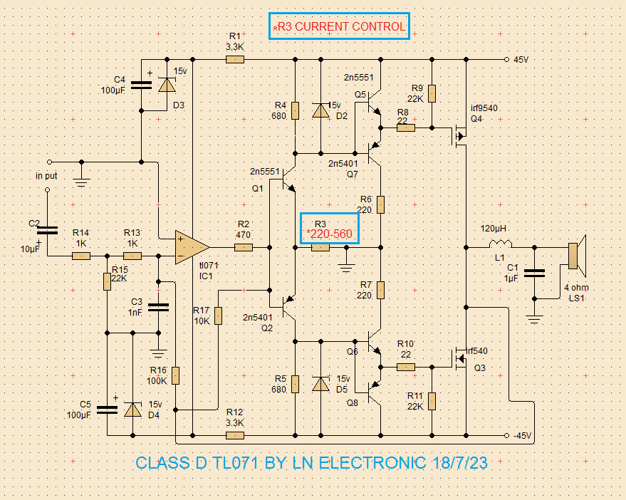

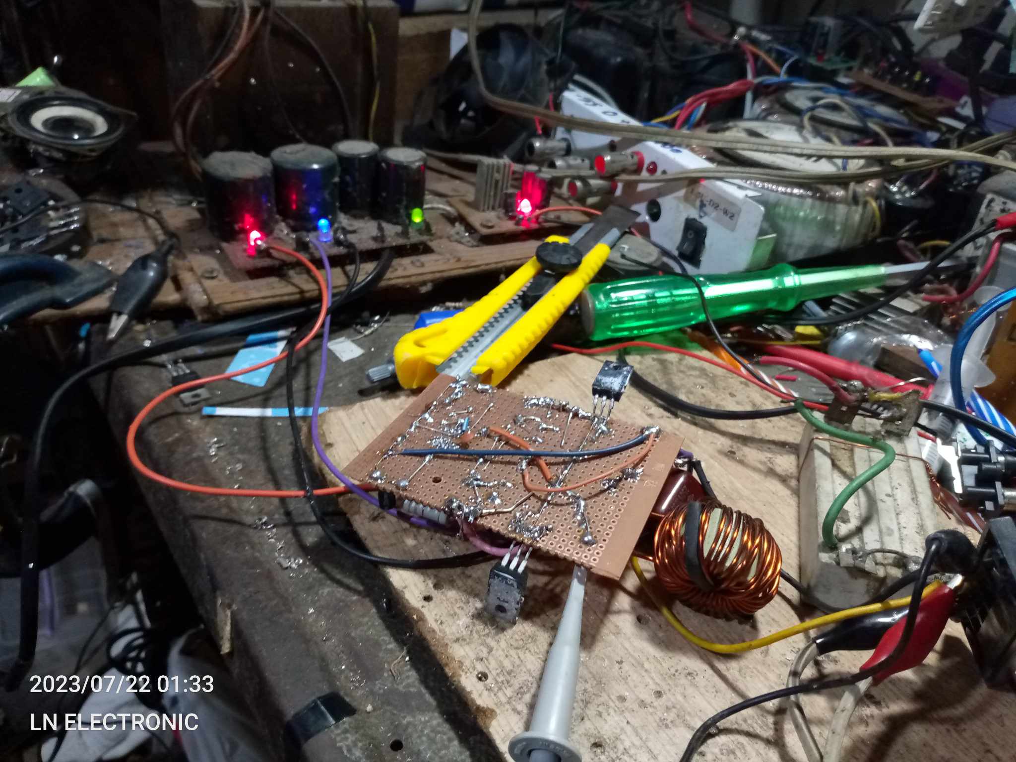

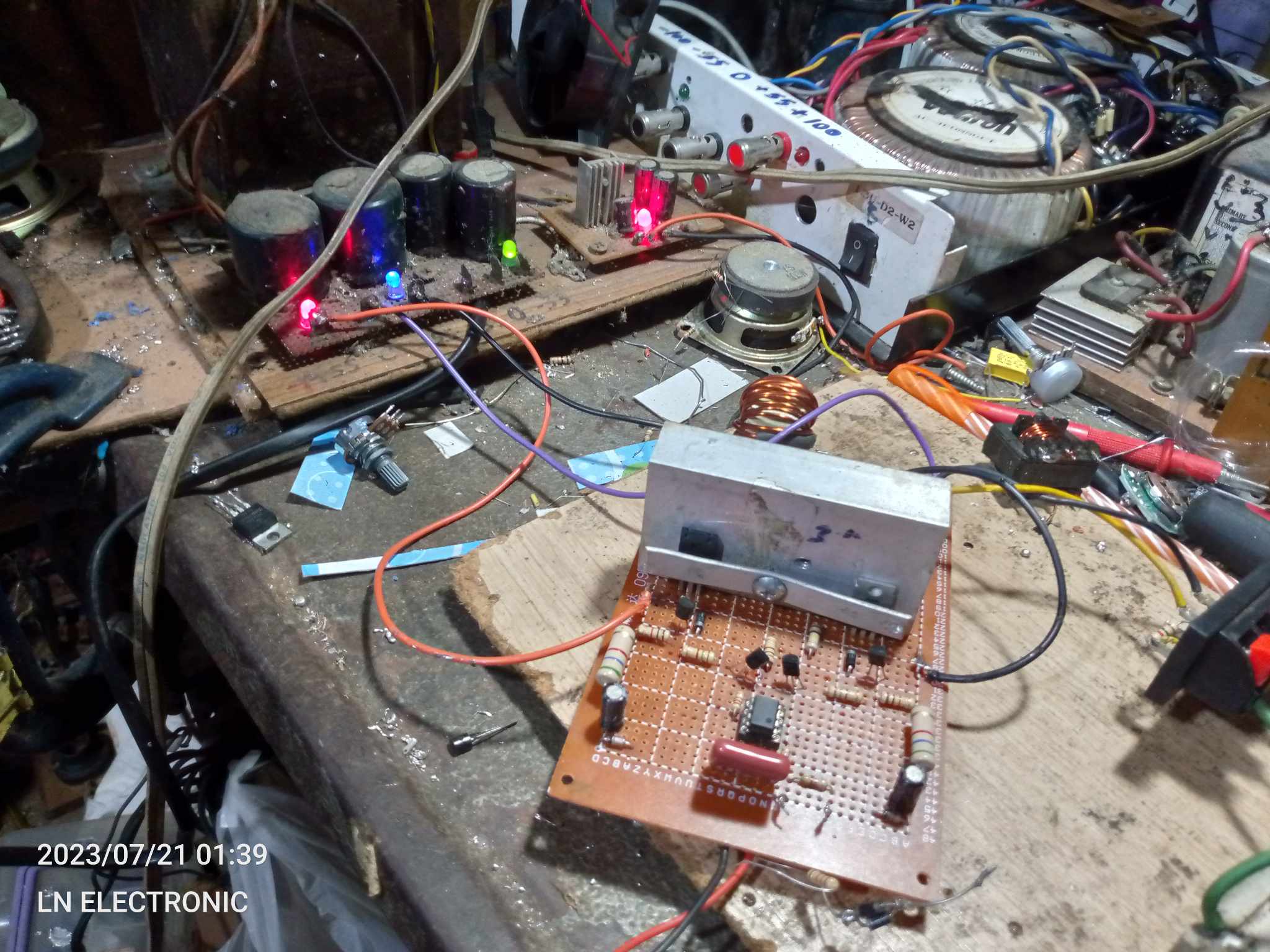

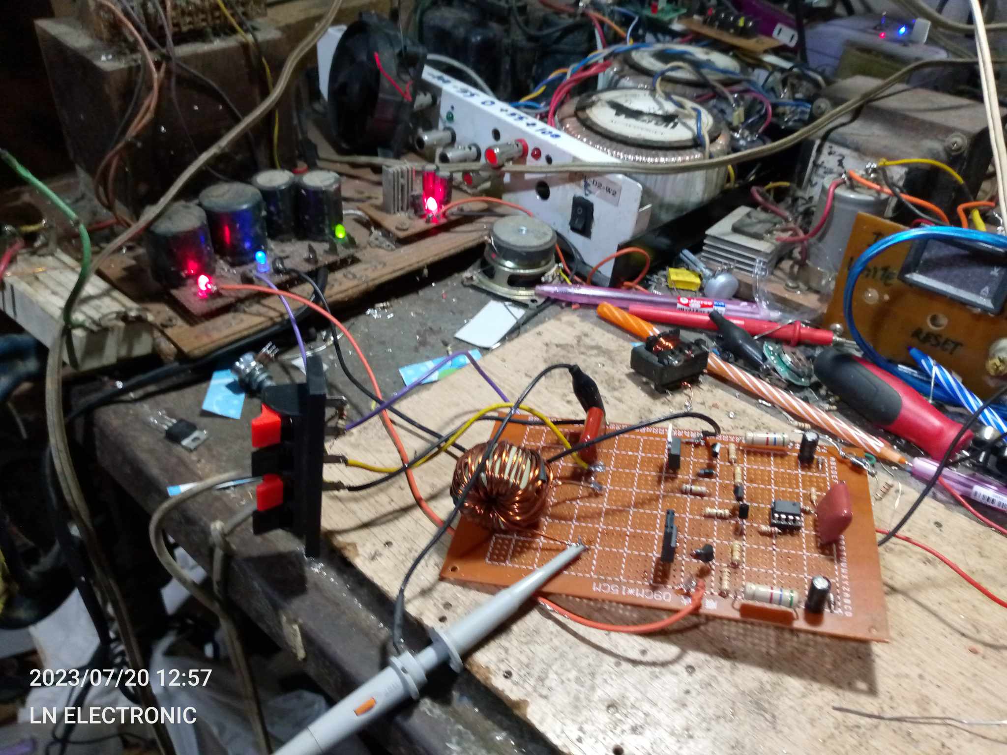

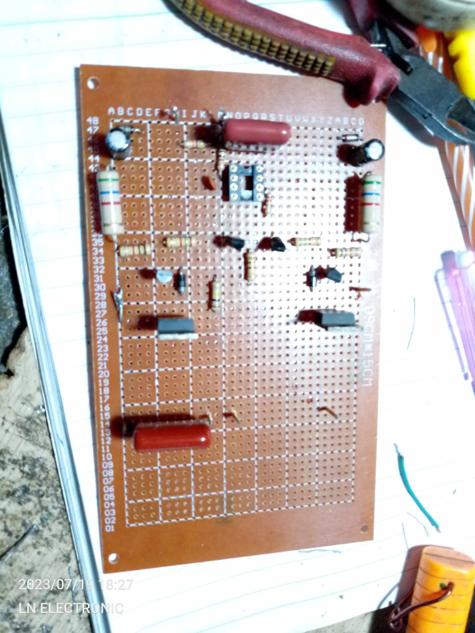

Class D TL071 by LN Electronic

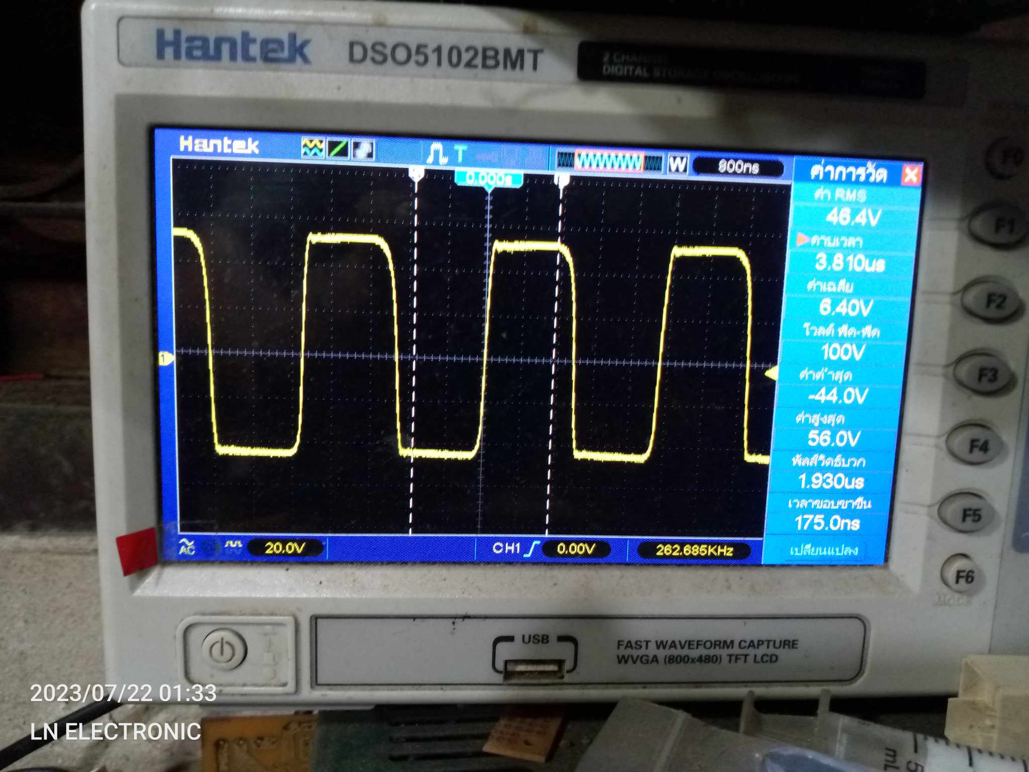

this circuit sell oscilator and class d frequency about 170khz vcc test +-55v

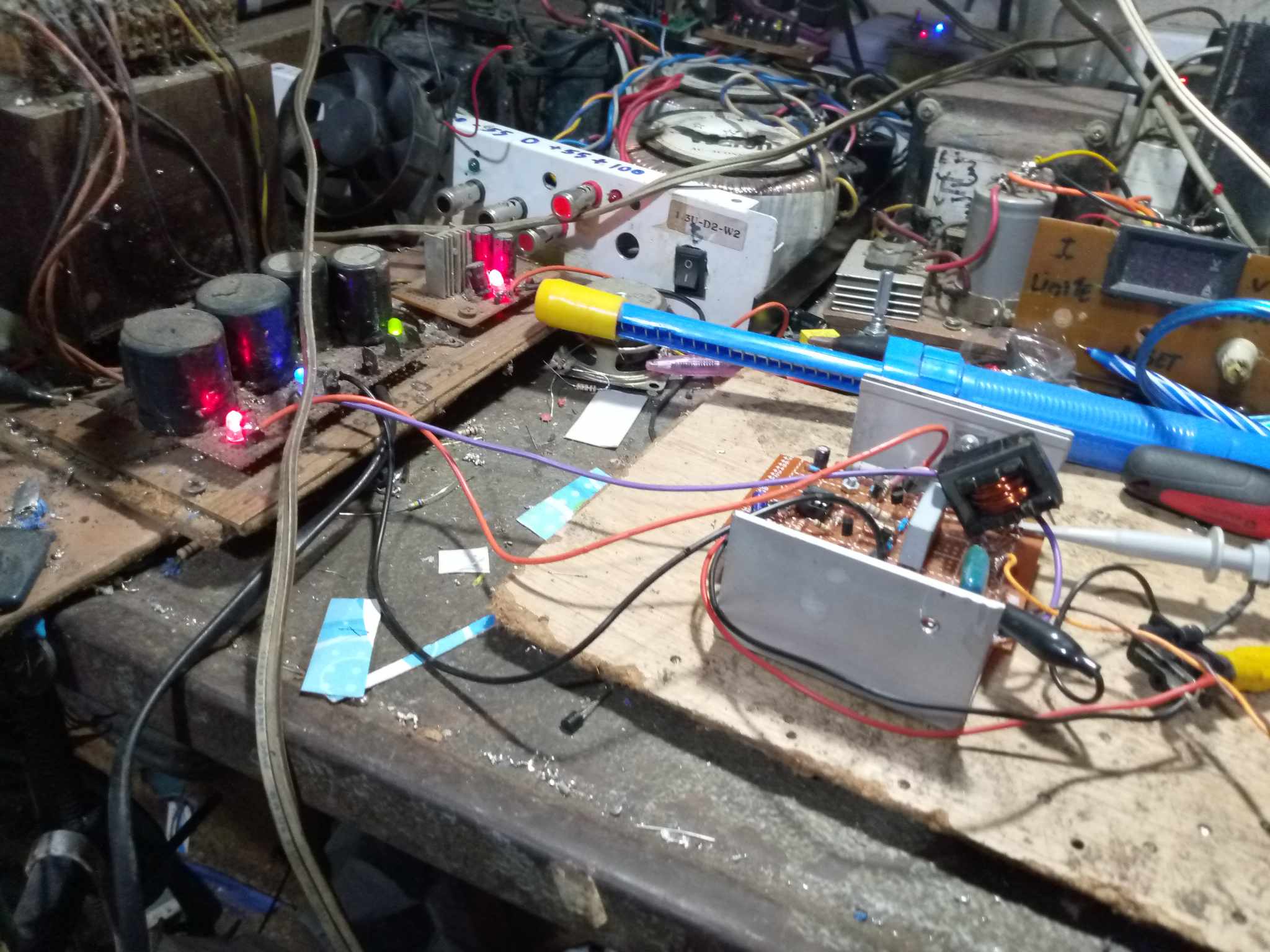

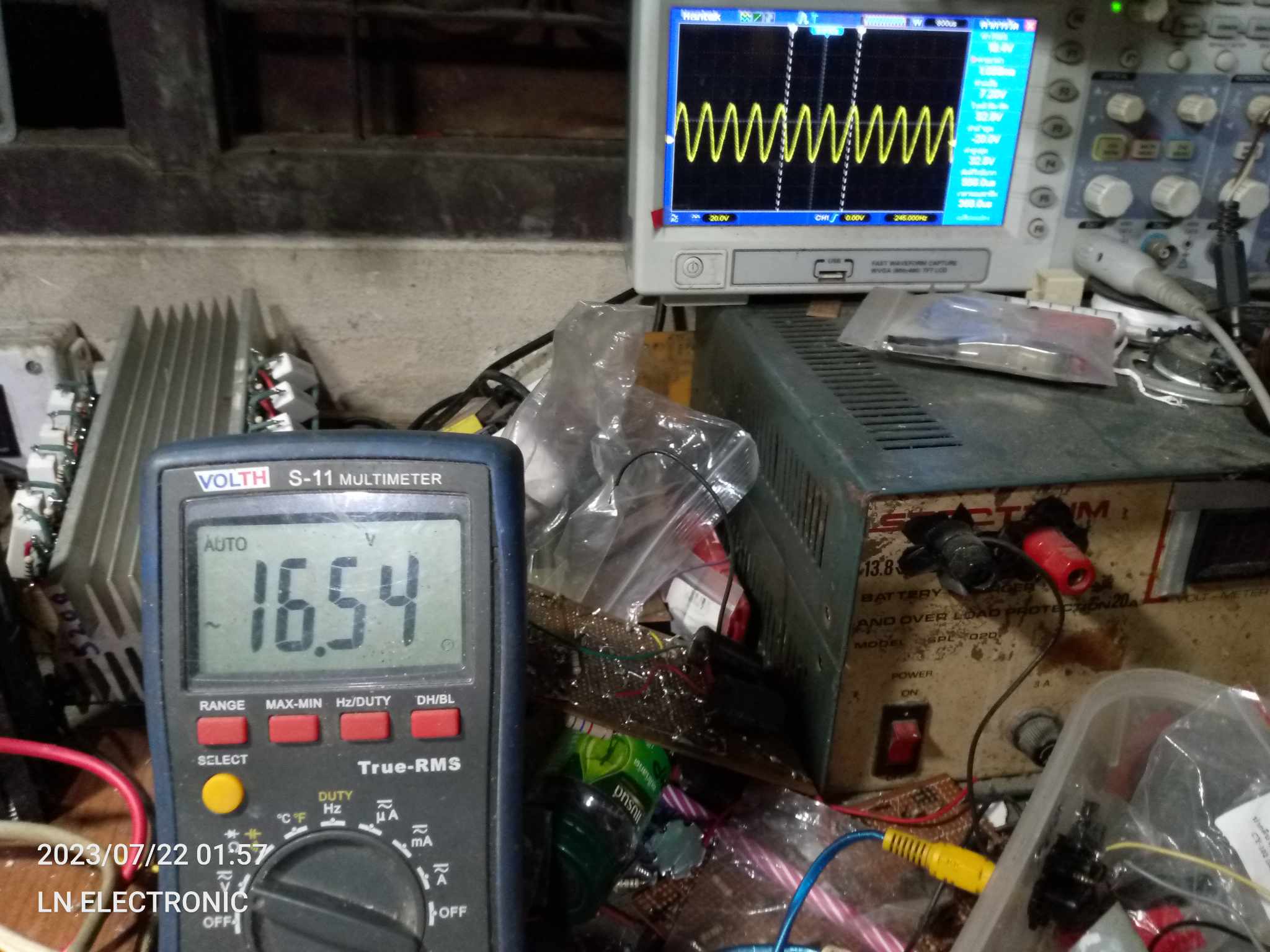

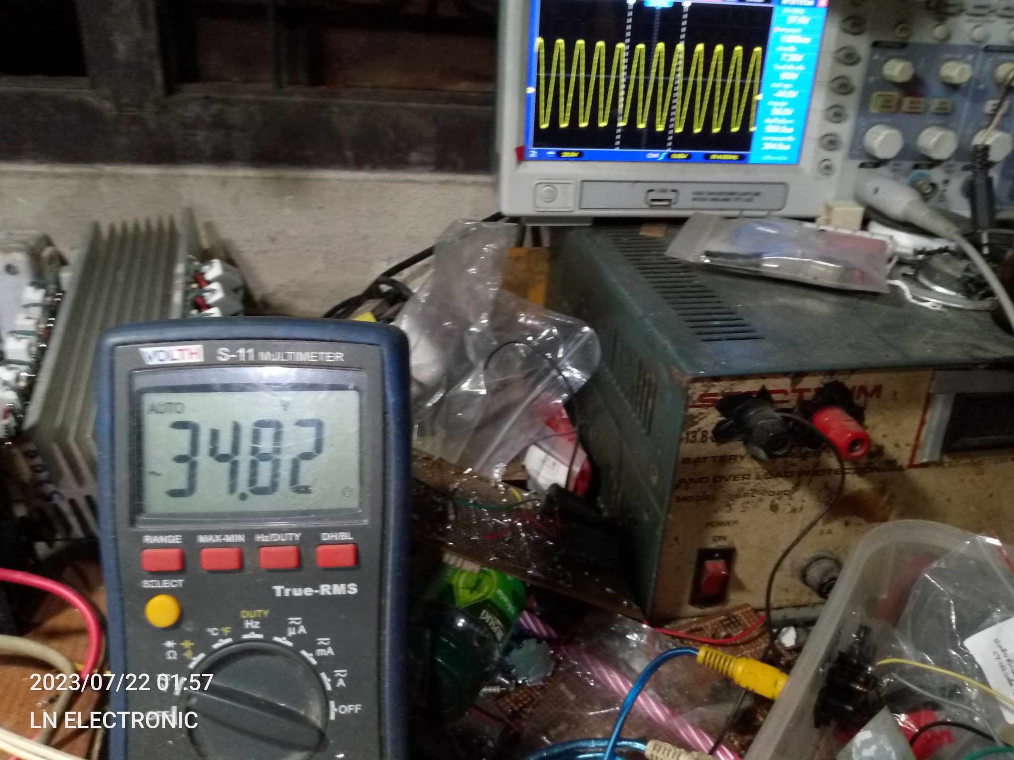

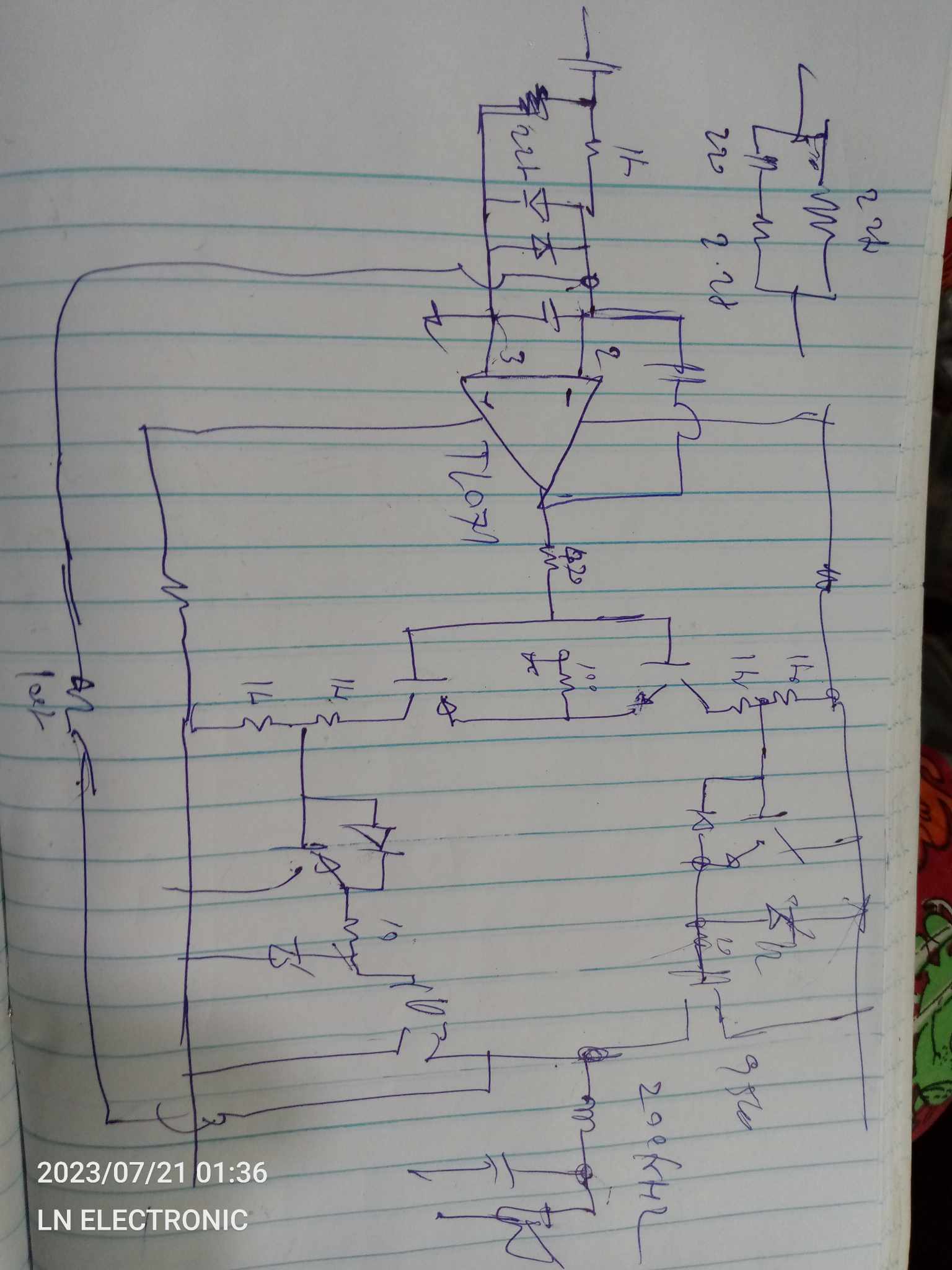

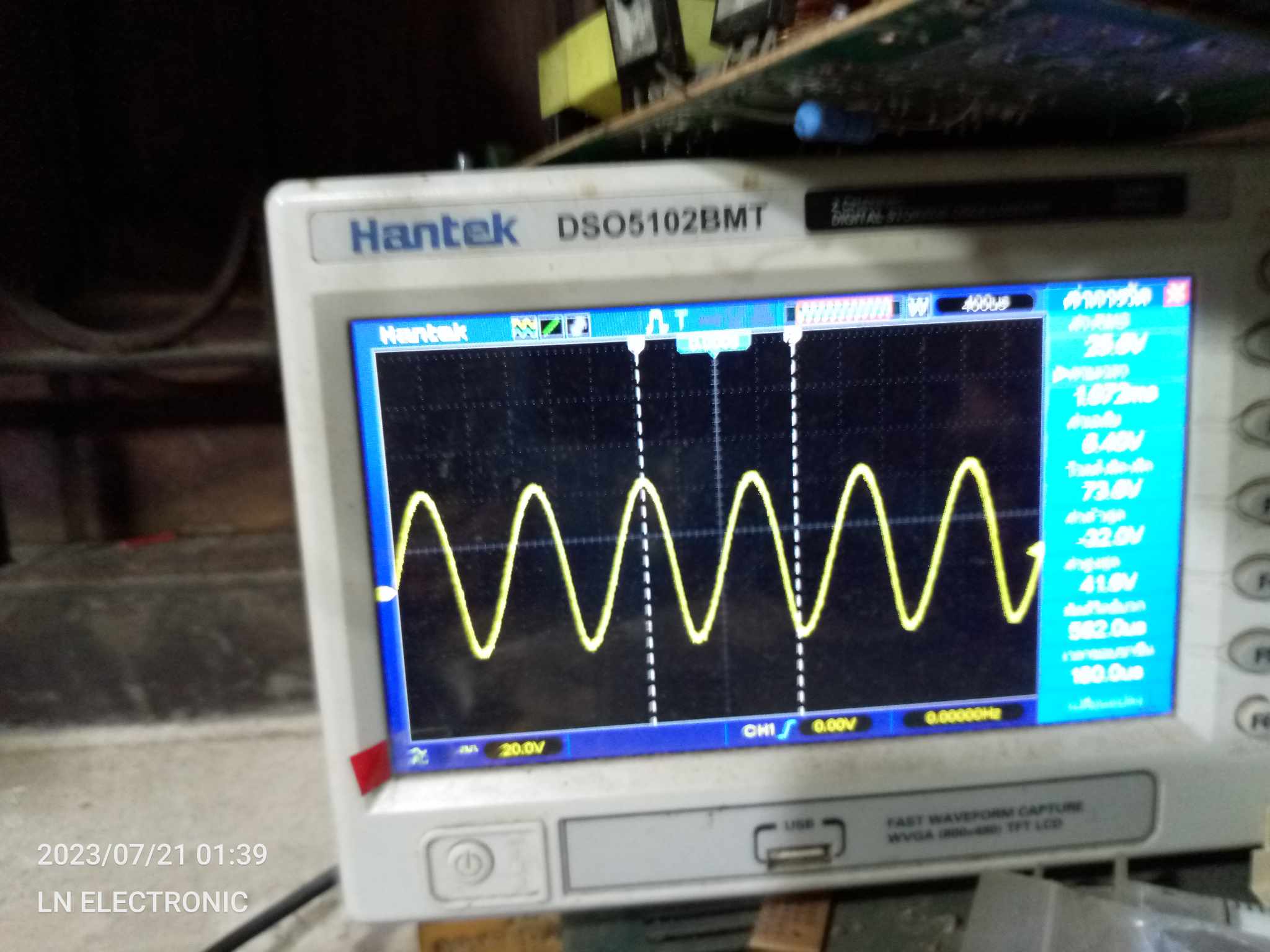

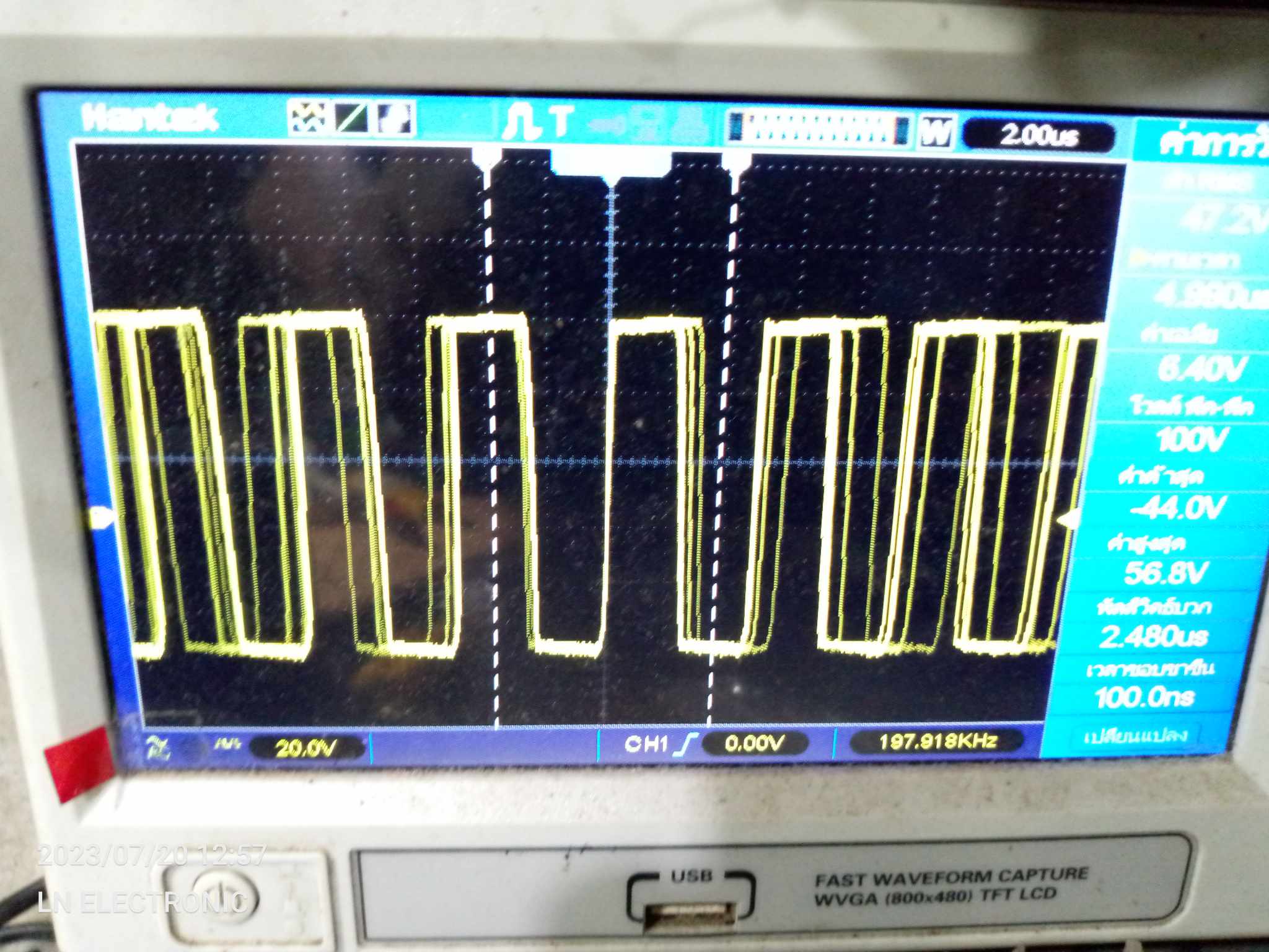

VERSION2 TLO71 CLASS D frequency about 200khz at load 4 ohm v out 32vrms
