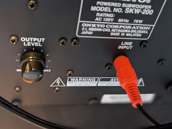

My situation is somewhat similar but more difficult. I like to have a pair of 3" fullrange with one subwoofer in 2.1 setup, used mainly as a desktop PC setup. I have several spare class D tripath amps but presently use one to drive fullrange speakers. On the active subwoofer (Onkyo SKW200) there is no crossover control dial (but set at 150Hz permanently) but does have a bass volume control. It has no speaker binding terminals but only a LFE line input (RCA-red).
Can I use one class D amp to drive pair of fullrange and subwoofer?, How would I diy a cable from speaker output on D amp to RCA input on sub if possible. Or can I use another class D amp to drive the sub only?

>How would I diy a cable from speaker output on D amp to RCA input on sub if possible?
Something like a 10K from each + terminal on the class d amp to a single node. A 10 uf cap from there to a 1K, to the amp powersupply negative - not the "-" speaker terminal. Take the signal across the 1K to your powered sub RCA input, + on the cap end of the 1K.
