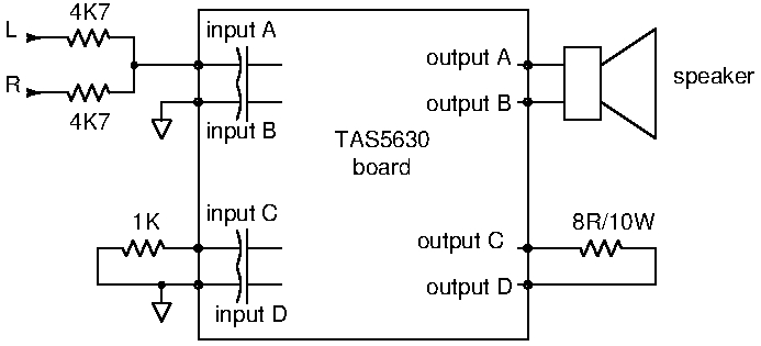

As the TAS5630 is also available as a 600w mono, I assume the 300w stereo channels can be paralleled. Can anyone confirm I won't fry anything so long as I use a couple of 1/4w 100ohm resistors on each channel before combining the inputs?
600W mono means one input and one output. 300W stereo evidently means two inputs and two outputs. You can always connect the two inputs of a stereo amplifier and have "mono" in two separate speakers connected to each of the two outputs. What you cannot just do is connecting the two inputs to one and the two outputs to one without careful study of the design. PBTL is possible for TAS5630 such that at PCB level you can connect the chip as an amplifier with one input and one output.

OK, thank you and sorry for the noob questions. So if I understand correctly I can combine the signals into one input, ground the remaining input and then power one speaker from just one output, but to prevent damage I'd still need a dummy load on the other output?
What do I use as a dummy load? This won't affect power consumption as no audio is being driven through the channel in question?
Correct, you can use one channel only (300W) and leave the other idle. Yes as it is a class D chip, you have to connect a dummy load (8 Ohm/10W) to the output of the channel that is not used and short-circuit the corresponding input through 1K if you have. This, to avoid the idle channel picking up noise.
For the active channel, make a resistive summing with two 10K resistors and use that as input to the active channel.

So short unused output with 8 Ohm/10W and short input with 1K (1/4 W ok?).
Input summed with two 10K resistors (guides I have read suggest 100 Ohm, why such a big difference?)

It is a balance of loading of the source. Output impedance of the source will be the two resistors in parallel (5K or 50R).
The differential impedance between the two source channels will be the sum of the resistors (20K or 200R). Differences in the signals on the two channels will be loaded with only 200 Ohm which in my view is too little.
You may also use 4K7 instead but 100R is too little unless you have a very low input impedance at the amplifier.

So I set this up and there were a few issues. The 1k resistor got very hot.
The volume was much lower than connecting a mono cable with no resistor (presumably the 4k7 resistors caused this?) - is the solution a pre-amp?
The 1K should absolutely not heat as it is on the input side of the input coupling capacitors.
Would you know if the board uses single line input signal or balanced lines input signal?
I tried to draw up the connections for the board if it uses single line input (phase inverter onboard). If the inputs are balanced, you may need to do the mono summing before the phase inverter.
Sorry, my mistake, I meant the 8R/10W got really hot... Single line input, board matches your diagram. Thanks.

No, the only think I did different is short the input with. 4k7 instead of 1k, but I don't see why that would lead to the 8R/10W to run hot.
I fully agree with you. If you disable the input to one channel (before the coupling capacitors) that channel should be silent even with a speaker connected to it. Did you try to measure if there is a DC voltage across the 8R/10W resistor?
