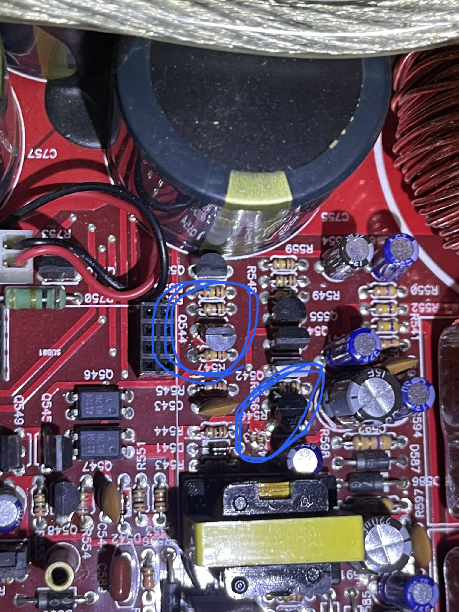

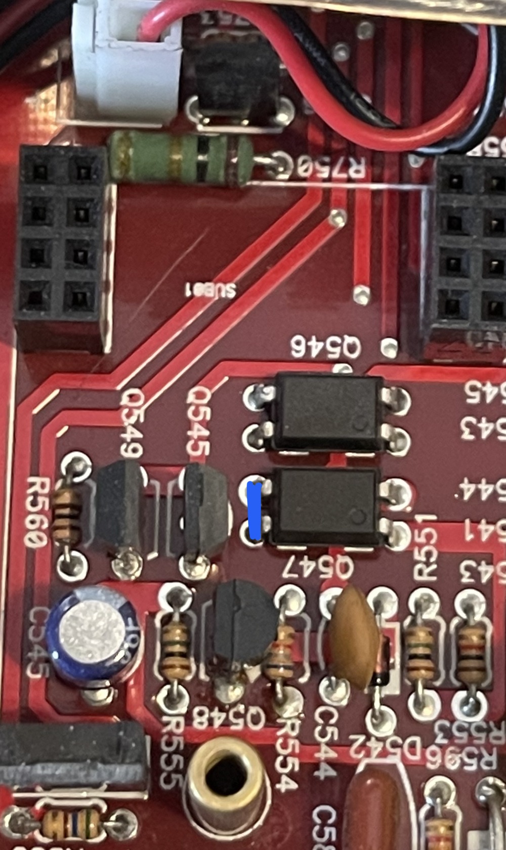

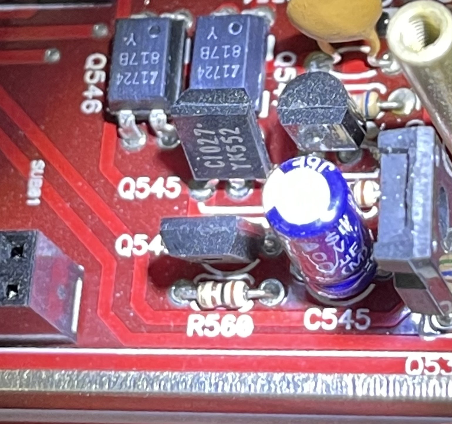

I wish I checked this earlier, I’ve been waiting for my new leads …turns out I don’t even need them 🤦🏼 Also, I had forgotten about this, when I first pulled the board checking and cleaning up the solder work, etc there was a solder bridge near fan area I remember cleaning up. After reading your last post and getting ready to try from underneath i remembered that solder bridge (I always mark corrections, etc jic) and turns out that solder bridge connected these 2 leads (in pic as blue line). This has to be something either intentional or what could have caused the problem right? I’m setting up now for testing as you instructed.
I almost want to try reapplying that solder bridge, as the amp was running since factory with it and it was “fine” working for awhile, only reason I have it is heavy vibration damage, etc. but I think I’ll wait for your reply 😅

Wow, ok, ya no I’m not going to reblob that. It was def from factory, QC must’ve missed it …geez that’s a big miss 🤦🏼
Voltage between Pins 1&2 of the Octocouplers as labeled in pic
#1: .2mv - Q547
#2: 1.05v - Q546

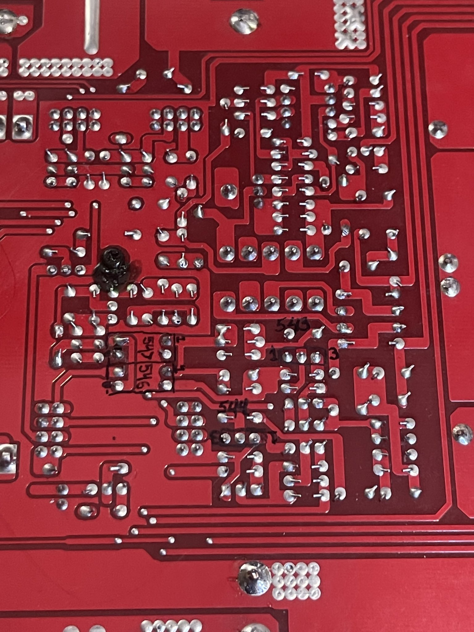

Yes, Drain of Q544 has direct continuity to pin 3 of Q547.
Drain of Q543 eventually leads to Pin 3 of Q546 through a resistor via shared trace.
Pic of underside, marked, even tho I know it’s only half the board, just for note, prolly not needed or very useful but including it.

Yes, after looking at how I had the board I know I didn’t switch the leads around when going from one to the other, and I would have had to. I will make sure I note that from now on for future probings.
And ya it looked on purpose from factory. I’m going to try it, might as well, I’ll report back once I do. I also know a few who may have 11k same version amps, to ask if it also has it jumped.
Ty Perry, brb!
Wow, yup, that was it Perry, relays kicked on and amp is working 100% …now I understand why alot of ppl say some of Orions protection circuit “never worked” …will def have to remember this.
Thx again for going through this with me, hope to someday be at even half your level 🖖🏼
Take care!
Edit: So I wrote that right after I got relays to kick on, but after I went back to test and make sure all is good, amp is pulling more then my 10a PSU can give, at idle, no inout signal, soon as amp boots up fully relays kicking on. Usuall an amp of this size only pulls about 8a at idle I think? I’m goin to try my 90amp PSU but could that circuit cause higher idle amperage draw?
