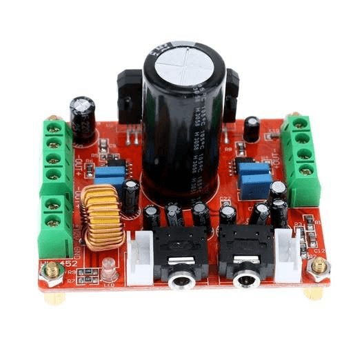

Class AB dc12-18v amplifier. Very cheap. It's simple. Maybe it will last for a year. It will pay an extra $0.5 for electricity.
I've heard of it. Many people use the tda7850 to upgrade the class D amplifier that comes with their cars.
The result is a big improvement. I think home should also be OK. I found that many people use dc12-18v DC power supply to make household amplifiers.
It is much better than tpa3116. I think it also exceeds tpa3255 or ma12070
The total cost of the amplifier is less than $10.
It includes 4 channel amplifiers.

But there are some use occasions. Such as cars. Or only some charger power supply. But people who need to make amplifiers. Only DC12V amplifier is selected.
Relatively speaking, the performance of tda7850 is better than that of tpa3116. The price is cheaper. (very few components. Very simple)
It's more powerful, and it has four channels

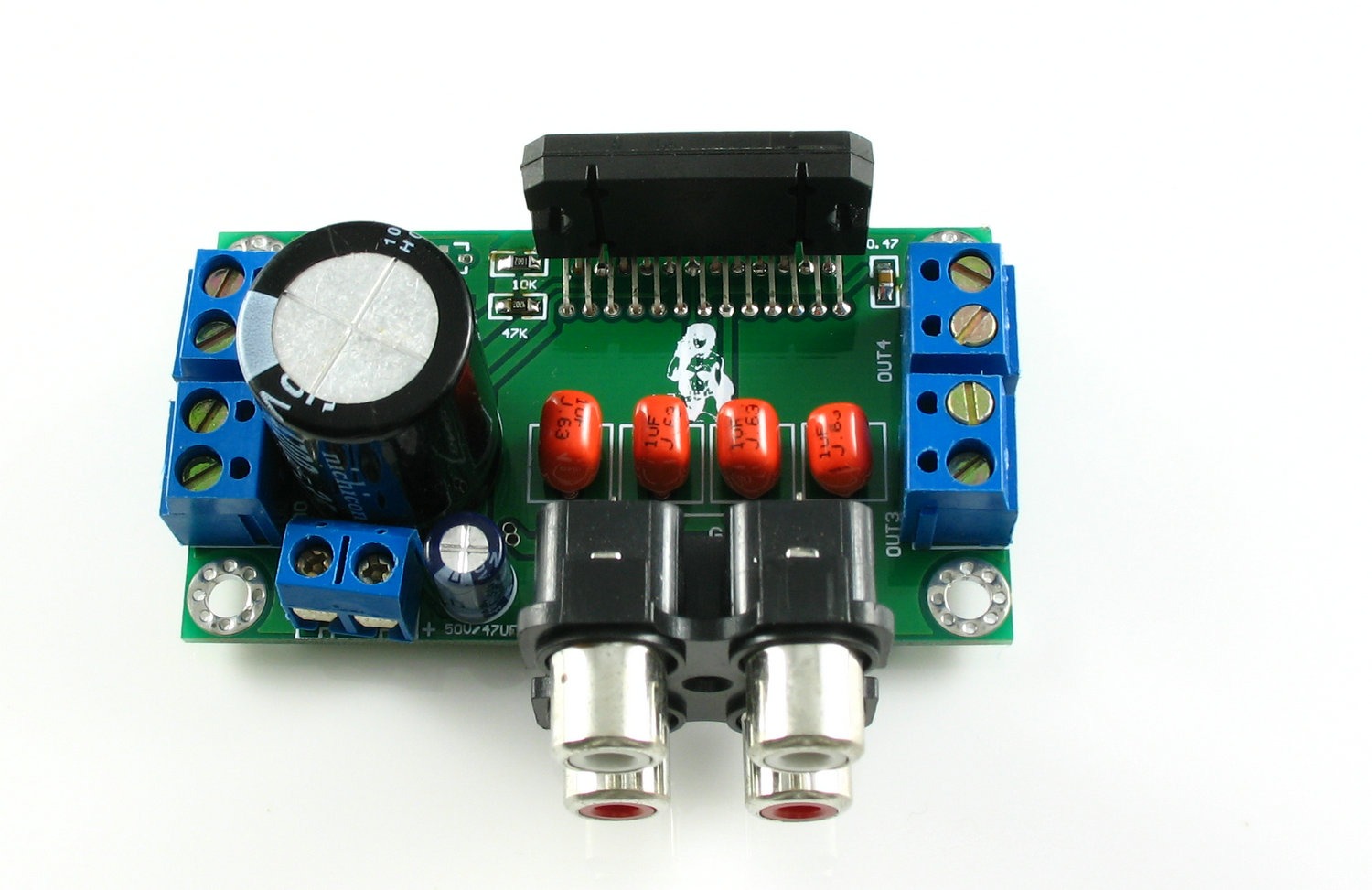

Does anyone have the tl074 input schematic or the whole kit schematic?

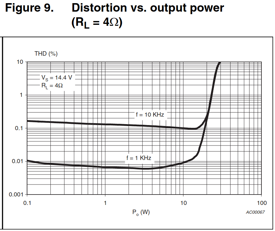

TDA7850 and TPA3116 are not comparable at all - they are designed for different voltage supplies in mind.
TDA7850 is designed for cars, for low voltage supply up to max 15 Vdc. Maximum power output with 14.4 V supply is 23W/4ohm with 1% THD.
TPA3116 is designed for higher voltage supply, up to max 25 Vdc. Maximum power output with 24 V supply is 60W/4ohm with 1% THD. At 4W output, THD = 0.02%.
You can use it with 14.4 V supply and in that case maximum power output will be 22W/4ohm with 1% THD - but why would you use voltage supply much lower than optimal?
TDA7850 has lower THD than TPA3116 (0.006% vs 0.02%, at 4W output) and maybe has better sound quality, but also has much lower maximum power output (23W vs 60W).

"Low power applications with high sensitivity speakers", and active filters as you wrote, is what I'm after. I watched this review and I think that the disappointing distortion that the author found was what the datasheet predicted for the watts he was measuring. ≈ 13.3W and ≈ 1% at 4Ω and 12v PSU. So this is a great data-point.
I need at most 7w from the amp for every channel. Drivers with Re 4Ω and 6Ω.
I was looking at the TDA7297 but I think the chips they sell here are fake, way too cheap. I ordered this one at 13.53USD, hopefully it works well 🤞Pretty excited about testing an A/B amp.
