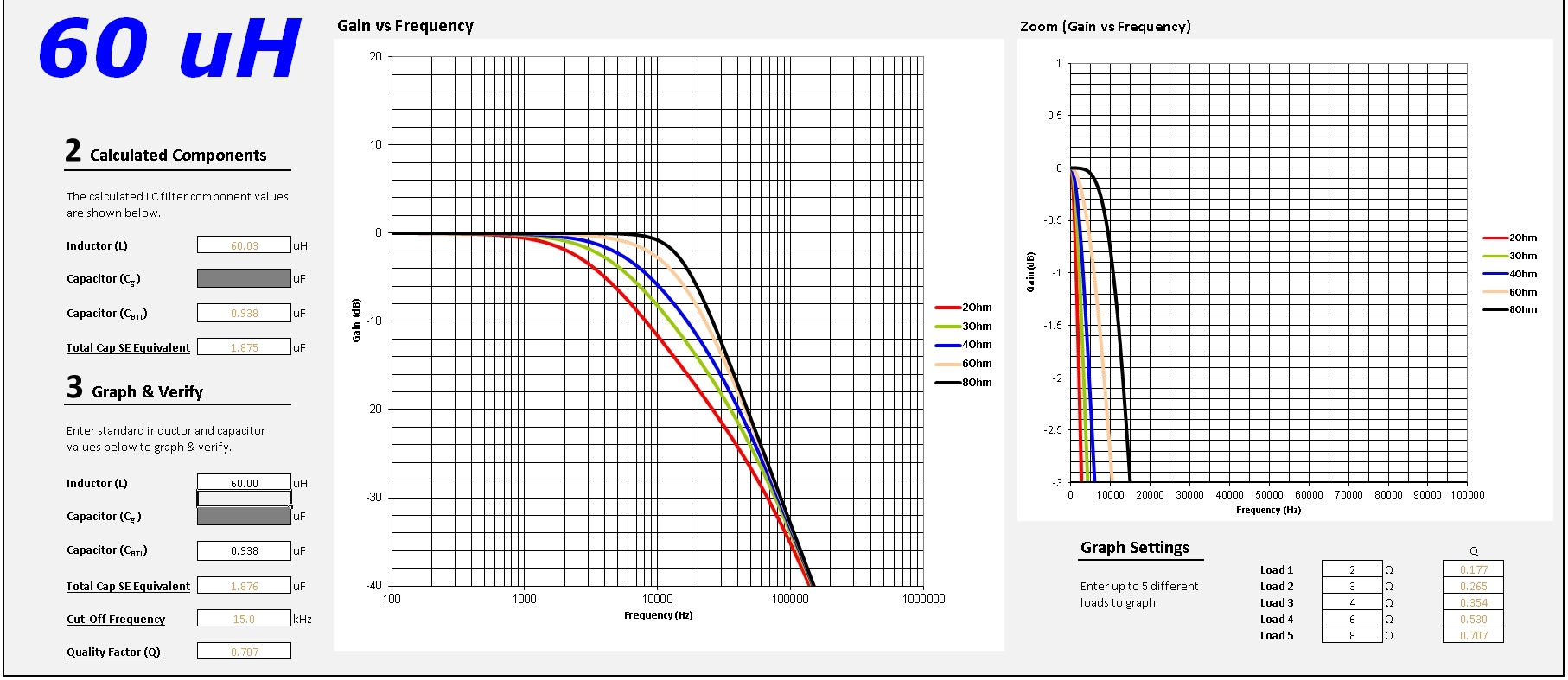

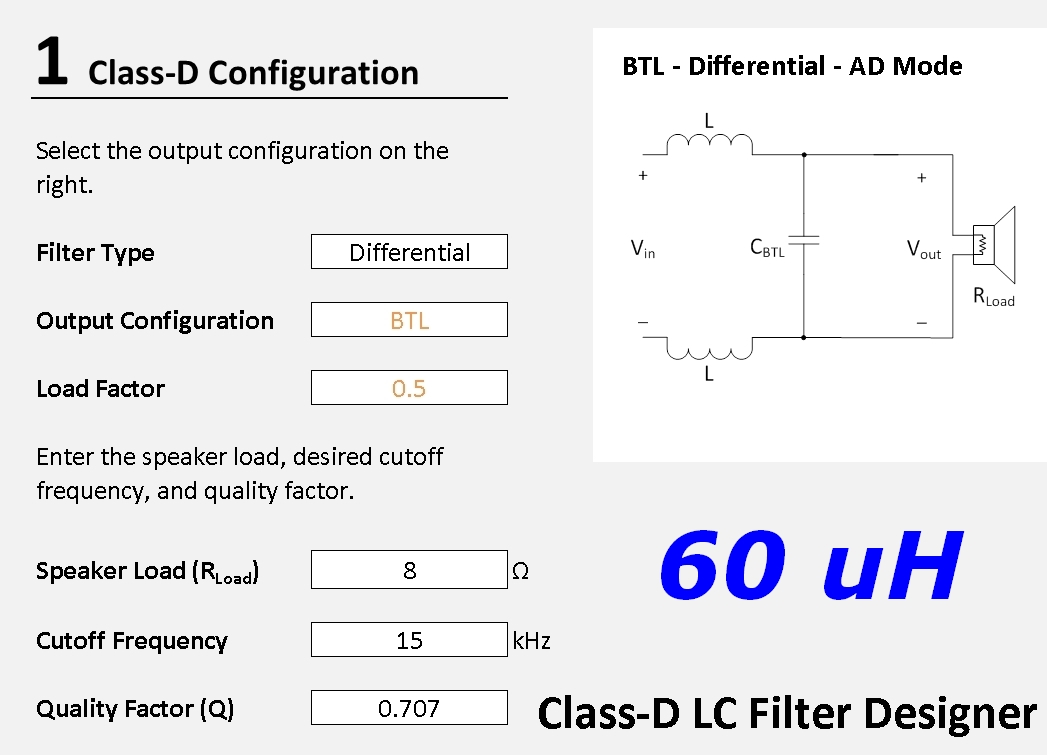

Hi
Thank you for your answers,
I have made some calculations ... for 60 uH inductor + 1 uF cap... for my sub amp...
Cutoff is about 15 KHz .... Please see pics ..
If this amp is for use only with subwoofer is there any problem that LP filter pass frequency up to 15 KHz ??
OR ... is there any problem with the sound quality when using class d amp with this LP filter when it is just for subwoofer ?? 🙂

Do you also stop your car by sticking your foot out the door as opposed to using the brake pedal?
The output filter on a Class D amplifier is there to prevent RF interference. It clearly needs to start above the audio bandwidth you are using, but it does not need to start immediately. Hence a subwoofer amp going up to 500Hz will be fine with an output filter starting from many 10's of kHz.
It also is there to reduce Eddy currents in the core, coils and magnets of the speaker.
Rising inductance of the sub-woofer driver will effectively unload it from the amplifier at high frequencies anyway. I don't really see what practical objective this output filter would be capable of solving.

It depends on type of modulator.
Post-filter feedback will correct the frequency response of the filter, although a too low cutoff with a too low impedance load at HF (low relative to filter impedance) will result in premature clipping.
Pre-filter feedback for driving an inductive transducer will always result in some HF peaking, unless a custom RC damper is used. A LF speaker driver can easily exhibit 1mH inductance at f'=1khz, although it is not constant with frequency (more likely Z=2*pi*f*L*sqrt(f'/f), 3dB/oct, rather than Z=2*pi*f*L, 6dB/oct). But this HF peaking can happen above audio band (but increasing switching frequency requirements and lowering efficiency) or well above speaker passband (favorable case, subwoofer-only amplifier).
So for your case (LF speaker driver load, pre-filter feedback I assume) output filter design is more about output coil size, core losses, and amount of carrier residual allowed. Lower inductance increases peak-to-peak inductor current but reduces discontinuous-to-continuous-conduction distortion characteristic from dead time in class D. Lower inductance also increases core losses, so it is a matter of picking a core size, then picking an inductance value resulting in not too hot coil when idle for desired switching frequency (and with room for desired wire gauge for coil not too hot and full music power), then picking output capacitors (I recommend 3 caps for full bridge), then adding a RC damper (with 3W resistor to handle any HF burst, although losses in normal operation will be low), the damper is recommended because with a high inductance LF driver peaking can be quite severe, and LF drivers occasionally have HF peaks too that must remain hidden, the RC reduces worst case peaking to reasonable amount of dB (but the lower the resonant freq of the filter and the lower the L value the bigger the C required and the lower R value).

You need to calculate filter components keeping in mind, first, the frequency of cutoff (-3dB), and the load impedance (Any online calculator will give you the values needed). Second, rate them on a power capability basis. Perhaps, with lots of luck, the 60µH can perform, but it is most probable that doesn't.
Find another schematic, that one is really bad, it lacks power rail decoupling and snubbers, and the modulator is plain old triangle wave without integrator resulting in quite limited error correction capability. Check threads about IRS2092.
A picture of the toroids could help to determine suitability, is manufacturer/brand known? The 60uH value is not a problem, toroids are easy to rewind (inductance is proportional to turns^2 so removing half turns would result in 15uH), or do you mean MPP cores with 60u permeability (btw:these are the highest cost ones)?

These inductors are swinging chokes, inductance changes 2:1 from zero current to maximum current, as for a SMPS, not good for class D, particularly not good for the schematic proposed due to low error correction ability, huge/overpriced/overkill coil too:
