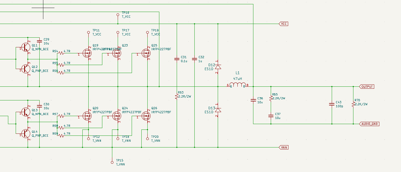

I'm experimenting with output inductors on my class D amp (irs2092 based). 6x 4227 output FETs switching around 200kHz. Output stage is more than capable of over 1kW of power but my power supply is the limiting factor so I detune to around 700 watts at 1 ohm.
As others have experienced on here, using power inductors will cause them to get hot. Many people here like to recommend T106-2 as well.
However, I harvested an inductor from a old amplifier that uses double stacked black cores with 17 turns with dimensions - diameter: 30mm, ID: 13mm, H: 23.5mm (height is total height of stacked core) with an inductance of ~33uH. This inductor runs very cool (50C max). What type of core do you think this is? Plugging the values into coil64 program, it seems to have a Mu' of ~30. Whereas cores like T106-2 has a Mu' of 10.
I also tried fair-rite material 68 (https://www.digikey.com/en/products/detail/fair-rite-products-corp/5968002701/8599644) which has very similar specs to T106-2 but it got very hot (over 120C). I wrapped it with about 45 turns of 5 parallel 20AWG wire to get about 40-45uH. Material 68 is NiZn instead of iron powder of T106-2, would this be the cause of it getting hot?
I would like to try T106-2 core but it seems I can only get them on ebay at the moment, ideally I'd like to be able to buy from digikey or mouser.

1kA with 45 turns is a lot of flux in the core - it is likely saturating at much lower levels than this. I would look at the core temperature versus output power level while putting a sine wave into the amp and drive resistive load. The frequency plays a role as well. The wire must be getting quite warm as 5 parallel 20awg wires is undersized for such high currents.
Powdered iron cores like T106-2 have a distributed air gap as well as higher Bsat than ferrites, and that allows them to handle higher currents. There are a number of large iron powder core types out there, but not carried by Digi or Mouser.
20 AWG is rated at 6A. Five in parallel 30A and then derate a lot as being wound in a core traps the heat, certainly no more than 10A.

I should have mentioned that the inductor is getting hot at idle, not driving a load.

Can you provide a schematic?I should have mentioned that the inductor is getting hot at idle, not driving a load.
Here's the output section.
Previously, I used a MnZn power inductor (rated for 125C) for the output filter that reached 115C just idling for 1 hour. Despite being so hot, it worked fine. Using the inductor I got from a old amp it only reaches ~50C after 1 hour of idling. Even when driving a speaker at about 400 watts (music) for 30 minutes it only got up to ~65C.

Ferrites tend to deteriorate with heat, becoming more lossy and getting even hotter. Over hot is an indication the core is too small for the job, or the wrong ferrite. There are many formulations and each has a different loss v. frequency curve.

The output inductor has no visible current path (AUDIO_GND appears to go nowhere). Where does it connect off the photo? please add that rest of the ckt.Here's the output section.

AUDIO_GND is the center tap to my rail capacitors.Tony Salsich:
Then it would appear that the circuit maintains zero volts average at the output (during idle) by driving the half bridge at 50% duty (average half bridge voltage must be 1/2 bus), and if the pulse width is maxed (50% duty for upper and lower section, but out of phase of course), then this pumps current in and out of the inductor at 200kHz. The net voltage across the inductor may be zero but the ripple current content will be composed of ~1.12Arms at 200kHz; ~125mArms at 600kHz; ~45mArms at 1MHz and so on (assuming exactly 50% duty and assuming that the inductor value is constant at these frequencies). This should indeed result in a warm inductor at idle.AUDIO_GND is the center tap to my rail capacitors.
BTW; most ferrite materials run 'warm' as their losses tend to hit a minimum at elevated temps.

Yep, I see the error, 200V mosfets on 70V rails is a sensible maximum. Then you get 50Vrms, which is 2.5 kW into 1 OhmIt is time to ditch your pocket calculator
This is 50A rms, which is still far too much for the inductor wire size.
