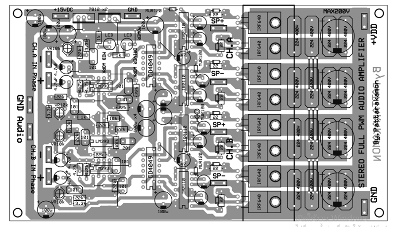

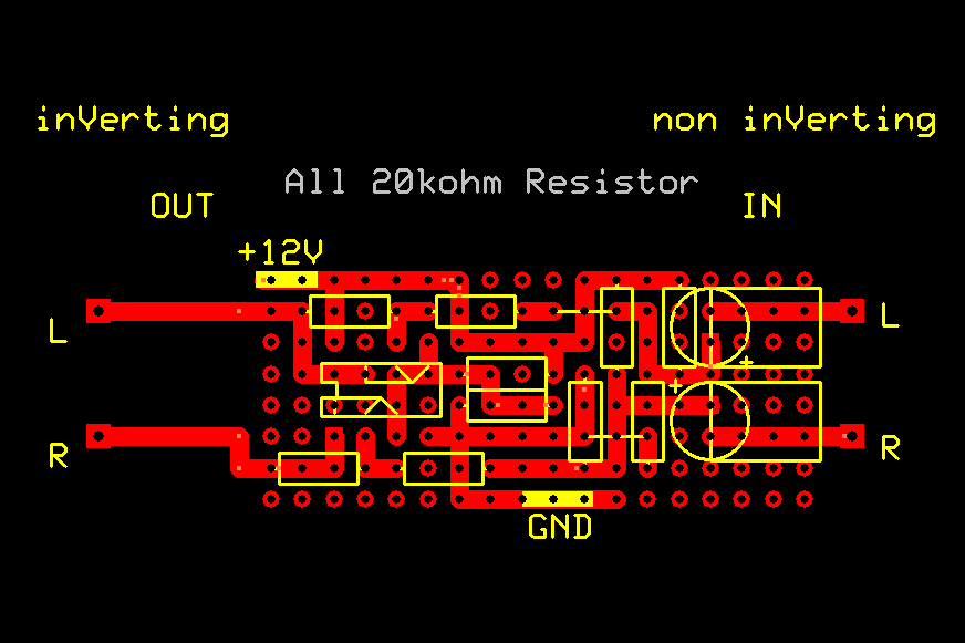

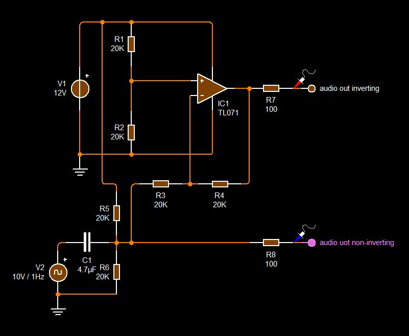

pattarakamon Member Joined 2019 2021-09-26 8:22 am #21 2021-09-26 8:22 am #21 The C101 in the PCB uses 471 instead, and the input is through an R100 Ohm input. A asdktl Member Joined 2021 2021-10-01 5:16 pm #22 2021-10-01 5:16 pm #22 Sir can you share this project B bucks bunny Member Joined 2020 2021-10-01 6:12 pm #23 2021-10-01 6:12 pm #23 This BS reminds my of Kartino. Kartino, are you back again?😛 Prev 1 2 First Prev 2 of 2 Go to page Go You must log in or register to reply here. Share: Facebook X (Twitter) LinkedIn Reddit Pinterest Tumblr WhatsApp Email Link
