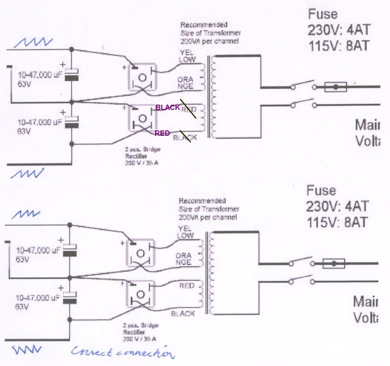

BWRX said:I believe he means he swapped the AC secondary connections on one of the bridge rectifiers.
correct
The way the secondary windings are connected to the bridges has definitely an effect on the ripple at the capacitors and thus it's no surprise it affects the sound.
Anzgar said:The way the secondary windings are connected to the bridges has definitely an effect on the ripple at the capacitors and thus it's no surprise it affects the sound.
Can you please tell us more about this?
Measures, physical facts, how to determine the right connexion, etc.
I have not traced the NCD circuit board, but my initial guess would be the electro-magnetic effects in the transformer. This makes me think whether I should go back and give the R-core transformer a try by swapping the secondaries. I am also guessing that whichever way the startup current has the largest peak, then that should be the best way to connect. If someone does a measurement and hears a difference, please post it.

Please look at the picture (if I succeeded to attach it)
Have you actually measured it to be like that? I'm under the impresson that the ripple is always the same direction because of the way the cap discharges during the negative slope of a half sine wave.

Of course I have looked at these wave forms with a dual trace oscilloscope.As in the correct wiring the ripple is in opposite phase on + and - voltage they cancel each other to some degree I believe.
"Correct me if I am wrong". 😉

Now I'm tempted to stick it on my scope the next time I switch around.🙂 Maybe it's a shift in timing rather the shape itself?
