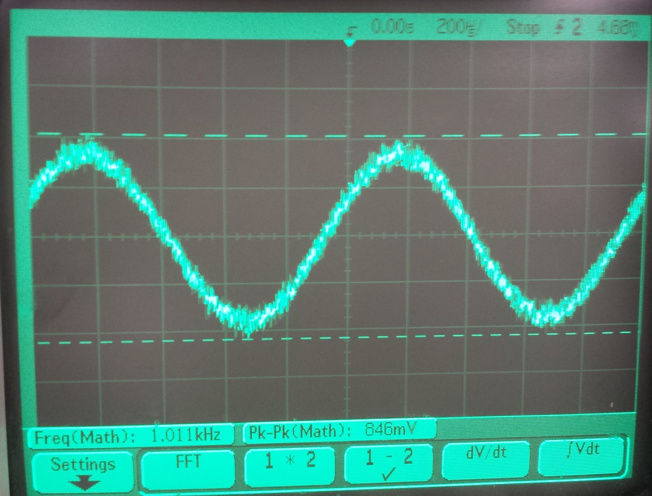

As an update, I did some testing in the lab today. My professor stopped by and taking a look at the circuit he said I would have to use a differential measurement instead of the direct one I had hooked up. It hadn't occurred to me that the - terminal of the amp isn't referenced to ground but -B. Once I hooked up two probes, and the RC filter I was able to see my input which was relieving. I do have two problems however, the waveform is still quite noisy looking; could this be inherent to the set up I have used being subject to noise? I can't imagine the real output is this noisy.
My other issue is that while I am using the math function of my o-scope to find the differential output of the amp, it doesn't allow me to do fft of the waveform, but only a single channel. I am thinking of capturing the waveform and analyzing it using MATLAB to find THD, but it would be nice if I knew some better method. Any suggestions?
I've attached the output that I did get to show the noise I am seeing. The input was 20mVP-P 1kHz. With a gain of 36, 20mV->720mV.
Are you able to do math operations to FFT results? You could do FFT on both channels and then subtract in the frequency domain. The result should be the same as subtracting in the time domain, i.e. FFT is a linear operator.
Really the best method would be using a good quality sound card / interface. They will have superior noise performance to even very expensive scope, but are, of course, limited in bandwidth. However, we are now mostly interested in audio range performance so it would be okay.
With a sound card you may or may not need to use any extra filtering as they will have some of their own and oversampling converters. However, be mindful of signal levels and maybe build a resistive attenuation pad to bring the signal levels down line level (1-2V max).
