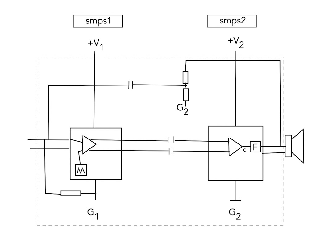

I see the power industry puts the galvanic isolation between the driver and the transistors https://www.st.com/en/evaluation-tools/evalstgap4s.html

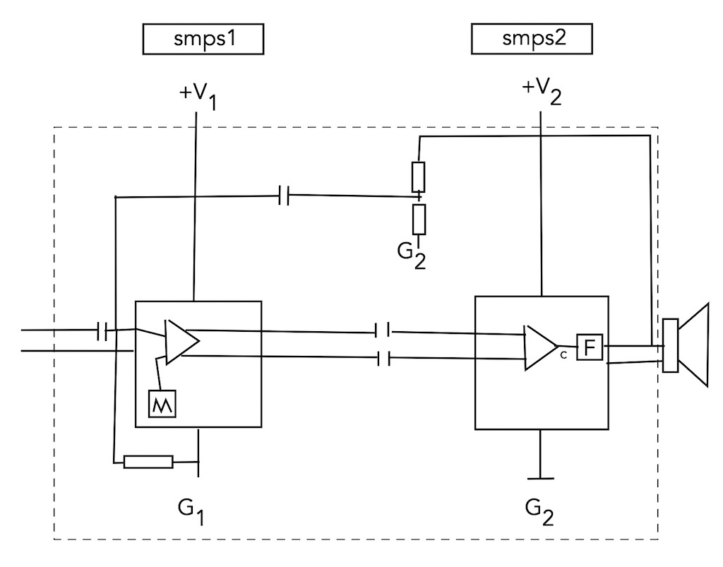

Another issue with capacitive isolation is that there's absolutely no feedback at DC or lower frequencies which could seriously impact the DC accuracy and PSRR of the power amplifier. For example, a DC offset or a low frequency disturbance at the output doesn't get carried to the controller side and therefore never gets corrected for.
I suspect that DC handling might be a bigger problem in general than what we think. I'm also thinking in the direction that we should probably limit the pass band to make life easier on the reproduction chain - if we keep it reasonably wide it will I suspect suffice - say 10hz-30kHz -1 dB would be OK. Thus, I would feel OK with DC coupling the output stage and the input stage also so to avoid what you mention.
Then I would personally compensate for FR and phase problems coming out of these physical filters to get back a perfect pass band - on system level - i.e. from a .wav file to favourite listening position. I dint give a rats @SS about if some part is not perfect in the FR/phase department as long as I get a perfect system behaviour.
