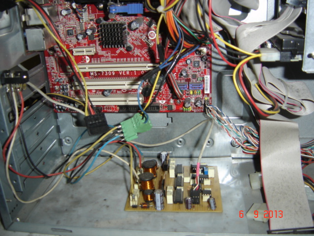

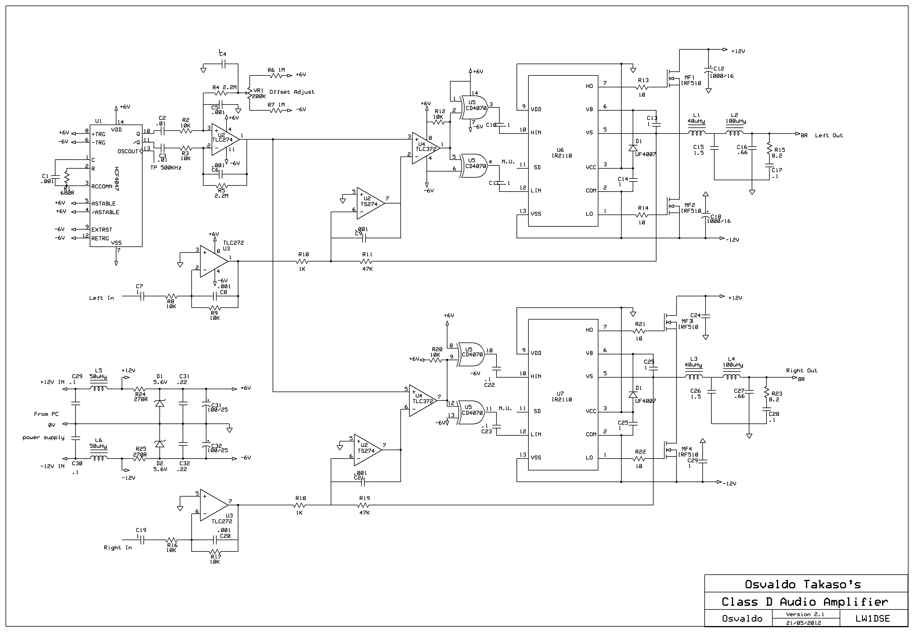

This circuit is designed of my own, uses common devices and is capable of about 8W into 4Ω loads, I'm using it inside the PC cabinet powered from ATX power supply. It is also, low cost and no "rare" or "specialized" circuit beyond the standard IR2110.

Thanks alot for the circuit design, it's impresive. My concern is that I will not have the time to gather and assemble all the components.
OK, as I use it in my job PC, I have only two 4" common speakers, so I can't nor I want to run them too loud. But noise is clearly under that of the PC plus internet connection. No audible noise when no signal. It run about 300KHz, so not too good fidelity, but IP radio has´t no more than 8KHz, so they run perfect under those circumstances.
