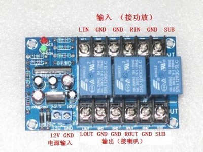

Simple fix for your speaker 'pops':
2.1 channel / 3 channel speaker delay protection board support BTL US $6.39
