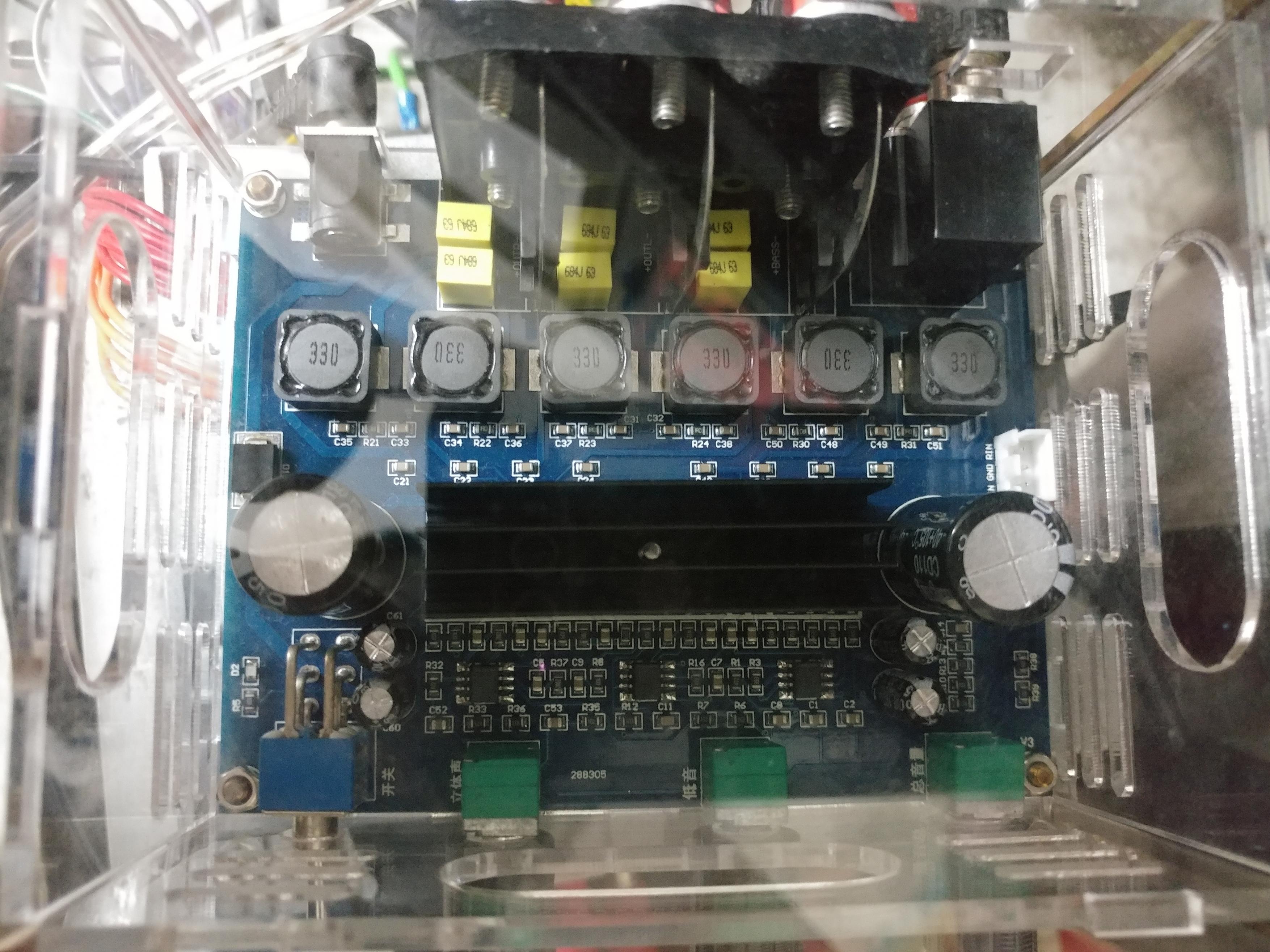

I swapped those coaxials with the current satellites and they are 5W each @ 4ohms. In the subwoofer box, Today I swapped one 4inch driver with another 4inch driver and it's rated at 20W@8ohm. They are still connected in parallel. The problem still persists, which is that as soon as a track is played which is bass heavy, when the bass note plays, the LED on the amplifier board dims a bit and the sound cuts off momentarily. It goes back to normal either when the bass note is over or when volume is turned down, either from the source or from the amplifier.
Till now I have tried following:
I intended to buy bigger amp only to get rid of this problem and have headroom for future driver upgrades.

So the tops are only 5W..... that's only 1/10th of what the board should be capable off.
Is it correct that you only tested with 1 board?
Then there must be something very wrong with the board like the decoupling caps being faulty or one of the smaller ones near the chips. Are they swollen / are the tops still flat?
You don't need a bigger amp just one which works correctly. 🙂

The caps look fine.
Before getting the board, I was using the same setup with 2 amps, 1 stereo Nobsound NS-01 amplifier driving the satellites(at that time, I was using those JBL Coaxials) and a monoblock car amplifier for the subwoofer(2x40W@4ohm each, in parallel) and it worked well.
Yes, but can still be faulty. But this boards performance did not deteriorate over time? If it was like this from when it was new, it might just be a limit of the design.
If it functions ok I suggest to use it as it is; and get a better board if you want more power.
The board I mentioned earlier will suit you and runs fine from a laptop adapter. I don't know if your current board has a high pass filter for the tops, but that will make a lot of difference in how much power your tops will like to get before they sound bad; especially when you use small tops.

The problem has been with that amp since the day I bought it, less than 6 months ago. But thing is, when kept it within the limits the board runs OK. The 3 pots on it control the bass, treble and overall volume level so the Tops aren't an issue. Guess have to go for a bigger amp but there too question stands, TAS5630 or TPA3255?

Be careful, 2ohms is a load which is too low for many amplifiers. In the case of your new Yjhifi TPA3255 amplifier, 2ohms is OK in SE mode - which is how your amp's stereo speaker outputs are configured ...while the Subwoofer unit is a pair of 4 inch 4 Ohm drivers rated at 40W RMS. They are wired in parallel so the effective impedance would be 2 Ohm.
but 2ohms is not OK in BTL mode - which is how your sub speaker output is configured.
If you were to use a single TPA3255 (mono) amplifier to drive your subwoofer, this would be OK, since in this mode; PBTL, 2ohms is OK ... but this is not practical, since you have already purchased a pre-configured 2.1 amplifier.
The easiest solution for you is to use just one of your subwoofer drivers, instead of two. Of course you are giving up some power handling capacity, but at normal-to-slightly-high listening levels this should not be a problem.
Another solution is to wire your two subwoofer drivers in series, raising the effective impedance to 8ohms, which is still fine for the TPA3255.
I know this is technically OK, but I don't know how the sound quality of this approach compares to the previous scenario of using a single 4ohm driver. Maybe some of the experts here can jump in on this subject.
