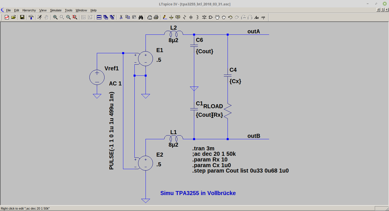

To simulate the behaviour of the output filter this very simple approach might be useful

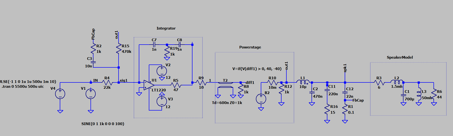

So I went back to the idea of taking some feedback from the current in the filtercap. With my first tries it lead to a DC-offset that I could not understand. Now I include a cap to block DC in that feedback-path and it work very well.
Please see the attached schematic for the conceptual idea.
I'm not sure if the "Cap-current-feedback" actually lowers distortion, but it makes a huge difference with "taming" the unloaded filter.
The prototype-circuit appears to be pretty stable even without a zobel at the output.
I have never seen this done in DIY-amplifiers and I'm still unsure if there is any benefits besides the damping of the filter-response.
But if it does not hurt anything and it helps to control the output in no-load-situations, I think thats a big improvement for the small number of xtra components.
What do you think? -and have you seen similar implementatons?
Kind regards Troels

Relative dead-time error is smaller, but your loop gain will most likely be also smaller....
Your approach comes close to mine (taming TPA3255). This is a PFFB that only is effective in the vicinity of the output filter resonant frequency (~50kHz) thus doing a great deal stabilisation, even w/o any load. But in the audio band it hardly makes a difference.

Yes. This may not be evident on the first glance at your circuit.
Your feedback is a differentiating one, coming with a leading phase. I did the same with one small cap from post filter output to input of TPA3255. Together with the input resistance this RC creates the characteristic hi-pass filter.
Thank you for assisting me. I'm beginning to realize how much stuff I have forgot ( or maybe never knew? )
With the risk of demonstrating my lack of basic knowledge: I'm still not sure that the 2 solutions are the same. The current in the LC-cap will rise before the voltage over the cap. So if we can use the current in the cap instead of the voltage over the cap we get a better phase-margin?
Kind regards TroelsM

Yes, I think so
Thinking a bit more about it, I think that our solutions actually are pretty close. If you take a small cap from the output and feed it back to the integrator input it will be the current in the cap that is the actual feedback-signal. That makes it close to the idea I was following, but yours are probably simpler and more elegant.
I have tested "my" idea a bit more and it really helps to tame the LC-resonance. but I see no difference in the distortion-numbers.
I think that the feedback from the cap also helps to control the behavior during clipping so that would be an extra benefit.
I'l compare it with your idea soon.

Hi Troels
I think it would be really useful to have a Bode plot of the feedback.
You seem to already have most of what is required, in the LTspice ASC that you posted.
I think you just need to linearize the switch element.
There's plenty of literature about this, have you looked at this option?
Best wishes
David
Hi Dave
Yes, I looked at it shortly and, yes I would be a great help, but I cannot remember how to do it.. - I'm pretty sure it was part of my EE-education, but I have no clue :)
I can model most of it, but as you say the switching part is tricky to translate. The delay in the signal-chain also needs to be included as it will add a phase-shift that somewhat independent of frequency.
There must be a standard way to model a classD? thinking about it, I think I saw a simple model in one the threads here? - maybe the one about modelling the Hypex Ncore? I should give that a try later.
In the end there is some very important aspects that needs other models and real-life testing as well: start-up behavior, clipping, shut-down, and such.

Keep in mind that the small cap has maximum effect close to the output filter resonant frequency voltage peaking, but very little in the audio band. So it helps stabilisation but does hardly improve THD - this is a different story.
