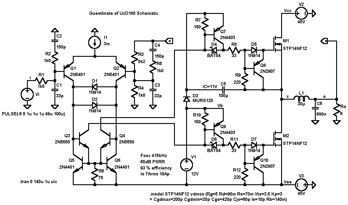

The LC filter values you mentioned are what is used in the UCD180 (slightly higher Q than a butterworth), but I believe none of the others are. For instance the feedback and gain resistors are 8.2K and 1.8K, which means the 560p and 910R likely aren't the same as well.
As far as the other values, that will all depends on component selection. I think 10mA for the LTP may give excessive dissipation and reduced input sensitivity. I'm using more in the area of 3mA, or 5mA for a full bridge. So the drivers get ~1.5mA, mosfets ~150mA drive current, which isn't alot but with the state of the art mosfets required anyway it seems to do the trick.
For the sake of experimentation, I've just tried values similar to those you've mentioned. 10mA source, 100ohm Rb for ~9.5mA base (it's a requirement to have it closely match "Is" to lower DC offset), 120R for the PNP turn on, and 68 for the PNP turn off, with 2R as the "on" resistor.
With 110R for turn on the driver was loaded down and providing inadequate drive, and extra 10R was enough to fix that.
In transient it showed respectable shoot through (but worse), less input sensitivity, doubled average power dissipation to about 1.2W, and a 5X increase in THD.
The values I prefer, 3mA for Is, 250R for Rb, 460R for the PNP turn on driver, 320R for the PNP turn off, and I kept the same 2Ohm Ron for both tests.
That gets me better sensitivity at the diff pair, ~0.6W dissipation, almost no current shoot through at all (you'd have to really look for it), and...... and..... OH lookkk..... spice is lying to me again. It usually shows ~.012% THD for these same values, but now it is showing TOTAL HARMONIC DISTORTION = 8.505807E-03 PERCENT, hey, I'll take it.

Thanks for the help with the values. I checked some more back threads and found the part number for the output mosfets and the post where Bruno mentioned the values for the feedback resistors. I am attaching an LTspice schematic showing my baseline UcD180 core design guesstimate. With no input it oscillates at about 440kHz with 10ns rise and fall times.
Before commenting on loop design, averaged equivalent circuits, etc., I'd like to get the baseline schematic as correct as possible. Component value checks from UcD180 owners would be most appreciated. :)
Once the baseline is finalized I will post its LTspice schematic file and those with the other modifications (dv/dt control, transient damping, leap frog control).

Hi analogspiceman,
it's a very interesting idea to compare concepts!
However, I'm not sure about UcD180-400 users, because this amp contain two PCB's: mother PCB 65x65mm, and small modulator PCB, which plugged in the mother.The modulator PCB is coated by untransparent compound. So real value of the res&caps seems secret nowadays even..
Edited: Actually, i've feeling that this product already quite protected by the reasonable cost.
I agree with all of the above. However I'm still interested in seeing this continue, I might maybe somehow learn something, and it's a nice change from the "how do I plug it in" threads :)
So, there's really no need to mimick the actual animal as closely as possible, simply establish your own baseline and all comparisons will be equally valide. It seems like you've got yourself a baseline right there. Nicely done.

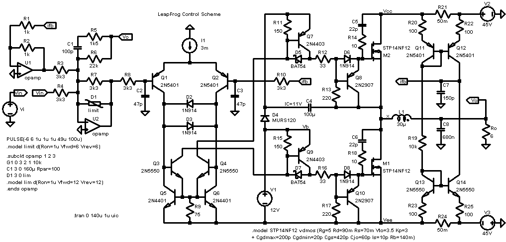

Just to get things started, here is the schematic of a UcD180 power circuit modified to implement leapfrog control (short circuit protection is an inherent, seamless side benefit of leapfrog control). I've also included a very simple, but effective mosfet dv/dt control circuit.
As near as I can tell, LF may be tuned to achieve equal performance to the normal UcD control method, or (unlike UcD) it can be tuned to damp out L-C filter ringing during transient overdrive conditions (where the UcD's feedback loop is momentarily disconnected).
More to follow....
IVX said:
In my experiments UcD show decent clipping behavior.
Why we need the effective mosfet dv/dt control circuit?
Need? That depends. Are the mosfets failing mysteriously? Does the output stage produce excessive EMI?
C5/R14 and C6/R18 limit mosfet turn-on dv/dt by stealing just enough drive current. This has little or no influence on clipping behavior.
Regards -- analog(spiceman)

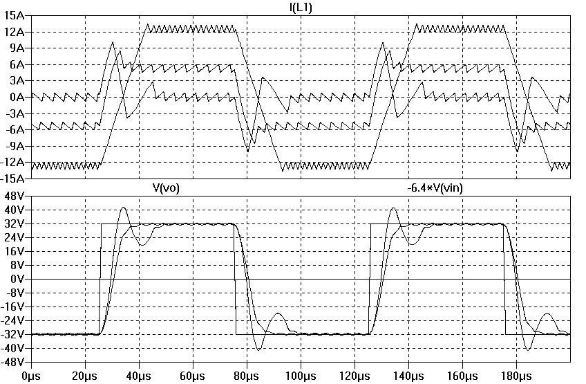

thank you very much for your effort. I am eagerly awaiting continuation. Would you care to show and comment results (not immediately but sometime along your analysis) to what I think is the most acid test for classD: square wave output of unloaded amplifier. I think that LF must excell in that region too.
Best regards,
Jaka Racman

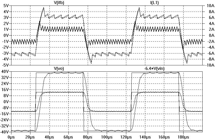

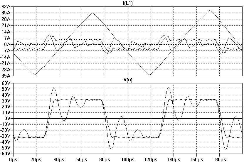

analogspiceman said:
Here is a simulation of the LeapFrog controlled UcD power circuit for a 10kHz square wave into an open circuit, a 6 ohm load, and a short circuit. Inductor current is shown in the upper trace.
For comparison, here is a simulation of the unmodified UcD power circuit for a 10kHz square wave into an open circuit, a 6 ohm load, and a short circuit. Inductor current is shown in the upper trace.
Please note that this result is only based on my guess at the UcD180 schematic as shown earlier in this thread.

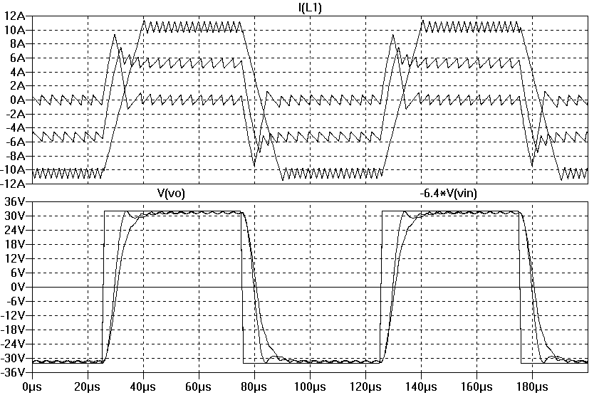

Jaka Racman said:
Hi, thank you very much for your effort. I am eagerly awaiting continuation. Would you care to show and comment results (not immediately but sometime along your analysis) to what I think is the most acid test for classD: square wave output of unloaded amplifier. I think that LF must excel in that region too.
Best regards,
Jaka Racman
Okay, Jaka, just for you, in order to maximize the cleanliness of the no load response, I've turned down the voltage loop gain a notch or so (I also cut back on the limit level for current a tad, too).
Jaka Racman said:
you simulate faster than I type.
Thanks,
Jaka Racman
Not really. I'm only using an old 266MHz pentium II (I like it because the kids don't want to use it). :)
