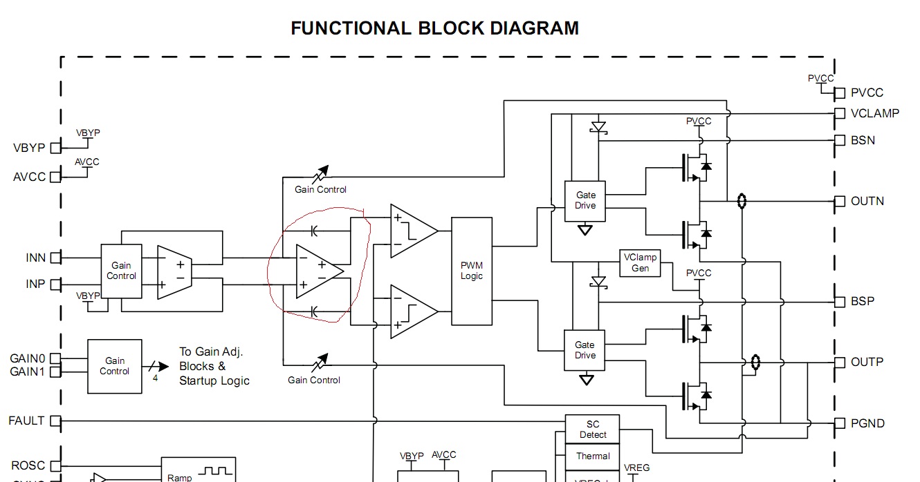

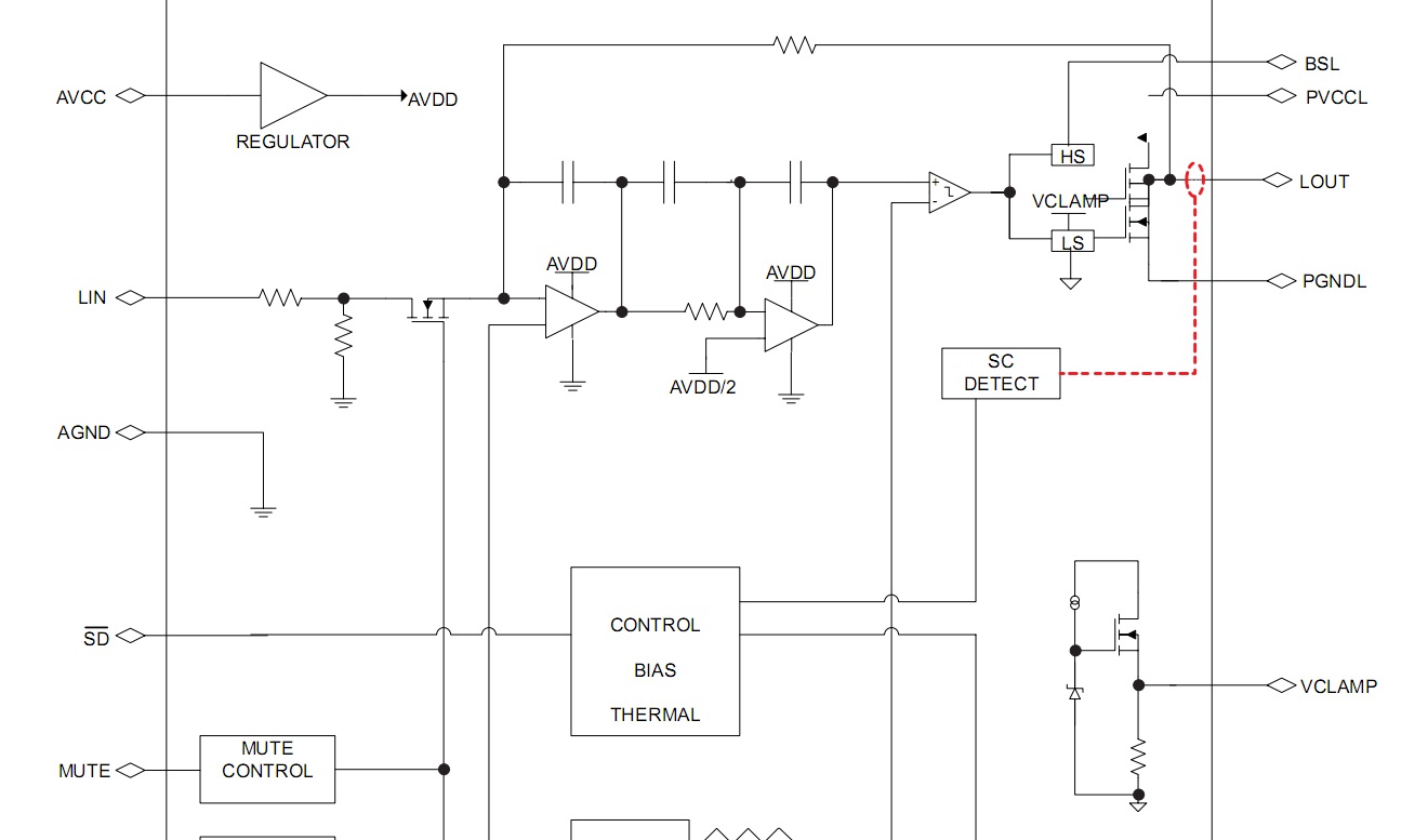

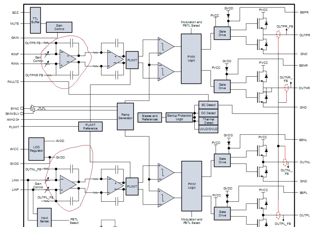

tpa311x, mono tpa3106, etc.
they all have a differential built in for btl setup and can work with SE connections;
others: TAS 56xx family or tpa3122, tpa3123 they need an extern SE to diff for btl setup

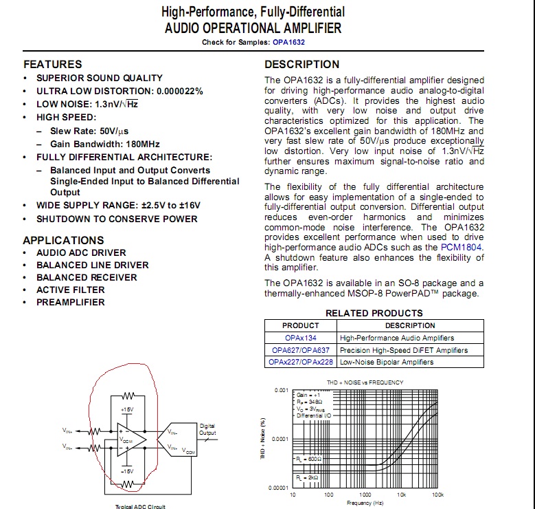

you can use opa1632 or if that is too expensive; you can build that with 2 normal OP-amp for one channel (4 for stereo) .(if you intend to power them with single supply you need to be more carefully with designing that)

if you look carefully on block diagram you can spot a fully diff amplifier like opa1632 (i'm guessing is the same but built in)

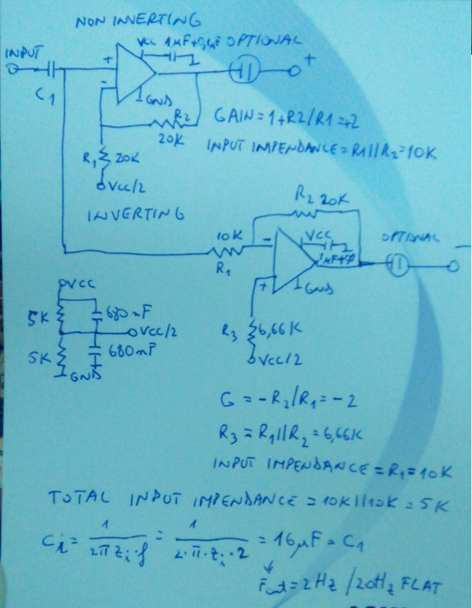

if you need an alternative to opa1632 for tpa and tas family you can use my circuit (2 opamps with single supply);the exit capacitor is optional because you already have input caps on tas or tpa;
you find 2 identical opamps in 8 pin capsule(VERY cheap) and can use one chip for channel.
the only downside for my circuit in contrast to opa1632 is that at full input signal the background noise will rise a little for some soundcards.
Also on start-up (tas or tpa) you will have some pop up bum ; opa1632 is far better at this 🙂

Your calculation of the +in resistor in the inverting case ignores the impedance (at DC) of your virtual ground (2.5k). It also looks to have rather a too high AC impedance leading to crosstalk between the two opamp elements, particularly at LF.
we have interest only in ac impedance for calculating the input capacitor; the virtual ground will not affect the frequency response;yes we have a high ac impedance because i made this to be cheap with low parts count in response to opa1632 implementation of ti in tas56xx boards where they have a 5k input impendance; of course you can lower the gain resistors to small value for a lower impedance.
