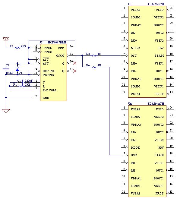

TDA892x Sync
The easiest way to synchronize the carrier switching frequency for multiple ic's used within a system is to use HEF4047 Multivibrator as clock generator. then, it's output can feed several ic's. few notes: the maximum number of the TDA892x ic's which can be feed from an unbuffered generator should not exceed 6 pcs. for more, a simple buffer must be used, or multiple buffers each driving few ic's.
to force the external sync. the actual resistor from osc pin to negative supply !!! must be removed, and a 1K resistor from the multivibrator output to each osc input pin of TDA892x must be used. this will bias the osc pin above 0V and provide sync.
as a side note, in most of the cases, the noise have other causes than the lack of sync, mostly the GND loop which is formed between power supply gnd of each module and Input GND. since the signal source is only one, there should be only one GND connected for all the inputs, and since all of them use a single power supply, the power supply GND will be the other end of the GND loop. an alternative solution is to use balanced input, which the ic already has instead of unbalanced inputs. when using unbalanced, one input (inverted or non-inverted) is fed with input signal and the other one is connected to GND, that's where the the loop can be avoided, by feeding with balanced signal, there will be no looped GND reference for the other input.
TDA89x0SMPS info
